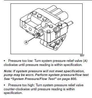

Show a pic of your loader valve.
If you can find the IN port of the loader valve , it will be close to it.
Look for hex nut on top of valve.
   / 3520 losing curl pressure on FEL #12
What is the relief valve?
Kinda hard to get to without taking some stuff loose, but if you try hard you can get to the adjustment from the top by just taking a few bolts loose so you can shift some of the plastics. You need to have a gauge to do it right.
And as always, I recommend buying the technical manual. One of the best reads ever.
