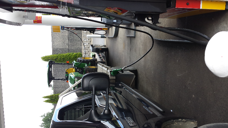

I figured the same weight with my 3520 with a woods backhoe. I hate pushing the axle/tire limits so my 18' 14k trailer has plenty of reserve capacity to do the job. The trailer is 3000 lbs empty.
