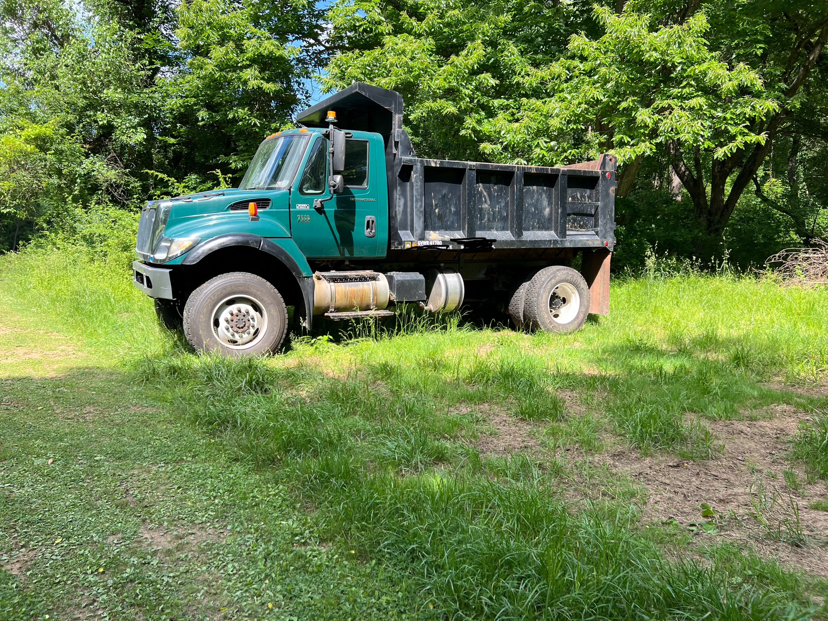

I like my single axle 4x4 dump truck, but I fully admit a dump trailer is an excellent choice. Cost-wise, Trailers are a joke to buy/own/insure/license/repair compared to owning a dump truck.
But I like having a dump truck. With each passing year, trailers are less enjoyable to hook/unhook. I can’t wait to get a hay truck and park the hay trailer
Nice dump truck! I though about going that route, but decided against it for all the reasons you listed. I miss driving a "big rig" since I sold my motor home with a 450 Cummins.

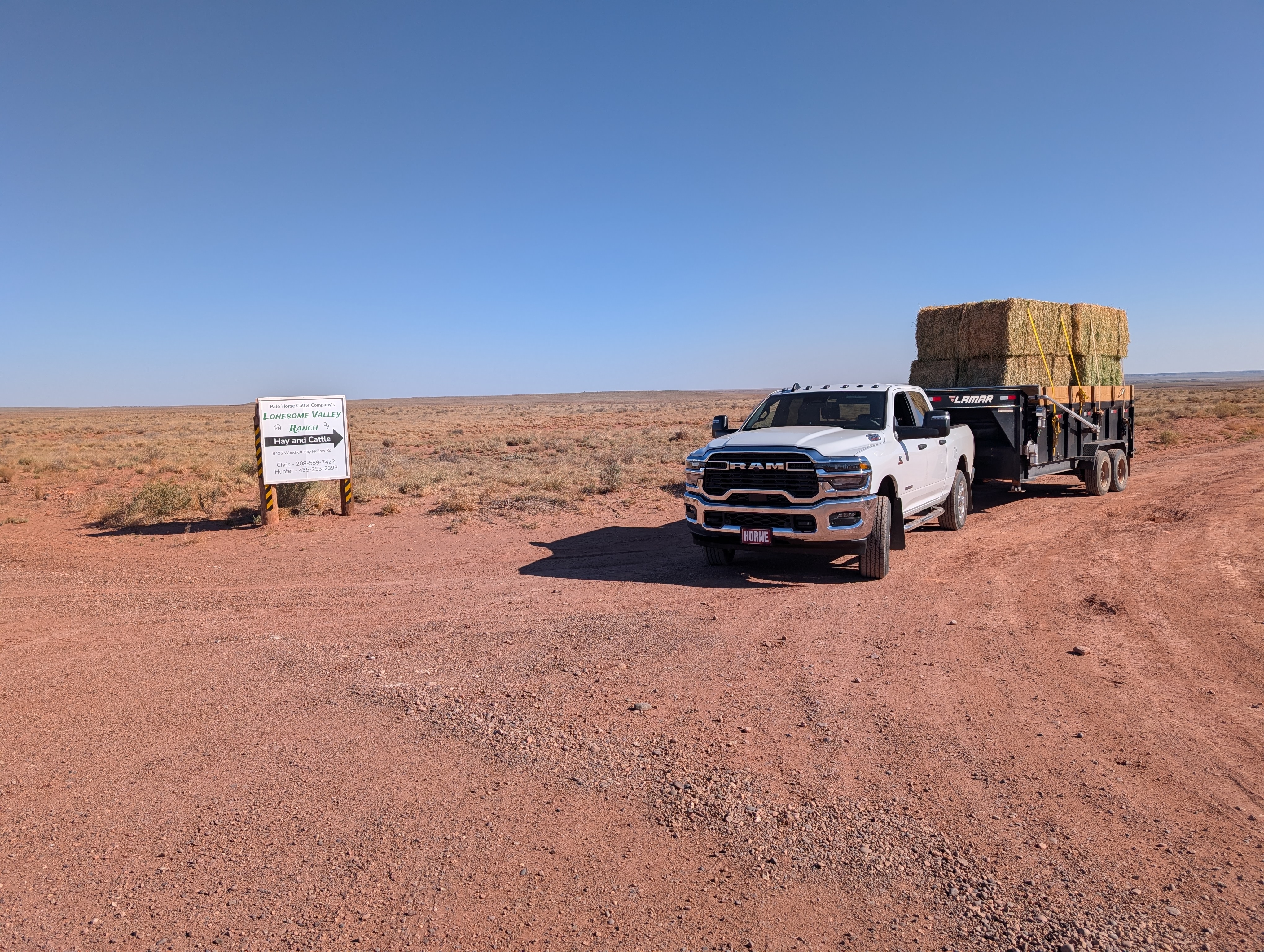

You will not regret buying a dump trailer, they go hand in hand with a tractor/loader. I use mine more than any other trailer. They even work well for hauling large hay bales, that the customer can't unload, just dump them out. Pictures of your trailer??
(12) 3x3x8, 27,460 GCW or 1025 per bale.

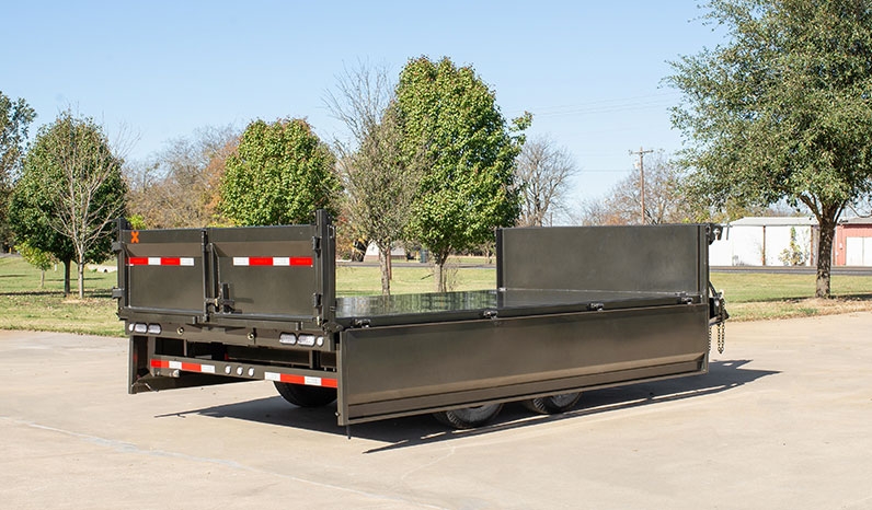

I've looked and thought about dump trailers and came to the conclusion the one I'd want is the deckover with the fold down sides so it could be loaded from the side with materials on pallets or anything using forks.

I can load and unload 2 pallets in my regular dump trailer. I could probably push 3 in but I couldn’t unload it without dragging it with a chain. It’s rare that I would want to haul more than 2 pallets at once because I have the big loads delivered and just have to pickup material if I run short. It’s also not much trouble to load a bundle of lumber in a regular dump trailer. You just set half the bundle on the end of the trailer and then reposition the lift and push it the rest of the way in. That’s the same way I load logs if I’m loading them with a skid steer instead of my excavator. I’m not in love with folding sides because they tend to be janky plus they limit you to short sides.

LouNY, That's a nice trailer and idea for sure!! - but how many loads of heavier stuff until the sides get tweaked enough so that the easy/quick load/unload feature disappears? I'm sure that will happen. The tailgate on my 1 ton dump bed has tweaked enough that it's no longer "easy" to open/close. It still functions but.....and just how heavy are those sides to swing back up after you drop them down? Looks like an ordeal in itself!
That's a serious setup, nice! 12 bales is a lot to haul at once in a 16ft trailer.

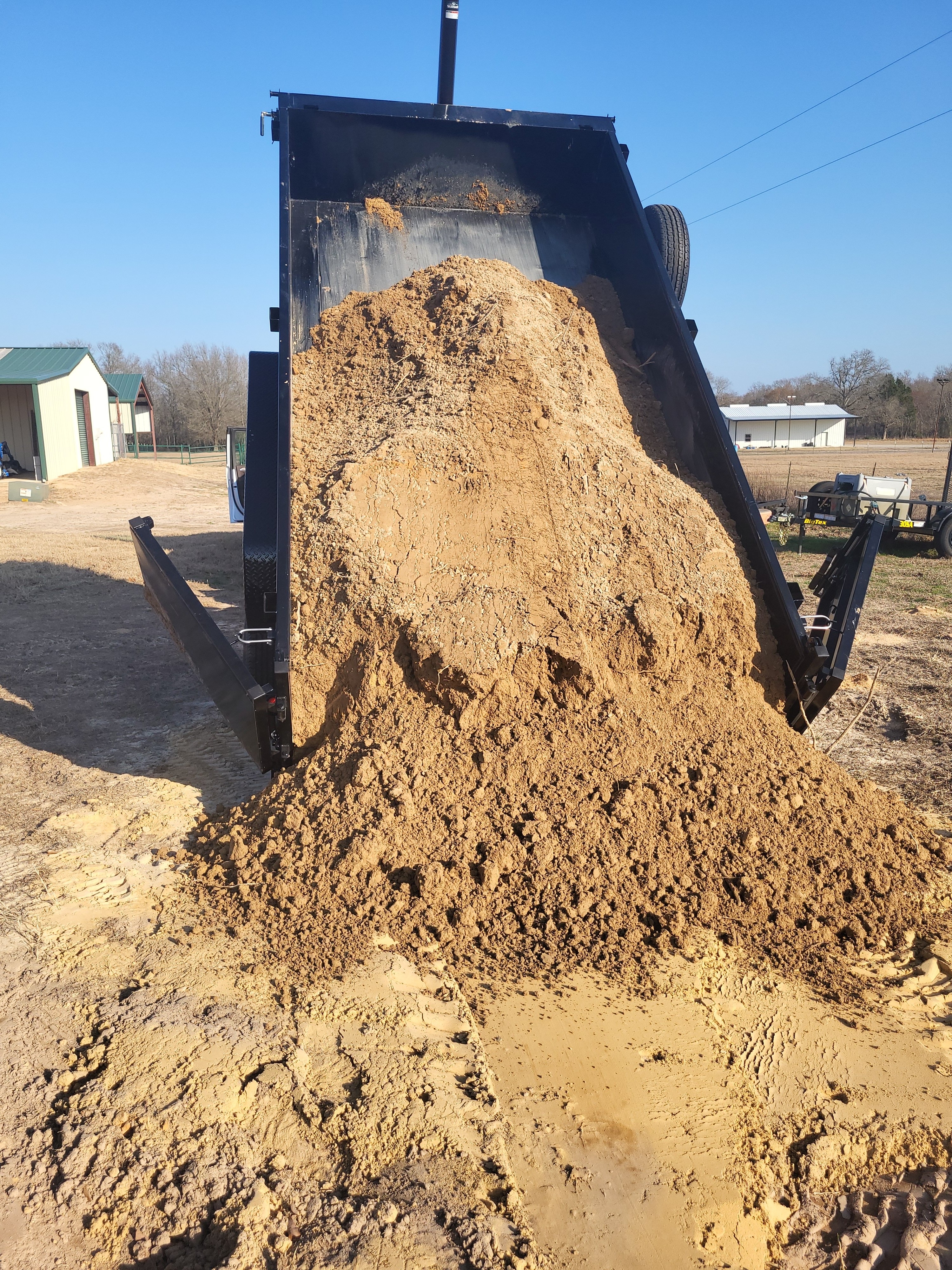

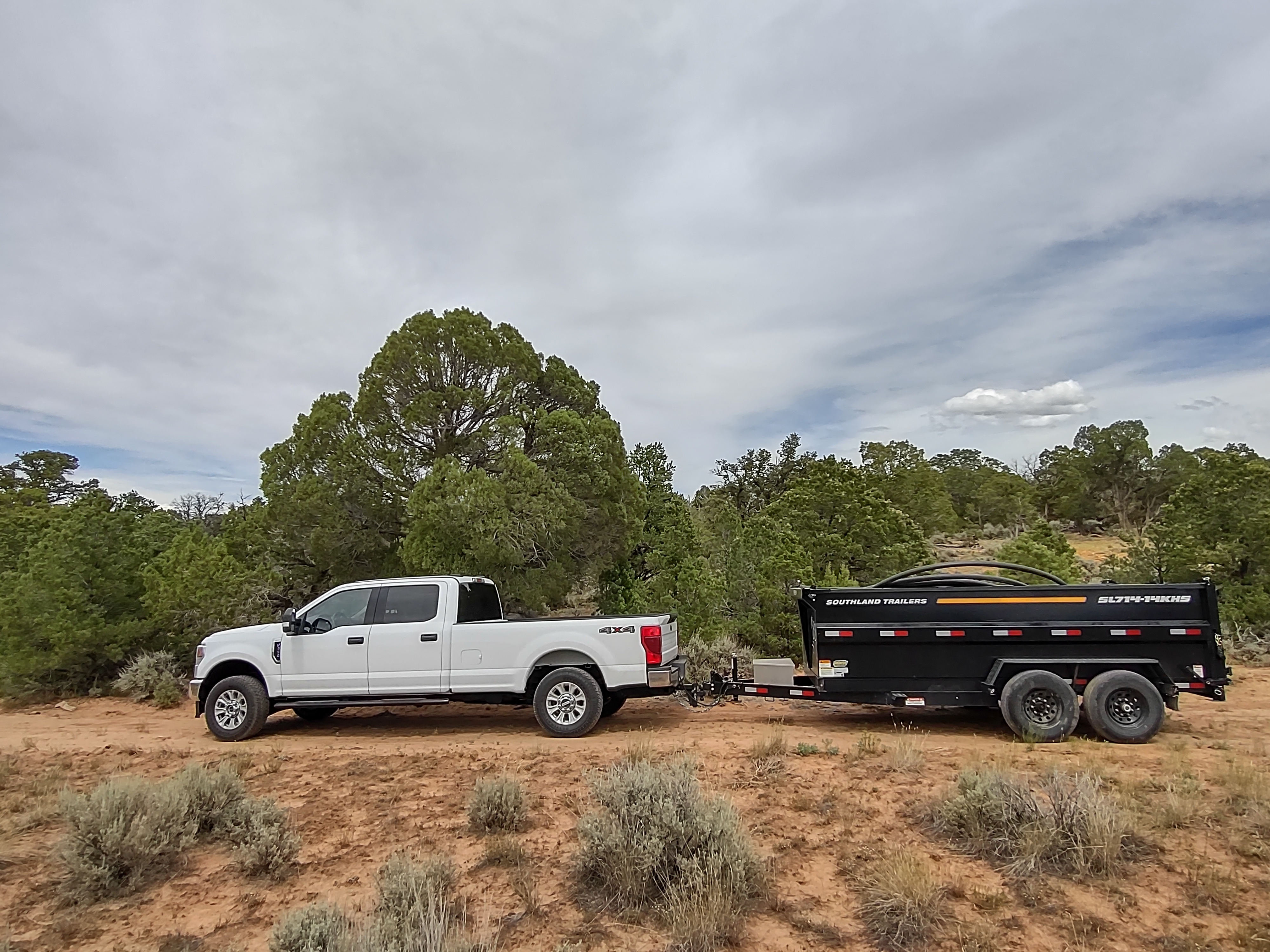

Here's a pic of the new truck and trailer. It's already getting put to good use moving stuff around the ranch.
