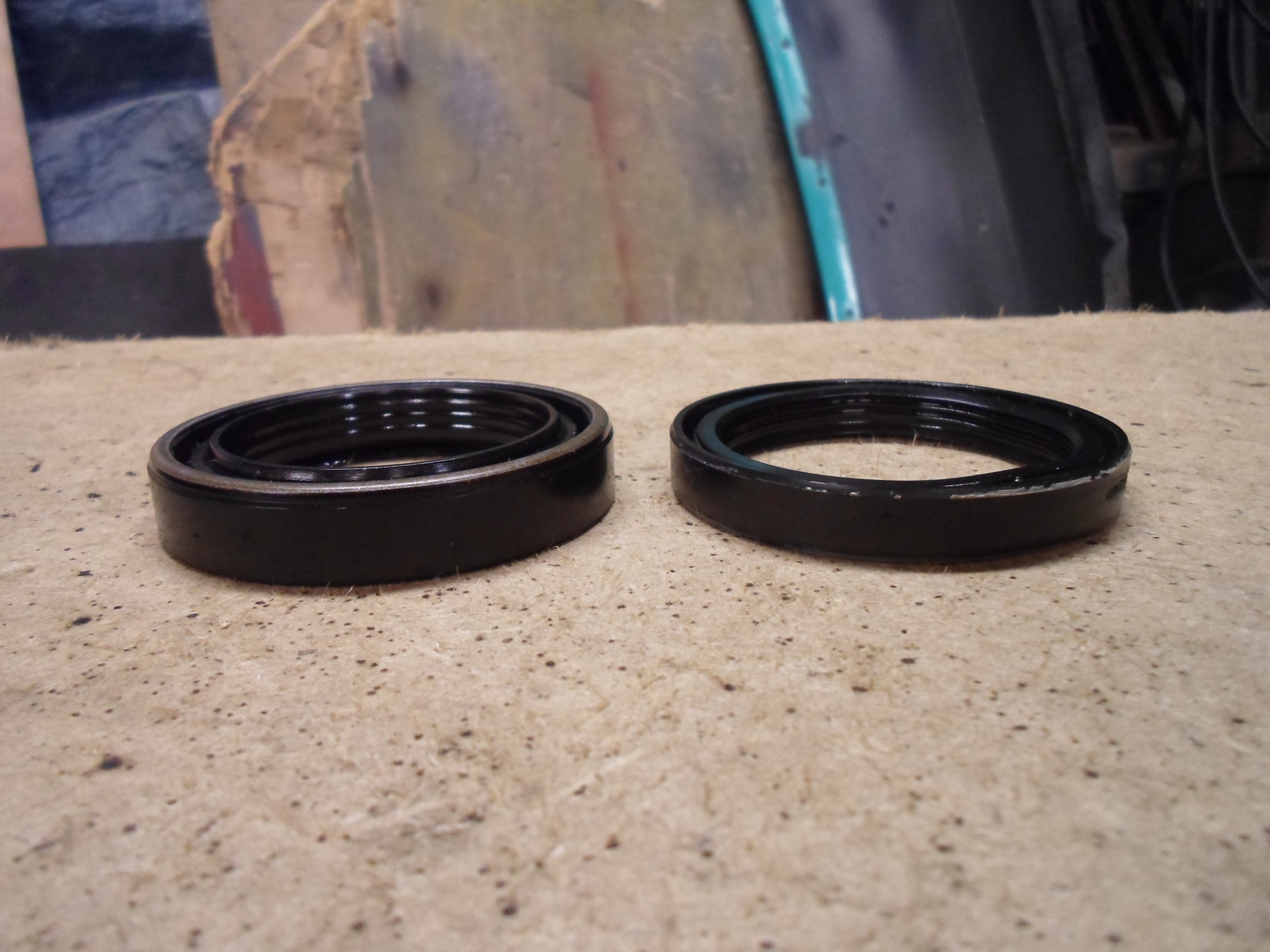

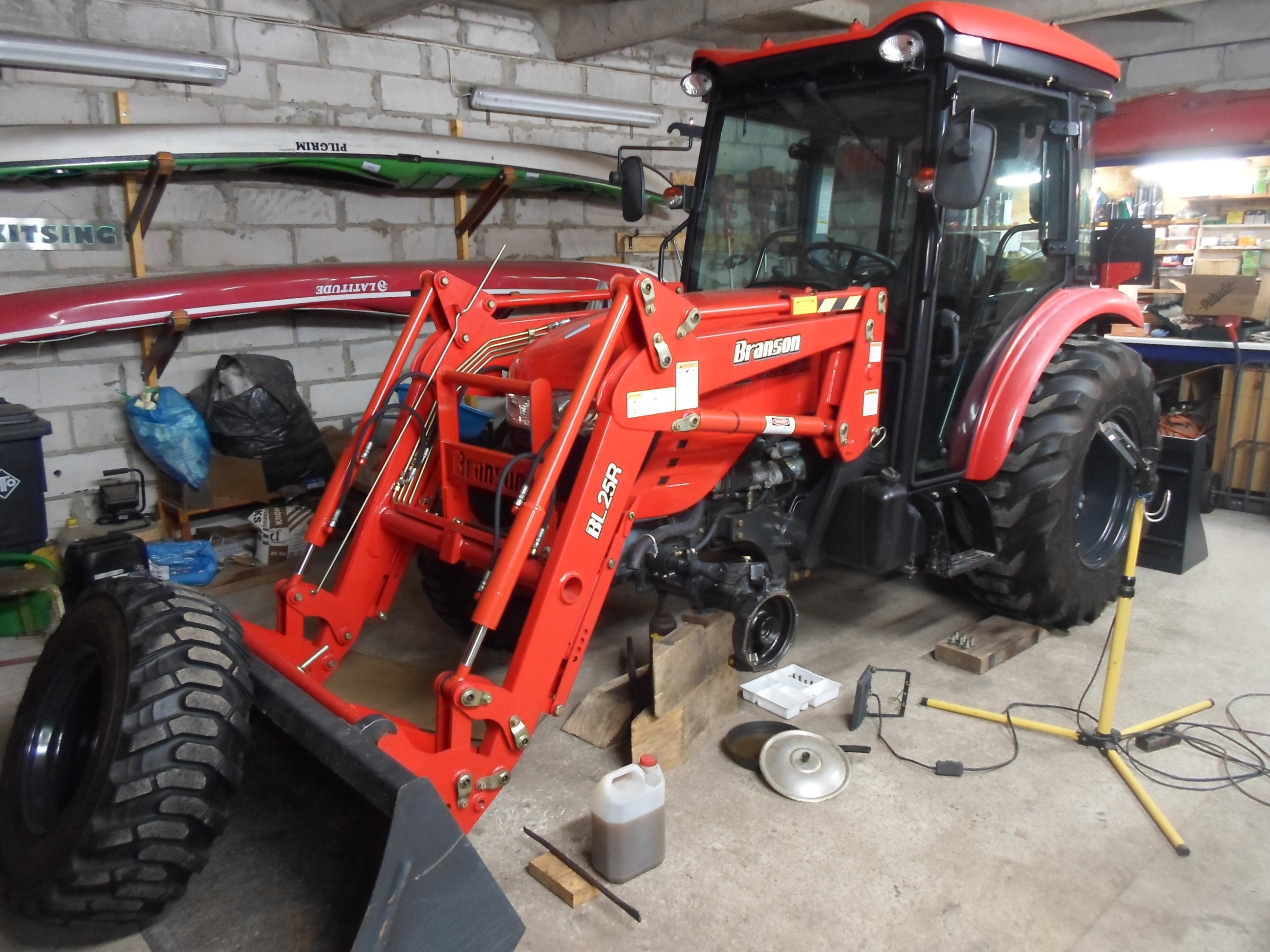

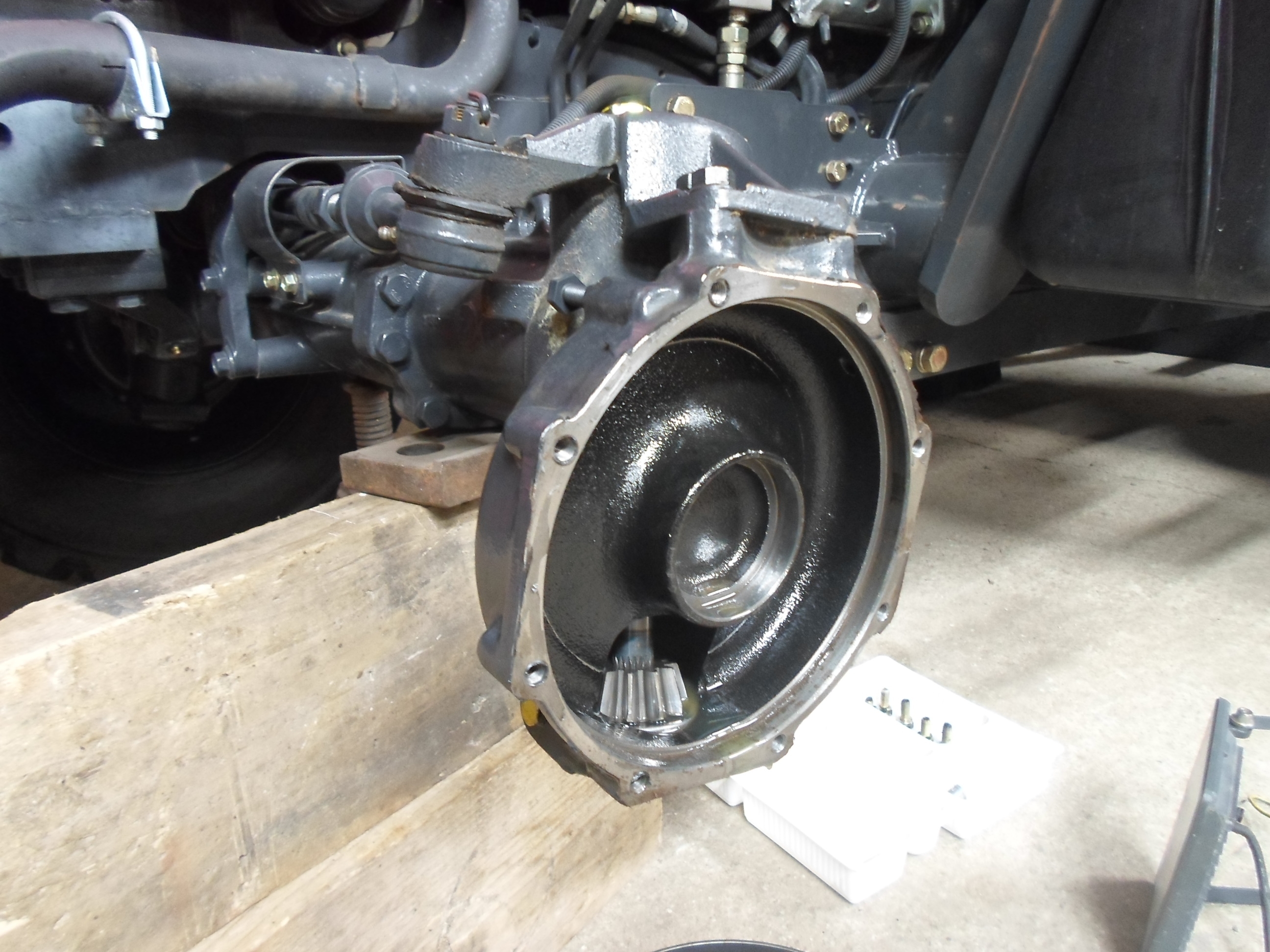

Some months are gone by... but we got the seal replacement done before christmas.
It was quite an easy operation, althought I didnt do it myself.

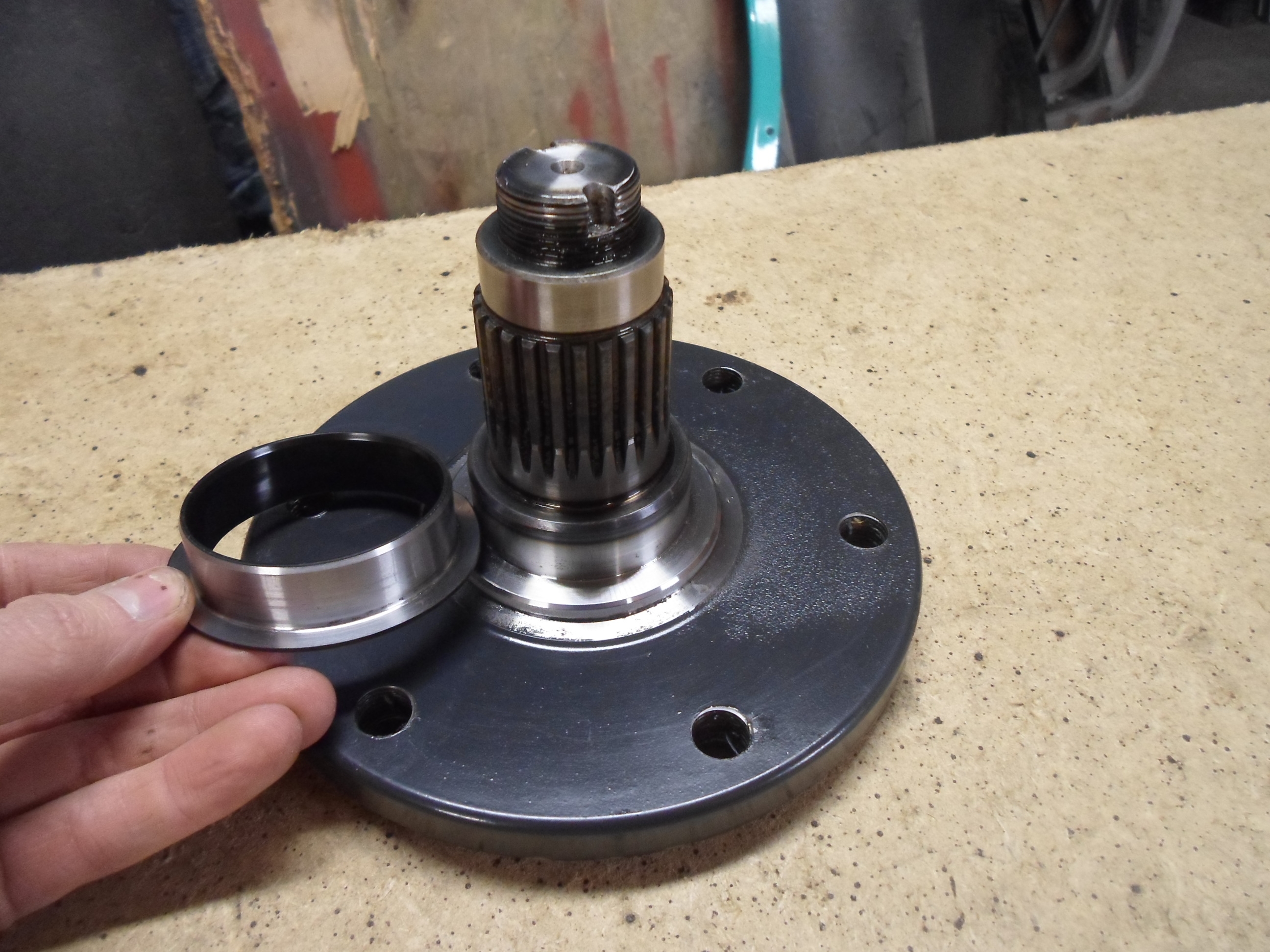

The only ??? moment was when we got the hub disassembled and found that new seals dont fit on the shaft. New seal, in factory package, correct part nr was way smaller on inner diameter and also much thicker-beefier than the old one.
Several options were on the table and I almost took the hubs to machinist to take down some material from the shaft but just then my friend who did the repair, discovered there was a thin sleeve on the shaft on witch the old seal was placed.
We got it off the shaft and then new seal went perfectly on.
The sleeve was rubber coated from inside, factory piece. The machinist said he has seen some solutions like this before. Most probably its made replaceable cause the seal may wear some grooves on shaft and it may start leaking. With a thin sleeve, you can replace both seal and the sleeve and the shaft preserves its surface.
Somewhy they dont use this solution anymore and also the dealer didnt mention a thing about it?
Anyway, the new thicker and stronger seal went on and I also replaced the bearings. Some china stuff was in there before, now I put German premium brand FAG. Luckily these are very common bearings, 2+2 cost only 45 $.
2 big O rings and a silicone as it was before and together it went.
No leakes so far but we have winter time with snow and cold weather, we`ll see in summertime when the oil is thinner and tractor gets some workload.

Jep, new seal may wear some groove into shaft surface but my machinist said there is enough room and material to machine future damaged area down, make a new sleeve, hot-mount it on the shaft and machine it into correct size. And it can be done over-and over again if needed.
But I doubt that I can wear this groove in... and I have much more confidence in new, improved design seal. We`ll see
