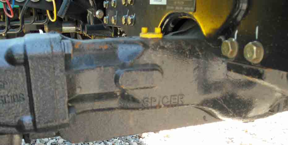

My 4210 has about 800 hrs, and had to replace the right front last year. I pulled it apart and had to take it to the dealer as I couldnt get the gears apart to get to the seal. You may run into the same problem.
Yeah, the kingpin requires a special tool to take apart. I documented my
replacement of both seals, starting at post #120 of my 4300 rebuild thread.
The hub seal was easy; the kingpin seal was tough.
There are numerous iterations of the front axle, starting with the 4x00s, and
on to the present 3x20s. All seem to be made by Spicer....this photo is
from a 3120. The casting looks very similar to the one on my 4300.
