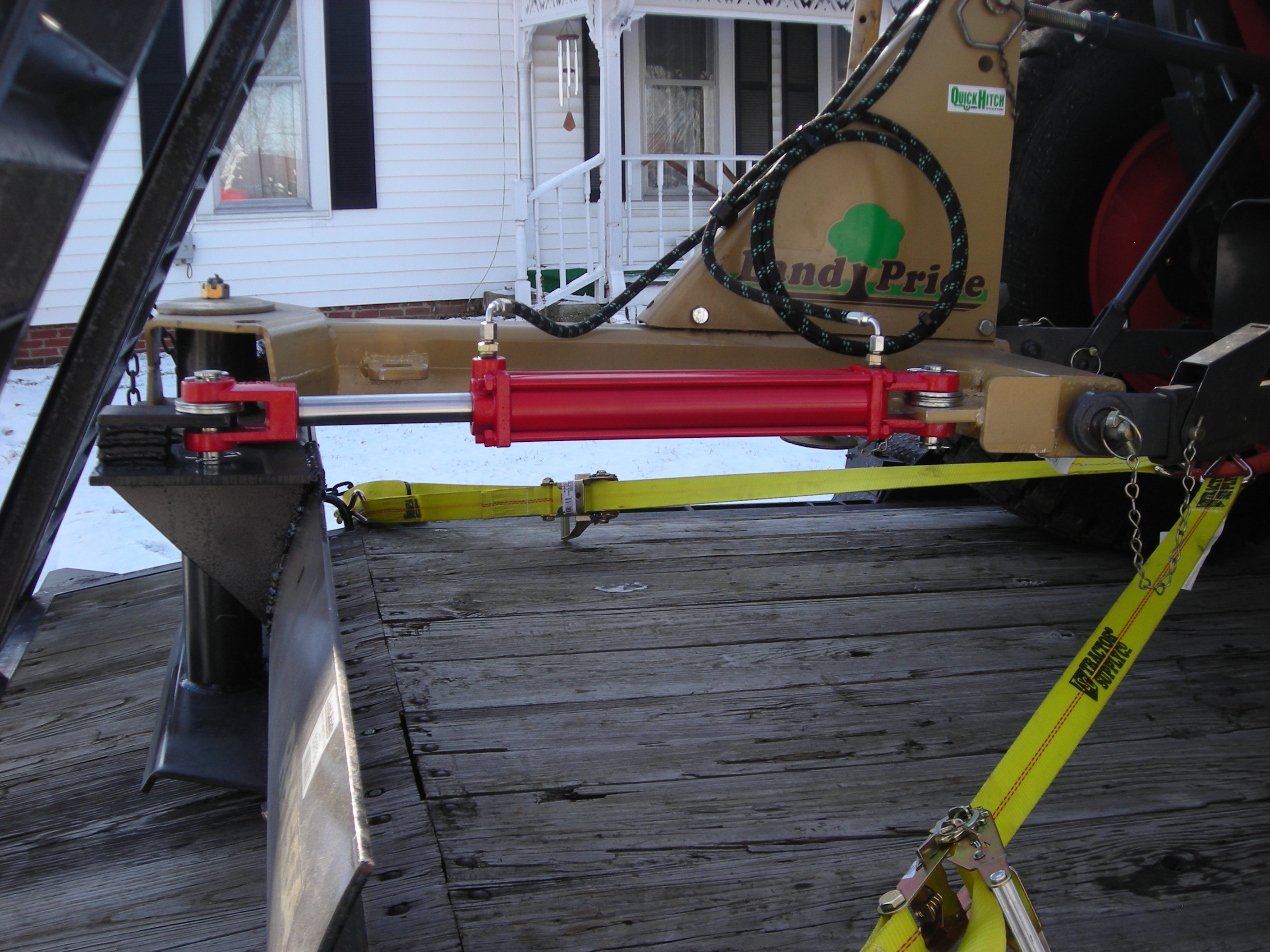

For rear blade I like this Land Pride model. Note the hydraulic angle I put on it, that is the reason of the 2nd remote. Anything bigger than a 6' bushog will be heavy, hard to transport on a trailer, and for my needs, take too much hp. Get a good and heavy box blade, with hydraulic rippers if you can swing it. Philip.

We should have had at least one set of hydraulic hookups put on the rear,
they're coming to pick ours up soon to install them.
