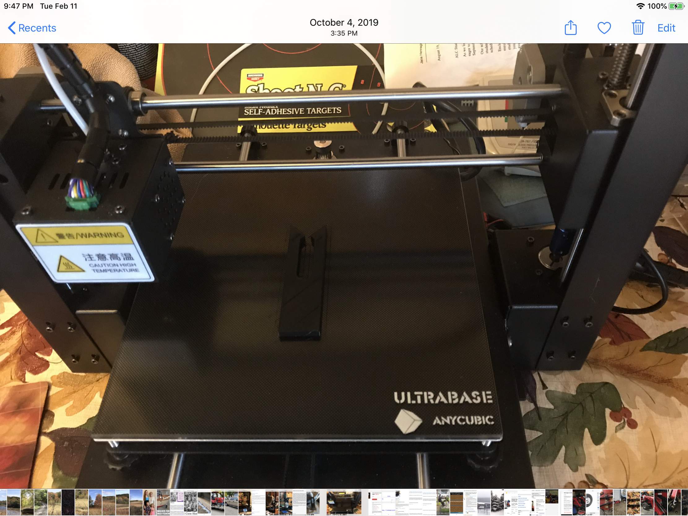

Which printer is that?
Anycubic I3 Mega which is now the Anycubic Mega-S, they upgraded the I3 Mega to Mega-S.
