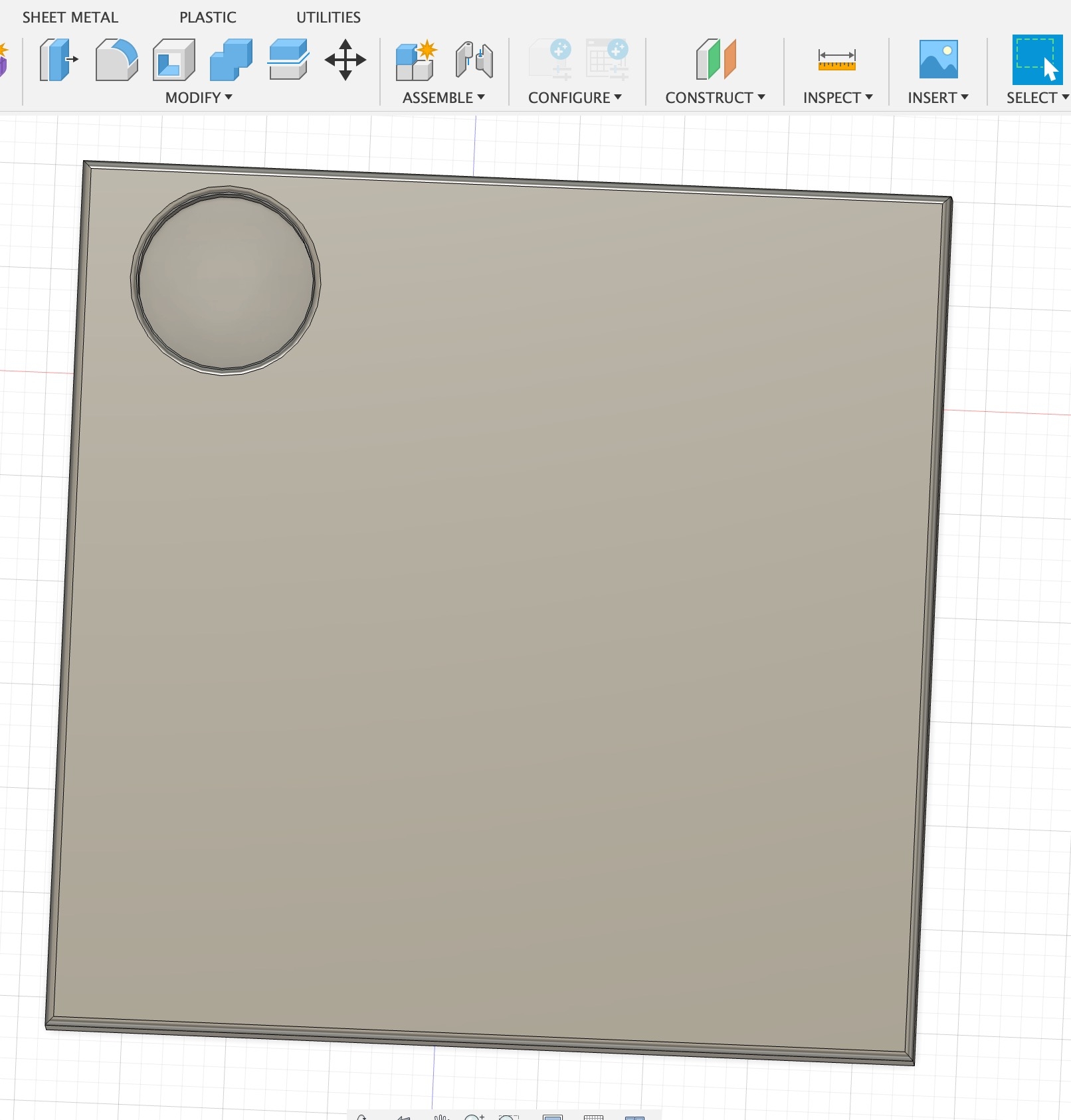

I was going to 3d print a die holder for the garage but am sort of stumped on how to get holes in a plate that are even. What I am trying to do is make a flat piece of plastic where they sit.
I designed it so it holds 16 total dies, 4 across, 4 down. I can get the first hole (44mm wide at the top, with a 2mm counter sunk edge making the hole 42mm wide by 9mm deep) in the base plate which is 208mmx208mmx14mm thick. My problem is getting the next 15 placed so they are nice and even. I have tried "Aline", tried patterns, and even single holes and cant get it to work right. I even went to TinkerCad and played around and could get it lined up better but the holes are not really perfect circles for some reason so I figure I am far better off in Fusion 360.
Can anyone give me some pointers or explain (like you are talking to a 6-year-old, that is trying to learn Fusion 360) how to do this? I have watched a few videos but nothing seems to work like it is being explained. Sometimes I don't even have the same screen prompts/options that they are mentioning.
I have a STL file, and an F3D file but I cant seem to post them here.
Also if I ever get this correct - anyone that wants the file is welcome to it. It will hold punches for a CH-70 hydraulic punch press.

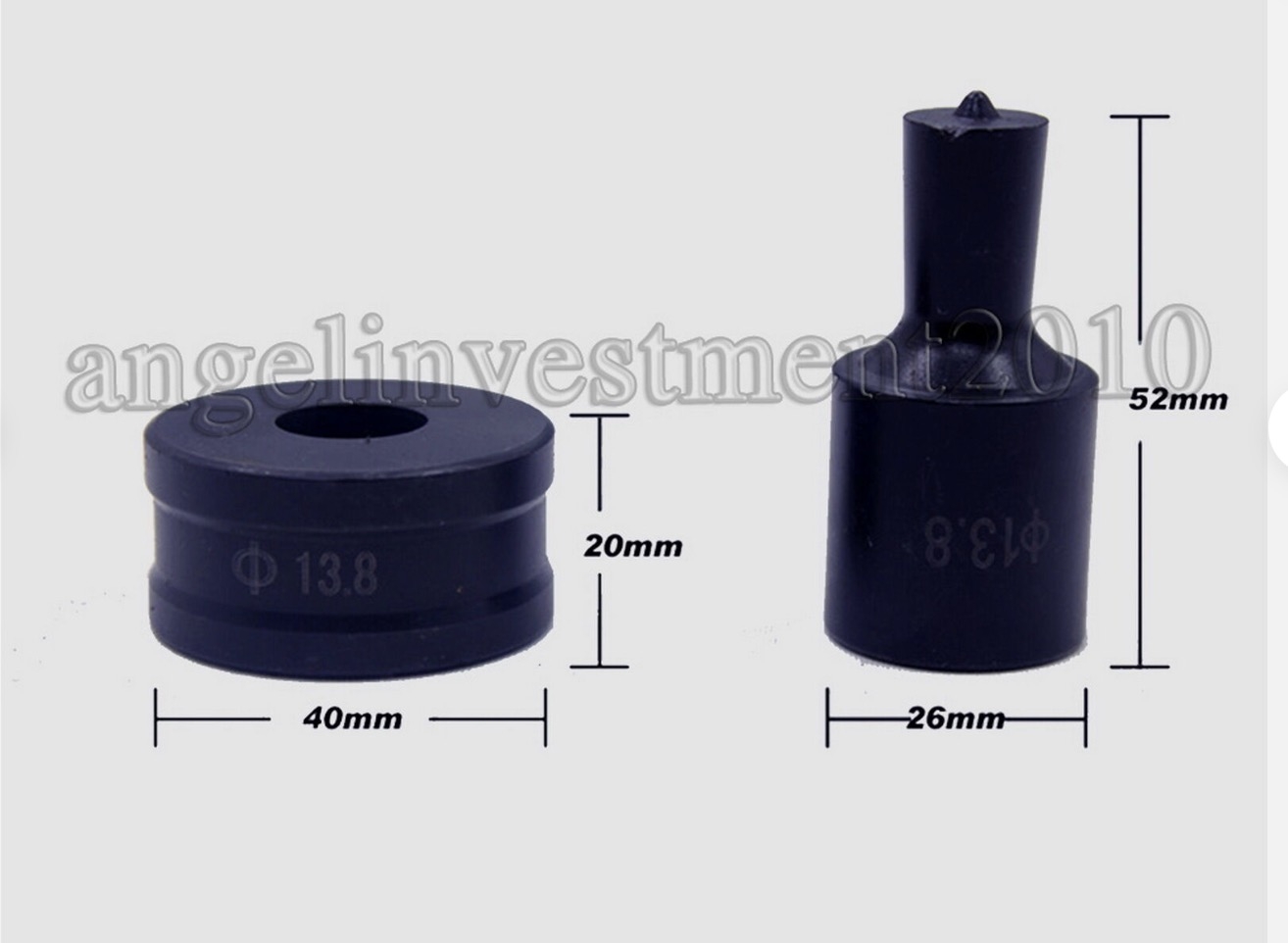

Here are the punch(s) I want a tray for and here is basically what my design looks like

In both Solidworks and FreeCAD, there is a repeat at intervals function. You select your "feature" which is your extruded cut (hole) off of your top face, then apply the tool which will allow you to specify how many repetitions, which and how many directions, distance between repetitions, etc. I have not used Fusion360 but all of the parametric 3D CAD programs have the same basic toolbox and this is a common tool.
If you don't want to use the repeated feature tool, you can create a sketch on the top face, then place and dimension x and y lines "for construction", then use the intersections of those lines for the centers of your holes. More time consuming but maybe more intuitive

Similar to the comment above, I use construction lines and make a grid with the proper spacing then use the circle tool to make the holes at the grid intersections.

I did get it to work out by using the pattern tool and laying out a 4x4 grid based on the existing hole I cut to the correct size. I posted it on Makersworld so the next person looking for a punch/die holder can just download the thing and use it.

pattern should get you there, just offset what you need and use the second as the pattern and it should line up
