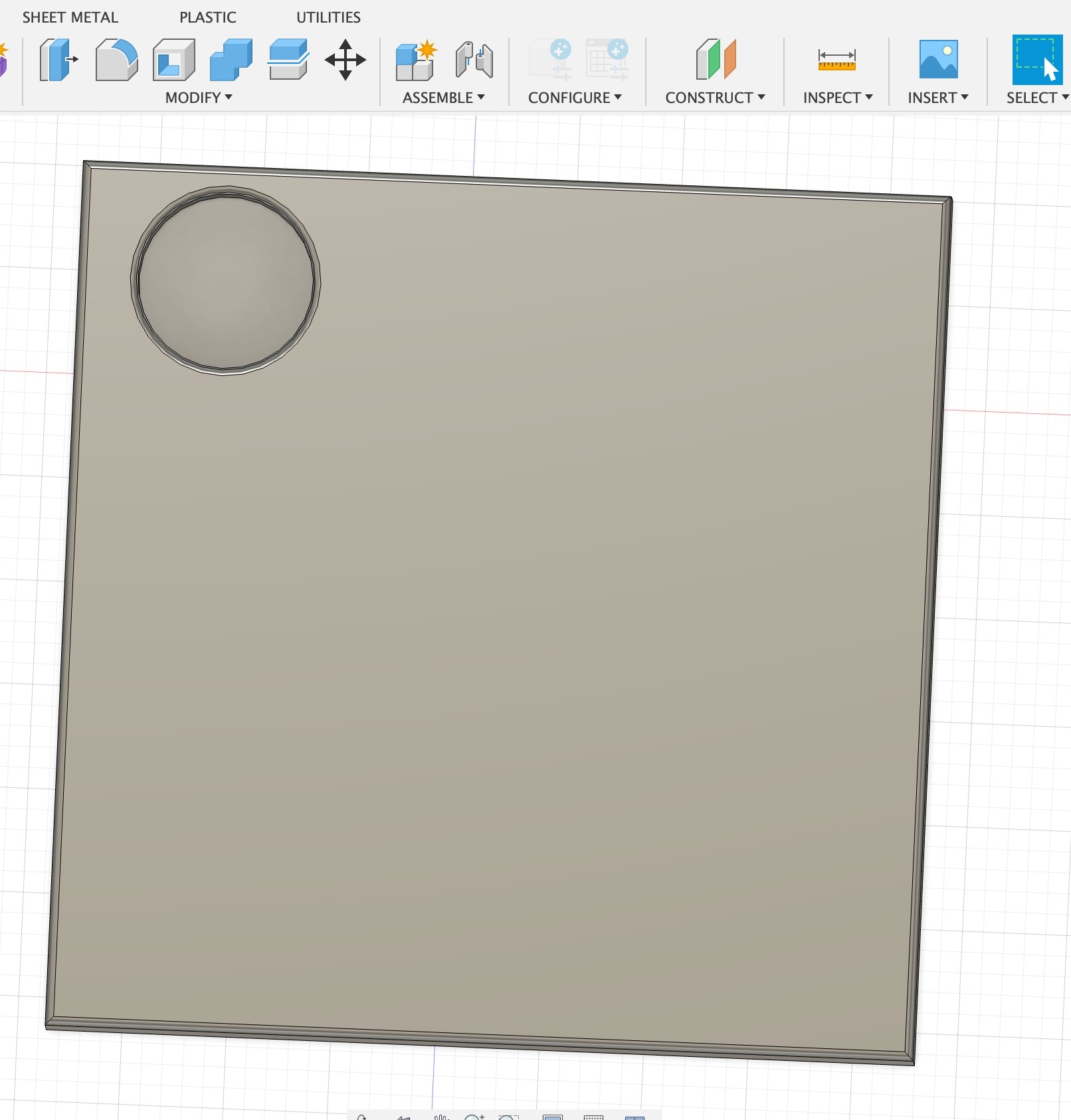

I was going to 3d print a die holder for the garage but am sort of stumped on how to get holes in a plate that are even. What I am trying to do is make a flat piece of plastic where they sit.
I designed it so it holds 16 total dies, 4 across, 4 down. I can get the first hole (44mm wide at the top, with a 2mm counter sunk edge making the hole 42mm wide by 9mm deep) in the base plate which is 208mmx208mmx14mm thick. My problem is getting the next 15 placed so they are nice and even. I have tried "Aline", tried patterns, and even single holes and cant get it to work right. I even went to TinkerCad and played around and could get it lined up better but the holes are not really perfect circles for some reason so I figure I am far better off in Fusion 360.
Can anyone give me some pointers or explain (like you are talking to a 6-year-old, that is trying to learn Fusion 360) how to do this? I have watched a few videos but nothing seems to work like it is being explained. Sometimes I don't even have the same screen prompts/options that they are mentioning.

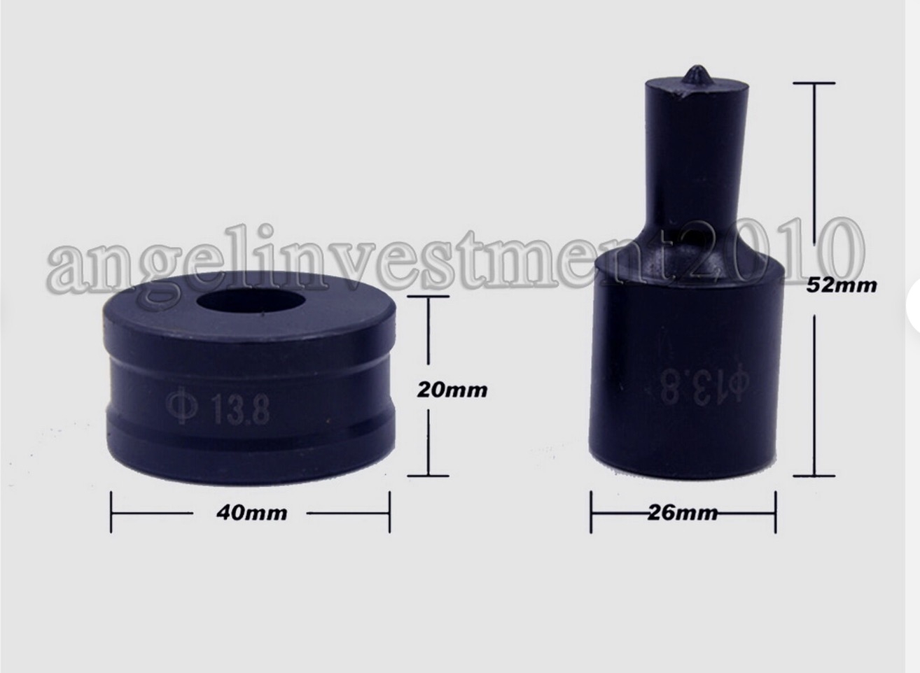

Also if I ever get this correct mobile printer- anyone that wants the file is welcome to it. It will hold punches for a CH-70 hydraulic punch press.View attachment 866746
Here are the punch(s) I want a tray for and here is basically what my design looks like
View attachment 866744View attachment 866745
To create evenly spaced holes in Fusion 360 for your die holder, use the pattern feature. Start by creating the first hole with the correct dimensions and countersink. Then, use the rectangular pattern tool to replicate this hole across the base plate. Adjust the spacing and number of instances as needed to ensure even placement. Repeat the process for additional rows if necessary. This method allows for precise and uniform hole placement in your design.

Thank you - I think that is basically where I ended up but it was not a smooth road.
I will save your response for later reference as I am sure I will be doing something similar in the future and may not remember the exact steps.
