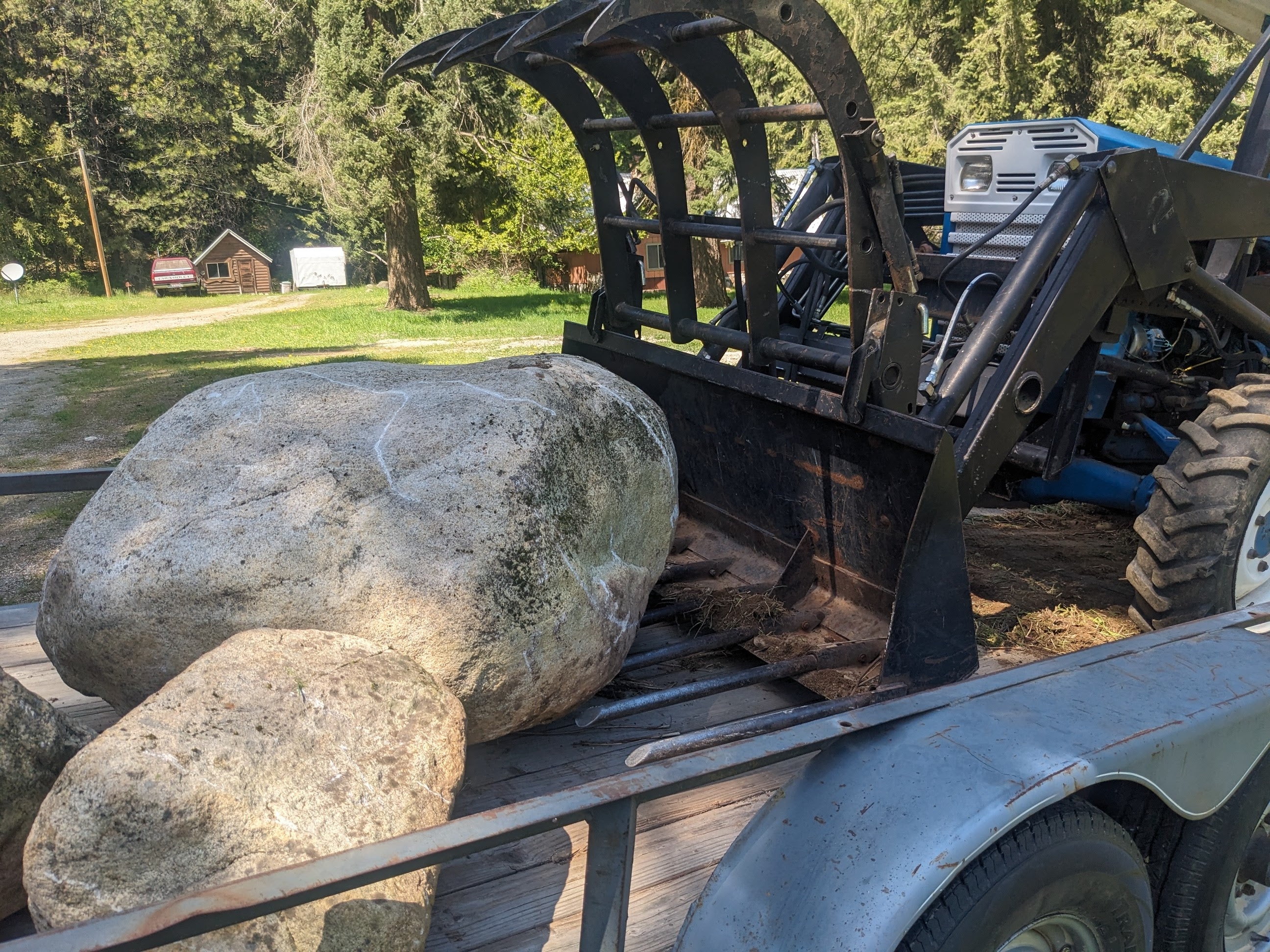

Would that work, or am I just going to damage the grapple sooner or later? It would be used for logs, rocks and brush so probably nothing to heavy (famous last words!).
I'm looking at one of these two units.
Depends on the rocks and log sizes. I have pushed my grapple hard at times. Rocks can be heavier than they look.
Could not even lift this one but was able to load it on the trailer with the grapple.
Long logs can be hard on mounts and cylinders if the tractor hits a dip or obstacle on one side.
Neither of those grapples posted are going to be able to grab and carry much brush without dropping smaller stuff through the bottom imo. I just hauled a huge load of brush out of our Dog yard today and was amazed just how much my L style will actually carry and pick up without loosing any. A large opening Grapple helps in that area. The pic shows it opened fully which is a hair over 49 inches that will help with other jobs as well
The first one you posted will be good for logs.
Depends on what you will be doing the most of with it.
L styles are more adaptable to multi use but do a poor job grubbing. Clam shells are better at ground engaging but aren't great for use as a carrier. Again jmo,
