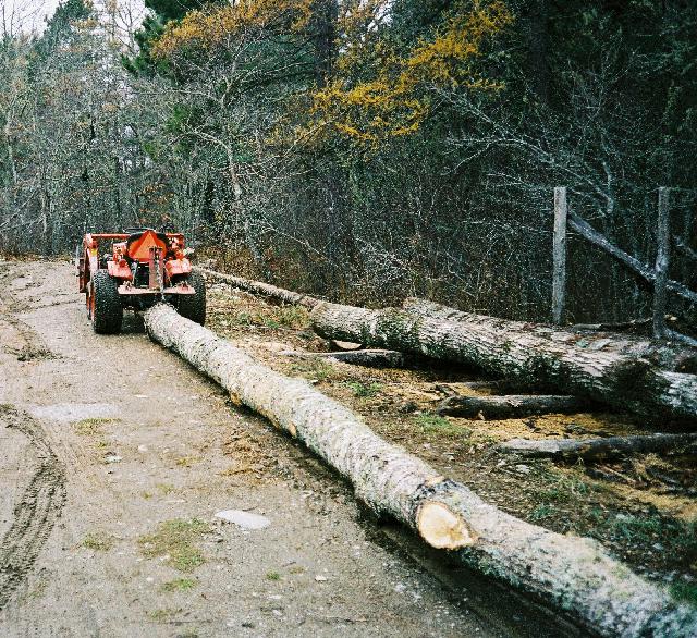

Pat, what you see on my tractor would spends most of it's time doing just what you wish to do.:D :D
   / 3PH log skidding implement #18
Egon,
No disrespect and I am not trying to be the safety police or anything but the way you are pulling that log is very dangerous !
You should always hook up as low as possible and also pick the butt end of the log higher off the ground.
If you were to snag the log on a stump or even the ground you could be flipped over backwards before you could react.
A far safer way would be to use a boom pole or similar and chain the log as close to the back of the tractor as possible.
You could also use the drawbar and chain but just make sure that the end of the log is high enough not to snag on something.
I am sure that you have done it this way many times and never had any trouble but I think that this is worth noting.
I actually witnessed ( as in I was right there when it happened ) a tractor flip over backwards because it had been hitched above the axle.
Not someting you want to see.....
By the way, the driver had been driving tractors for probably 50+ years .
Just my .02 worth.
Fortyseven2n
   / 3PH log skidding implement #19
Yes, I am famliiar with the concern.
Most times the hitch is used to put weight on the rear tires for traction. Many times it cannot lift the log. I always fill the bucket with rocks and travell very slowly as that is as fast as I can go. For my purposes it works well.
But rest assured your comments are valid.:D
