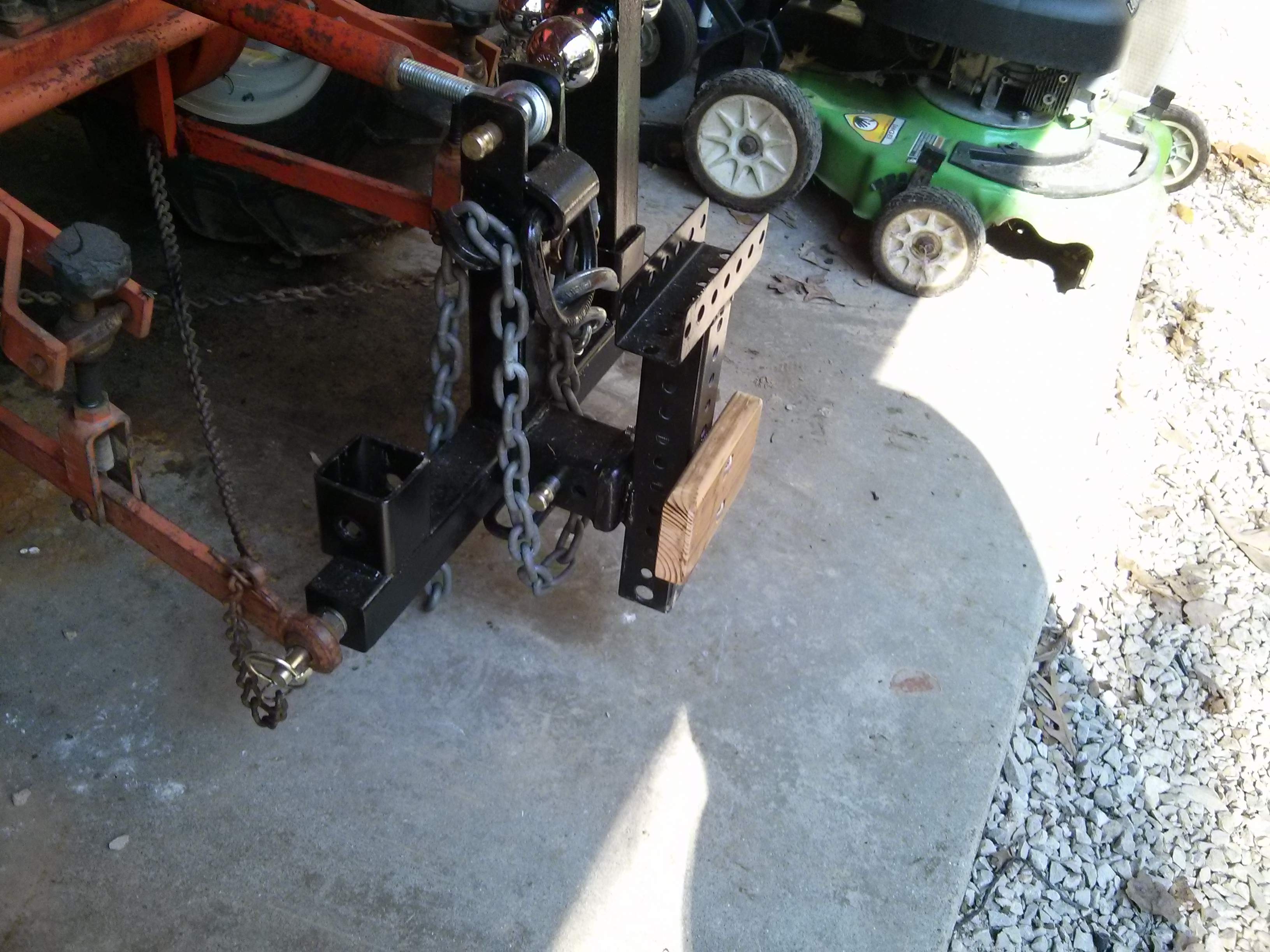

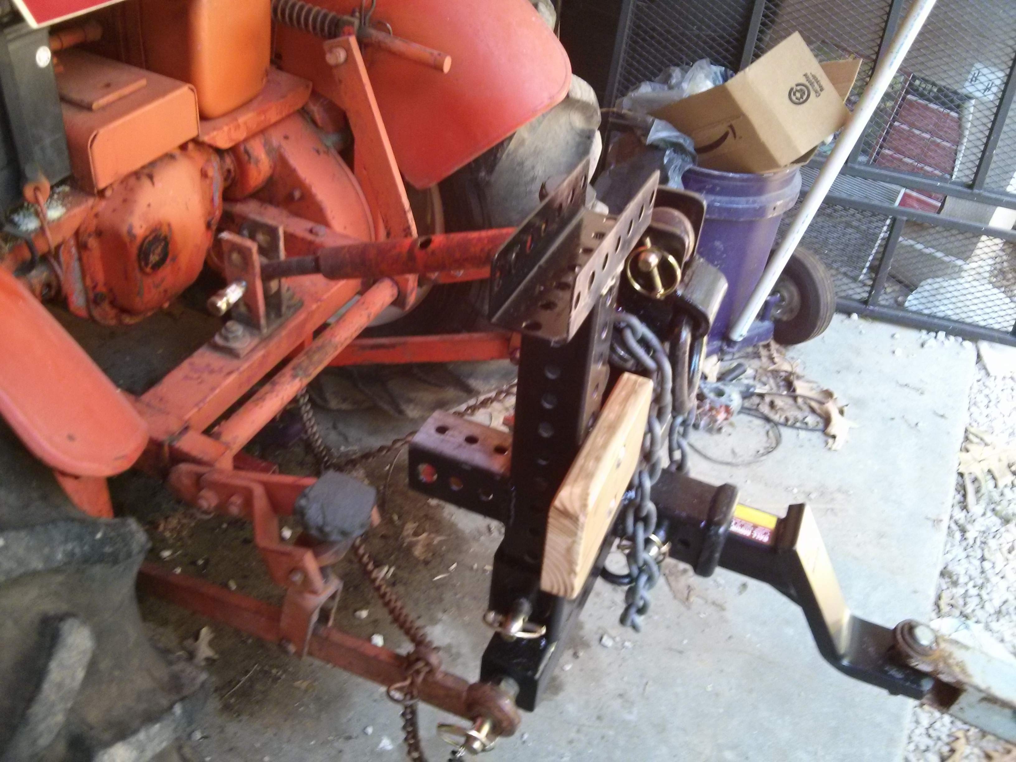

This is the one I built. Really simple. It is in the "stored" position in a couple 2" vertical reciever sections right now, but all it is is some old 2" tubing that looks like this: trash holder.JPG
In the "to use" position, I slide it into the hitch mount using the stub that is pointing towards the tractor in the stored position.
All I have to do is back up to my trash can and lift the 3ph. The extent of my laziness knows no bounds...

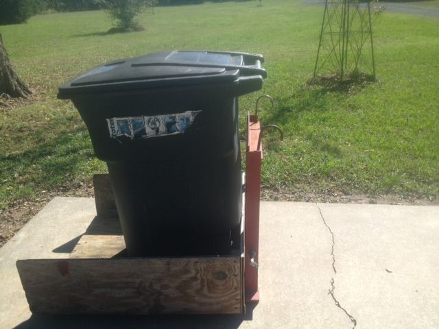

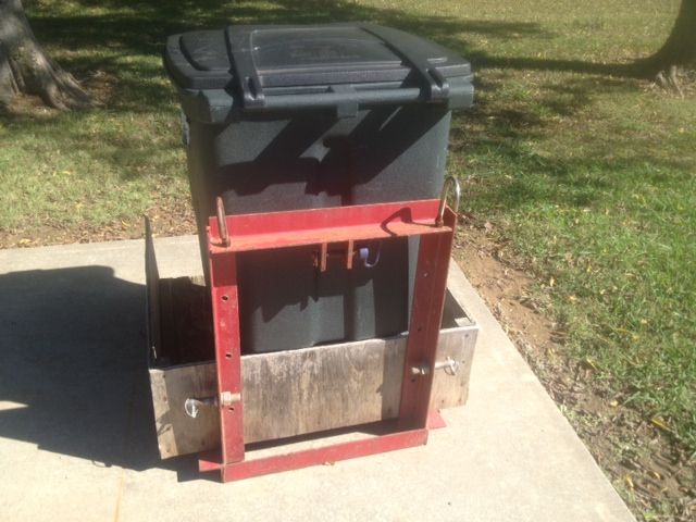

Got the pics uploaded but wanted to add a few comments. This works great to take the trash to end of drive way with front loader top lip hooked under U-Bolts mounted to top of carry-all. However I would not trust it to over a few 100lbs of weight. Design is good but may want something more substantial than u-bolts for real weight capacity. I like that I have FEL and 3PH hook up options. I plan on adding a larger box so I can get more than 1 trash can in it at a time.

Here are some better pictures of this in action. I'm sure that even without a welder, something could be bolted together pretty easily.
