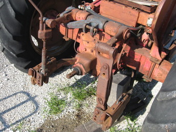

BTW....the IH U 300 I mentioned earlier had a 2 pt fast hitch (did have a insert to make it 3 pt....attached is a photo I found on the web...doesn't look exactly like mine but I did sell it over 25 years ago...and my memory may be a bit fuzzy

I am shocked that it does not have the ability to lift the back tires off the ground. The engineering design was there 50 years ago.
The engineering is pretty simple. But not needed or wanted in most 3 point hitch applications. The implement usally needs the ability to float... not be rock solild. Solid hitch would be a nightmare when plowing, etc on uneven ground.
Why do you need down pressure anyway? Just curious.
