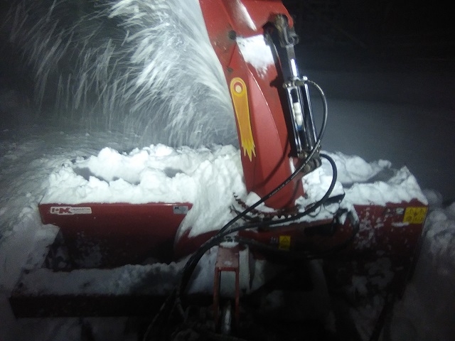

I have an MK Martin. I've had it several years, very happy with it. I have a 78". I do a lot of territory with it, lots of driveway and farm use.
Get both the hydraulic rotate and deflect if you have two remotes.

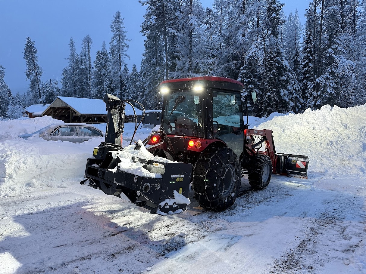

Depends on your budget and your pto HP And width of your tractor and how much snow you get.
I have an MK Martin 87”. Great unit. Seems tough. It is the largest my 75C can handle and I sometimes have to go real slow. Other folks seem to be able to handle pretty big units. But snow blowers take every ounce of pto hp.
