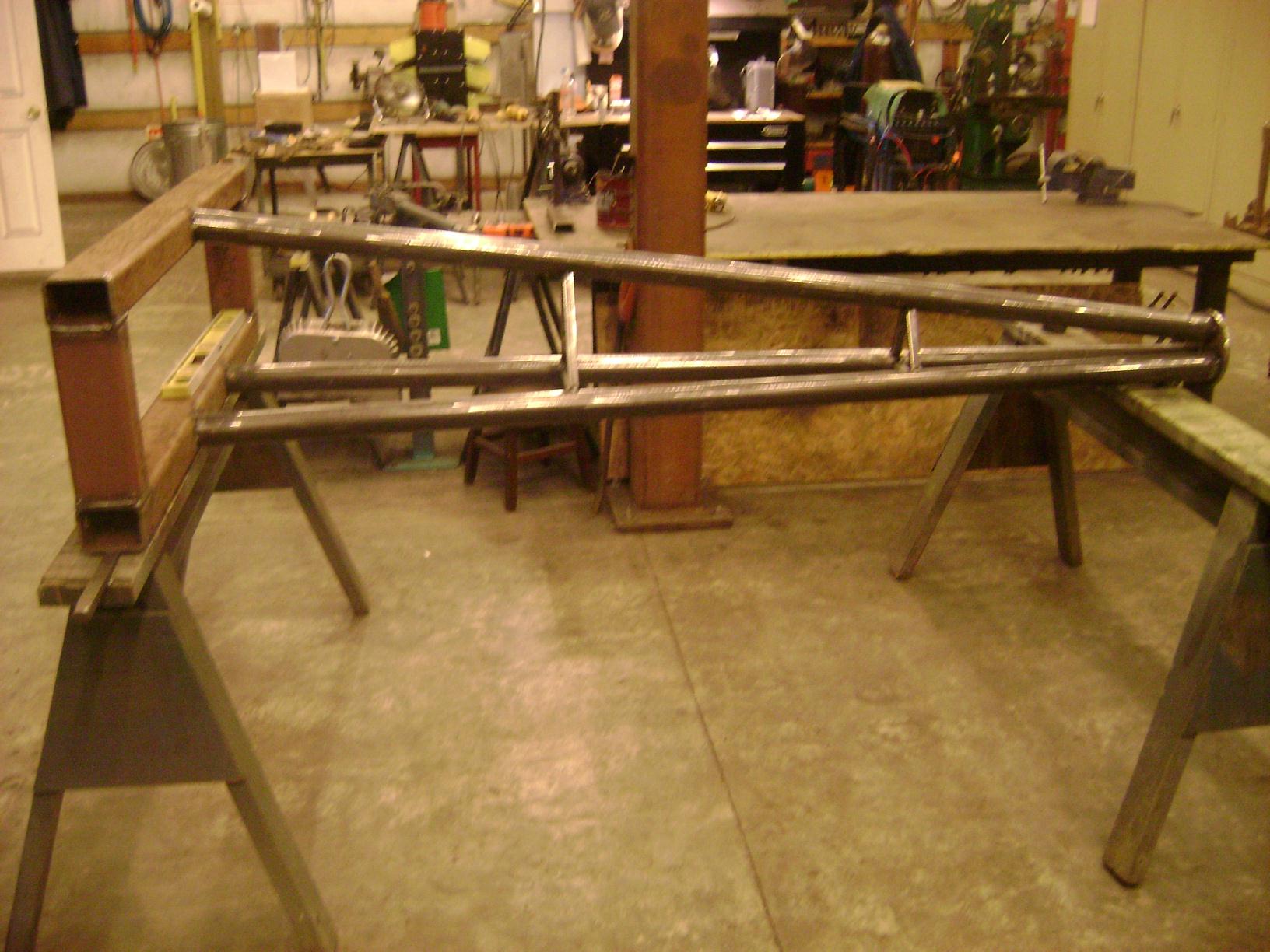

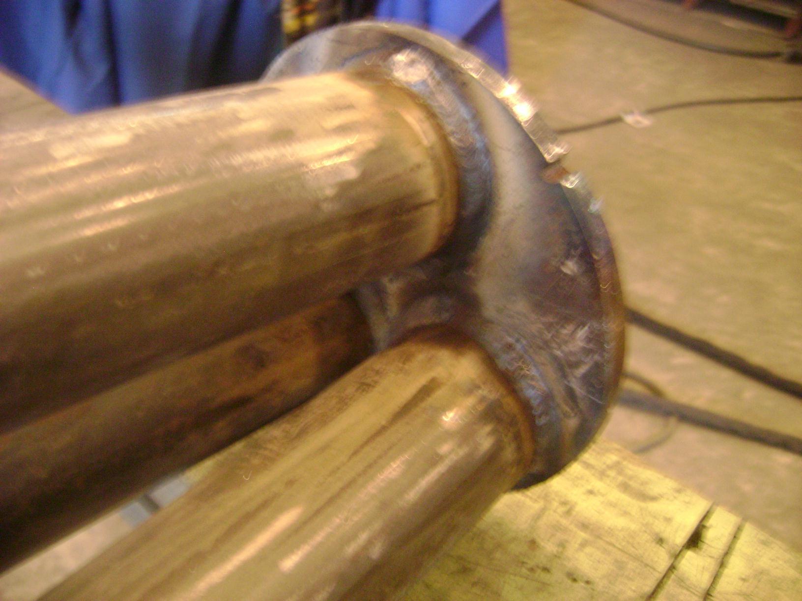

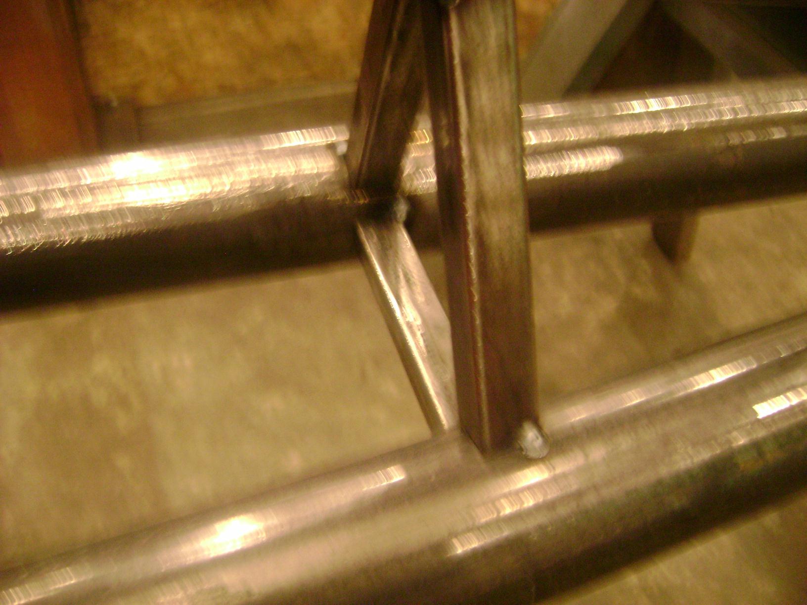

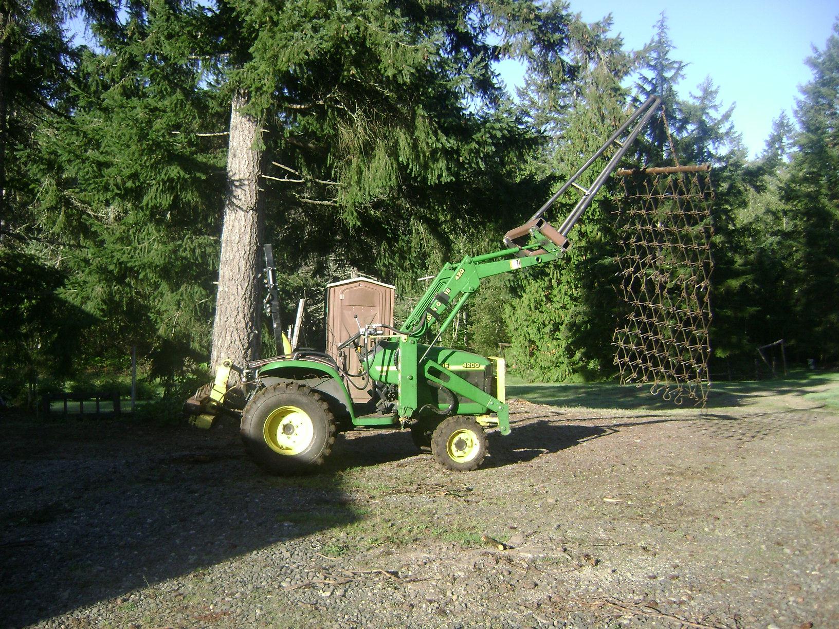

I built one years ago to go on the front end loader.

Also look at Shield Arc's pics. He's an expert on building strong. You need the triangulated design or something similar to it to prevent the pole from bending sideways under load.

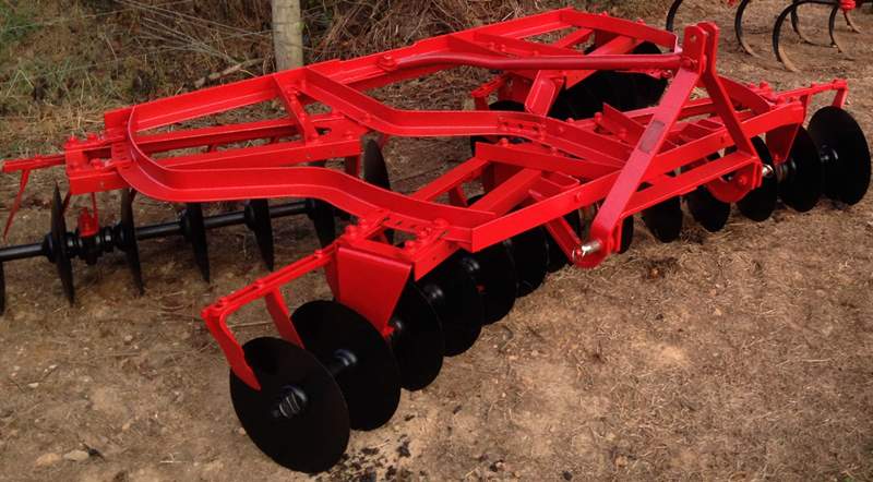

Here's a Boom pole i bought that someone had made at home it's alot stronger then any on the market they used 4" in 1/4 thick weld casing. It picked up my disc on the end loop with ease. best $75 i ever spent plus paint and decals lol

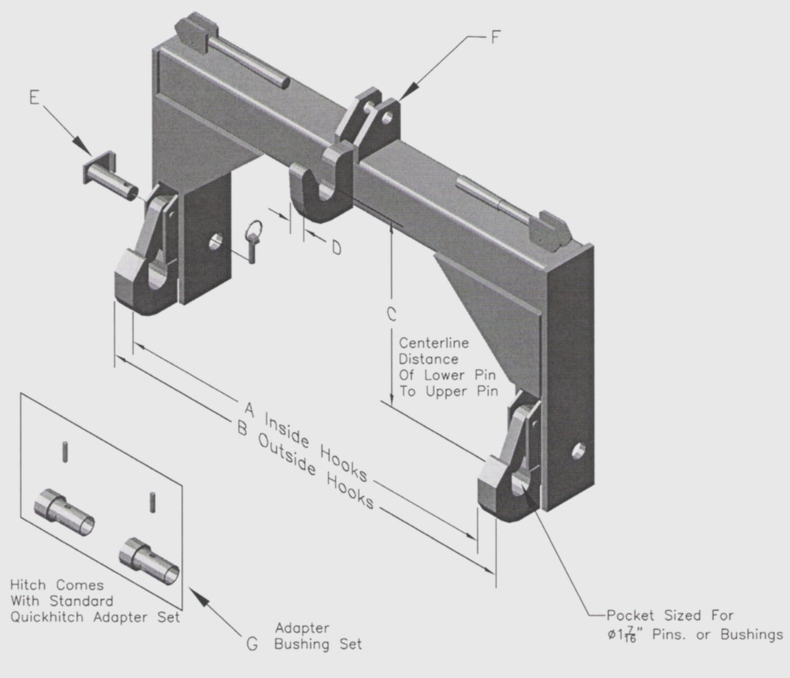

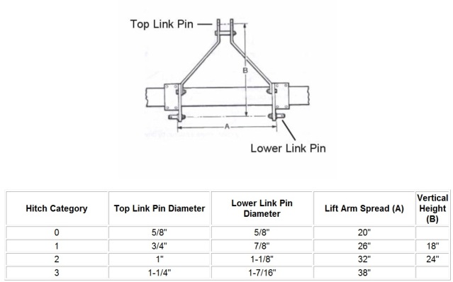

Here are the different Three Point Category dimensions:
If you think you will ever need a Quick Hitch, get it first and build the boom pole to fit it.

!8 for conventional 3 point, 15 for quick hitch.
That's why most modern compliant implements have 2 top holes.
Bruce
