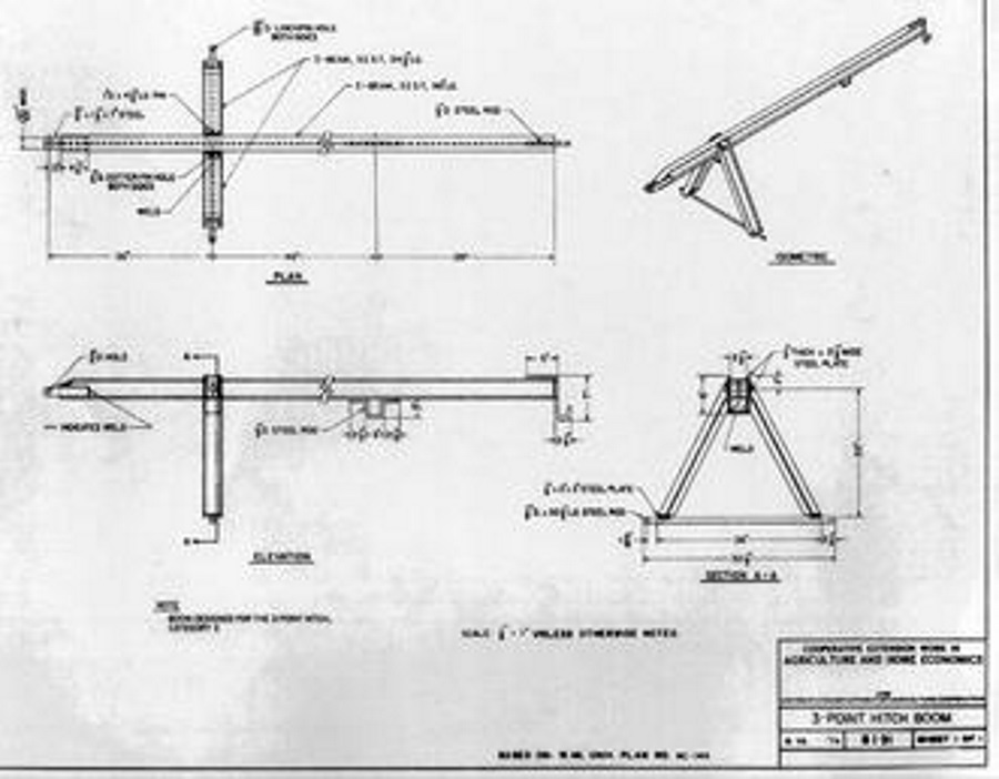

Thanks for all the replies . Correction on model I have a ym 2210 2wd 26hp diesel. I'm not sure what the rating is ,I'm going to try to get in touch with a yanmar dealer in my area to find out. The distance between the top link and bottom hitch points is Right at 20inches vertical and has another hitch point 2 1/2 inches below the top one, there's 20 1/2 inches horizontally . All I really need is 400lb, 2-3 ft of lift at at the end of the 6-8 long pole. And I do not have a hydraulic top link. From what I have read some say it's rated at 1500 lb others say 700 lb. I know that I'll have to add weight on the front end.

Try tractordata for lift specs on your model tractor. For instance the Country Line boom pole says 1000# at the closest to the 3PH, and 500# at the loop at the pole's end. Note as LD1 said the rise in the pole's boom to achieve worthwhile lifting height.

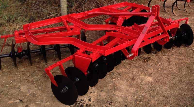

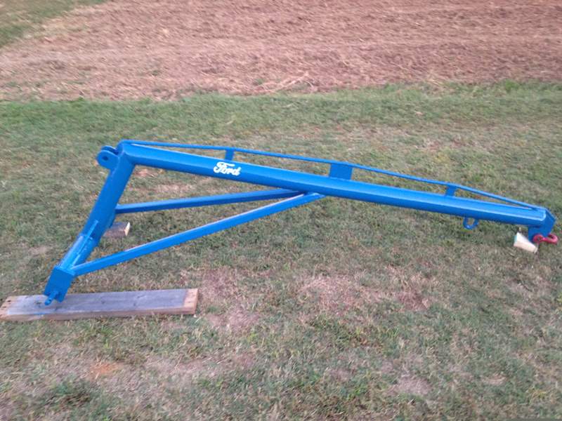

Here's a Boom pole i bought that someone had made at home it's alot stronger then any on the market they used 4" in 1/4 thick weld casing. It picked up my disc on the end loop with ease. best $75 i ever spent plus paint and decals lol

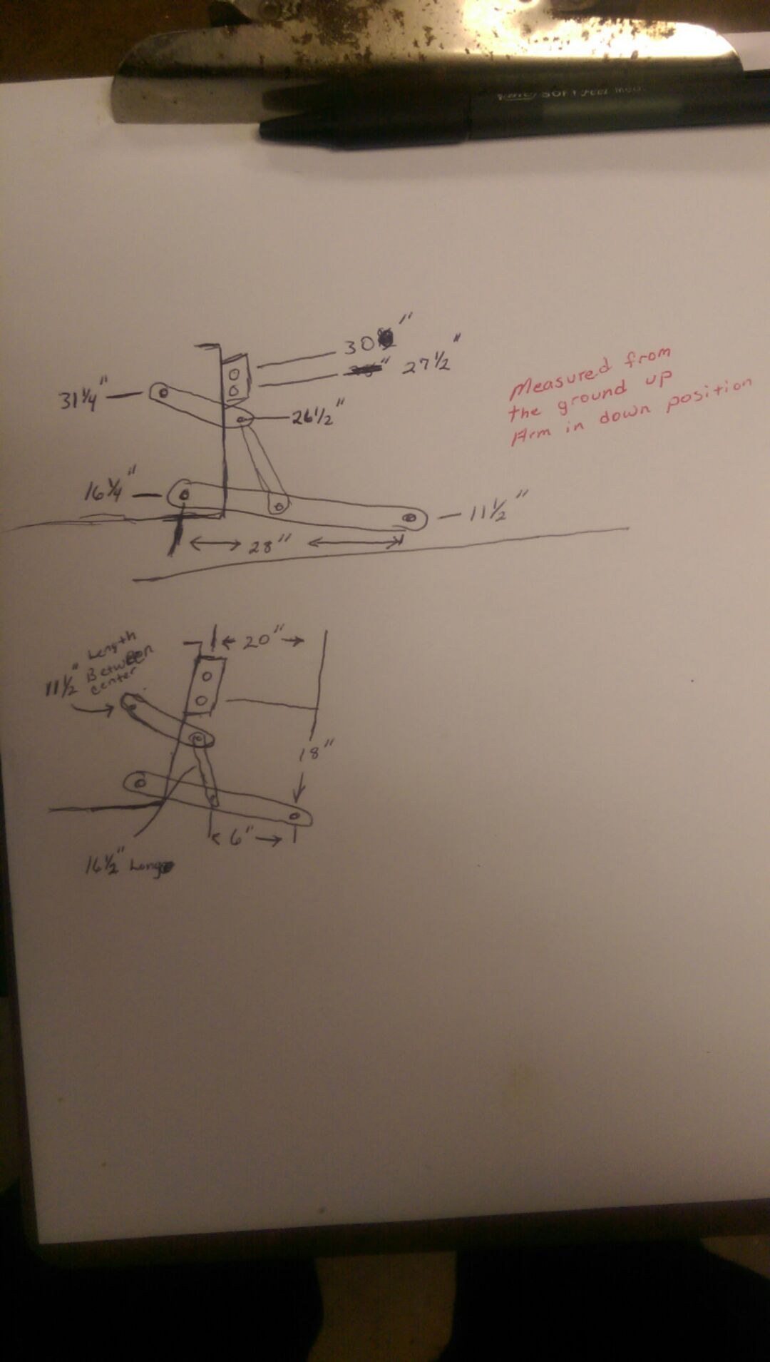

Didn't see lift rating on tractor data. Distance from the ground up to the top link hole is 30.5" on center and 28 to the bottom hole on center. I've not seen any lifts on CL near me. I could build it for less than 50 bucks with materials that I have on hand.
   / 3pt boom pole plans #16
Thats only half the information needed. What is the distance from the ground up to where the lower arms pivot on the tractor side? Are you saying thats only in the 10" range to give the 20" distance between you mentioned earlier? Dont seem right to me.
#17

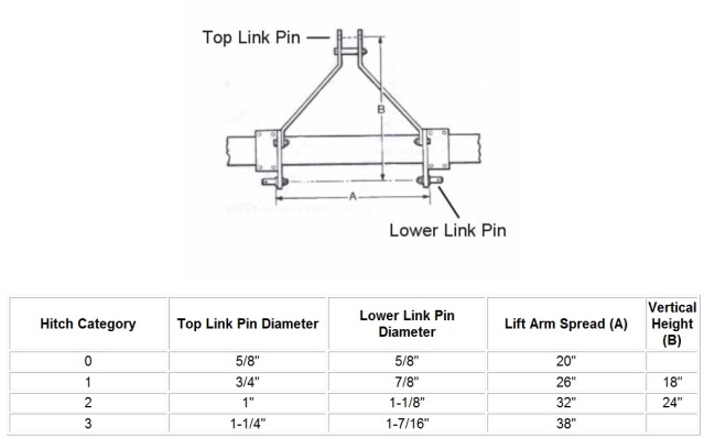

I will measure all the connection points tonight when I get home, draw a sketch, and try to post picture of sketch,if I can figure out how .

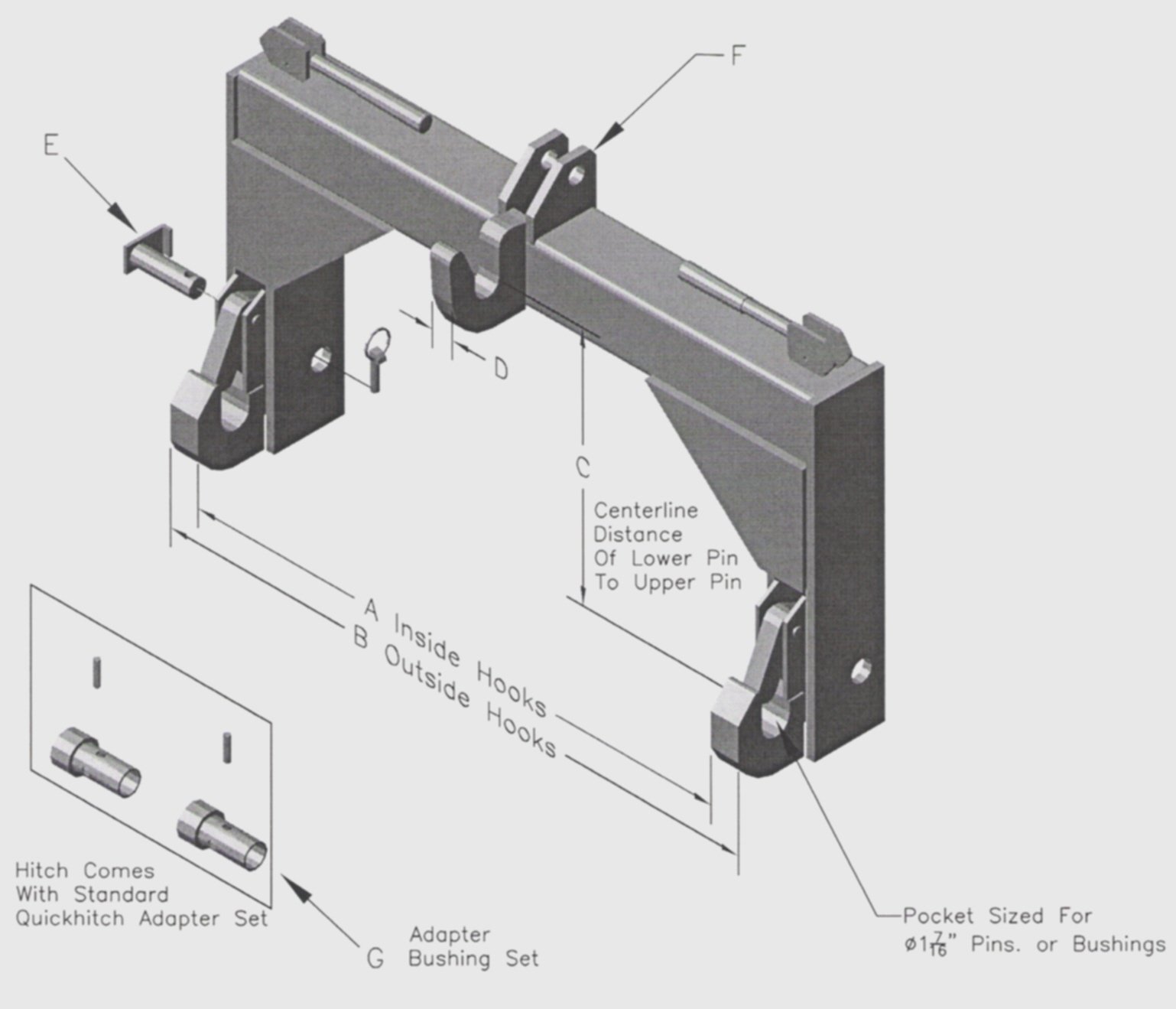

Here are the different Three Point Category dimensions:
If you think you will ever need a Quick Hitch, get it first and build the boom pole to fit it.
   / 3pt boom pole plans #19
   / 3pt boom pole plans #20
!8 for conventional 3 point, 15 for quick hitch.
That's why most modern compliant implements have 2 top holes.
