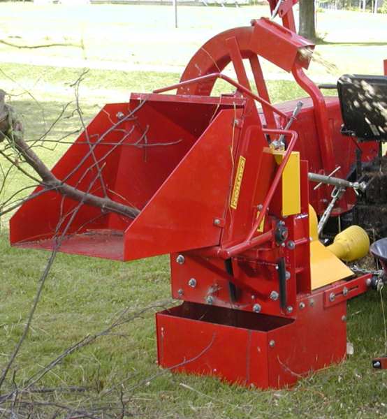

I sell and use that same chipper. Good solid unit. We've chipped up to 5" apple in it running off a 26 PTO HP tractor.
Check with Coastal Tractor and Equipment, 203 877 6606, link. He's in Milford, CT.

That looks like a Chinese chipper. That's not to say it's good or bad but just be aware.
