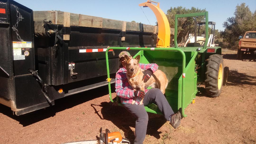

I have a Wallenstein 5" or 6" chipper and it is wonderful. I chip endless amount of spruce limbs from windbreaks plus branches, etc from around the farm. I can chip a 5'x12' dump trailer full in short order and I'm older. I use an M7040 Kubota.
Most branches are maybe 12 or so feet long and 2" or 3". I've also easily chipped up to 5" of white cedar.
I've used other chippers over the years but for a lower-buck chipper, this is my best choice for carefree use and ease of operation.
