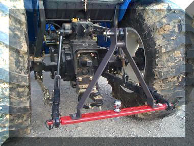

Poking for the name of the attachment that is a drawbar but also hooks up to the top link.
Cannot find it online and I need a name to order it

Braber Equipment 3-Point Drawbar — Category 0, 24in.L, Model# 1005DB | 3-Point Drawbars Stabilizers| Northern Tool + Equipment
Like that? Then you use a couple of stabilizers (one on each side) to reach to the point where the top link pins to the differential. We use this setup on our 8ns because they don't have a regular drawbar. It would work on any tractor with a 3pt hitch.
Also, they're handy for pulling stuff that's offset from center; you just hitch up on one side or the other to move it closer to the middle.

I know what you are talking about , but don't know what is is called . Basically I just made my own draw bar stabilizer like the one others have showed from Northern Tool . It stops the draw bar from rotating completely , thus If i am pulling my cultipacker , I can also back up with out the drawbar rotating up or down , just gives me more control , like backing a trailer hooked to a auto .

This is the one I got. $55. Works great, just don't jack-knife your trailer too tight, or watch that tongue doesn't hit stabilizer bars if you do:

This is the one I got. $55. Works great, just don't jack-knife your trailer too tight, or watch that tongue doesn't hit stabilizer bars if you do: "Functional Accessories For Work & Play" <img src="http://www.tractorbynet.com/forums/files/attachments/386914-3pt-hitch-drawbar-stabilizer-jpg"/>
That's it!
The one I had seen tied into the drawbar pins on each side instead of being bolted down.
Thank to all that replied!

Then that's something different. The one pictured keeps the drawbar from rotating. The stay straps you describe don't. Sounds like you know what you need tho.
