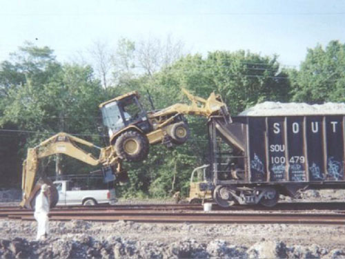

This discussion reminds me of a sequence of photos posted here sometime ago:
I wonder if this guy, thinks he's being unsafe?

I tried get the series of pictures to post with no luck. Here's another try.
