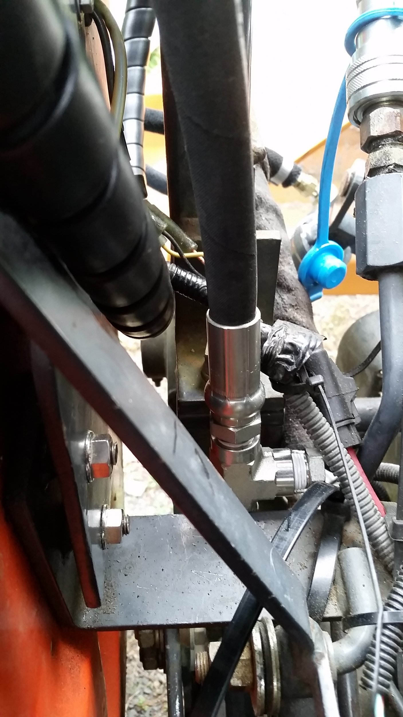

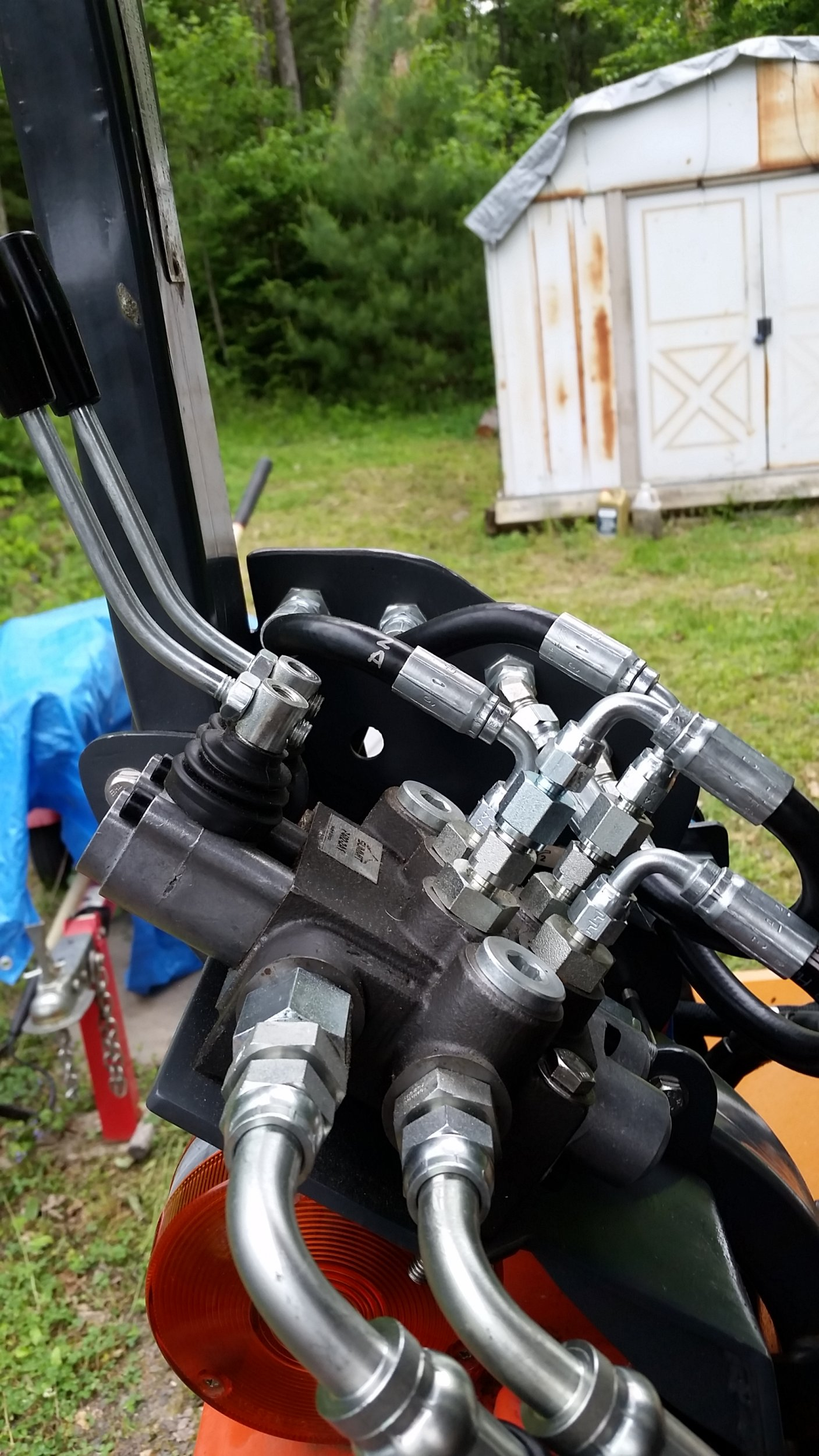

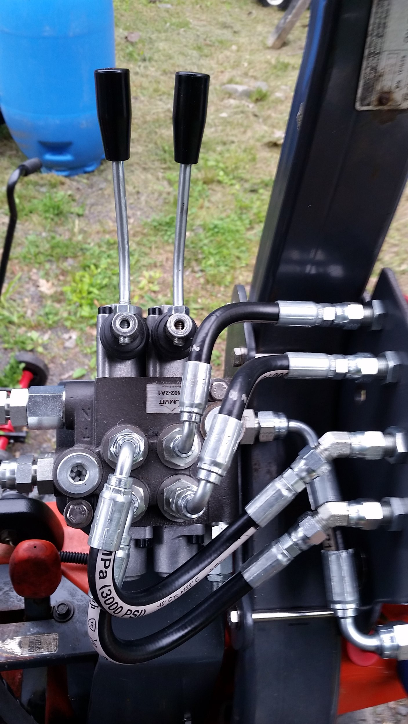

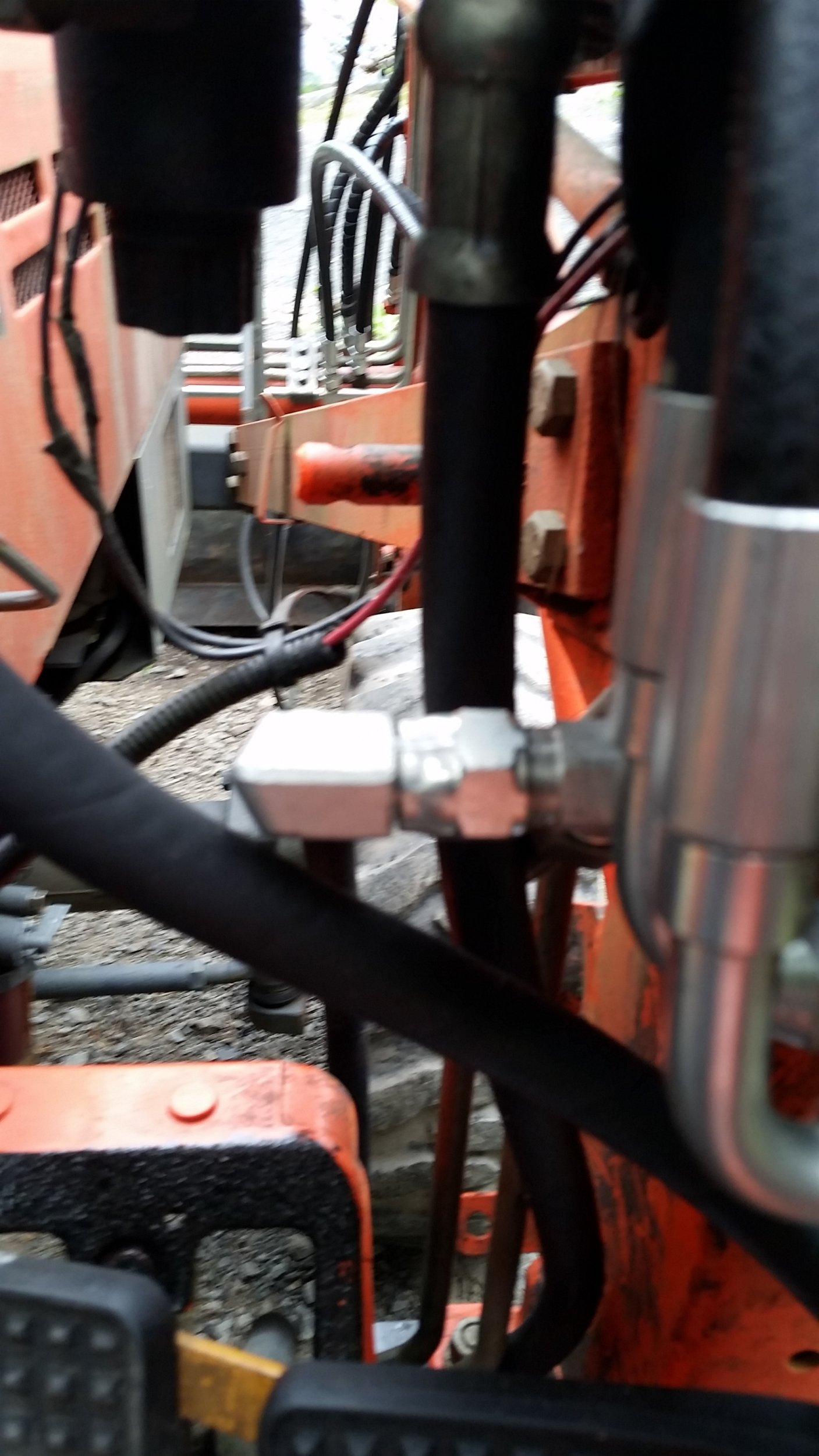

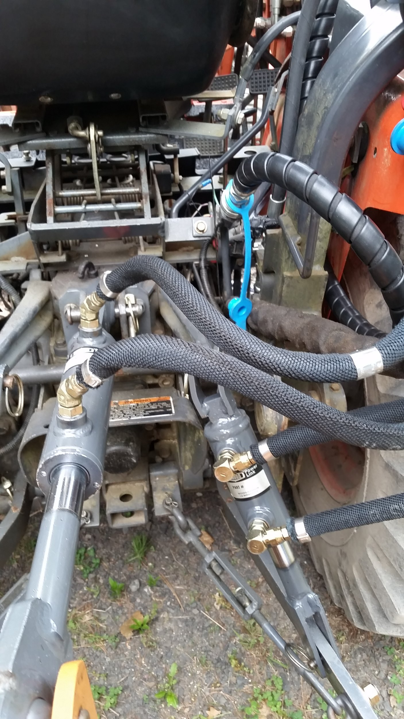

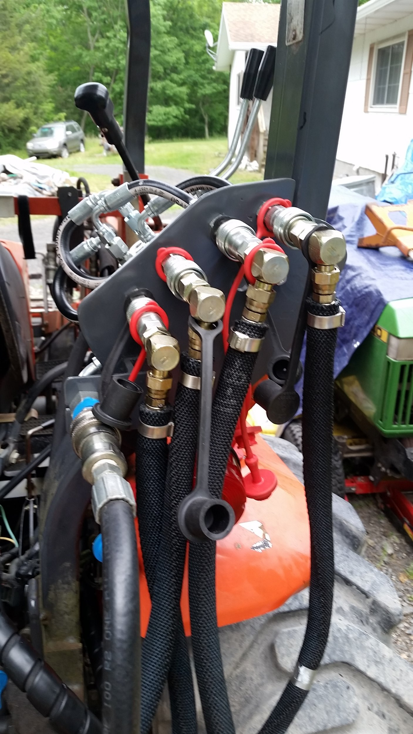

Here's a few.
1 - Return to Tank T at FEL. ORB into FEL. JIC straight is original Tank Return, Right Angle JIC is return from valve.
2 - T to allow future return to Tank for thumb conversion. Upper line is from new valve, lower to FEL T
3 - Top and side link cylinders and hoses
4 - Bulkhead and Quick Connects , 4 for cylinders one for Supply from Tractor. PB hose free connects back to 3PT.
5 - Top view of spool valve and bulkhead connections.
6 - Rear looking view of spool valve and handles how I bent them.
