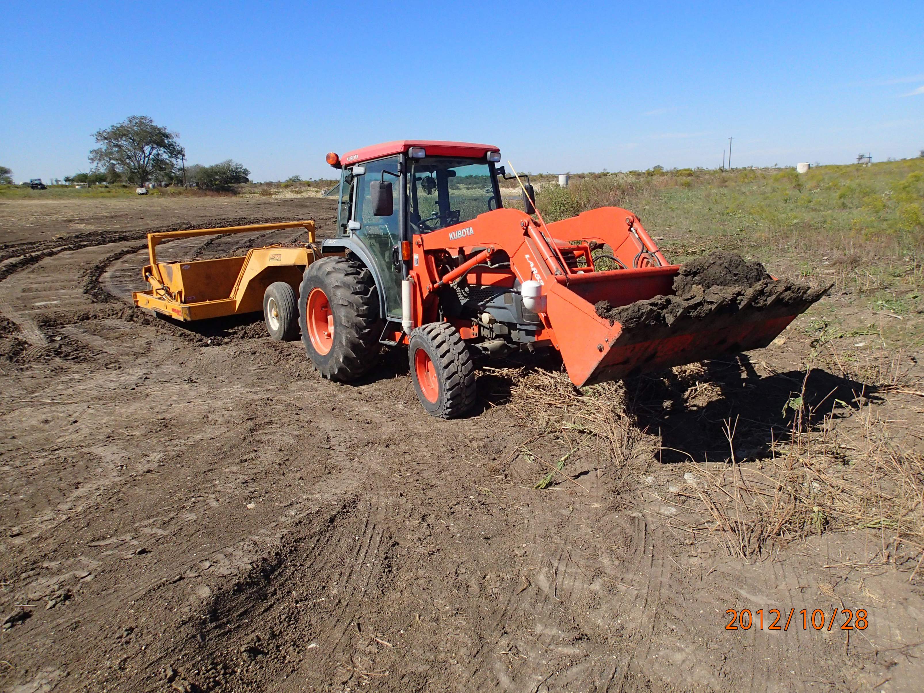

And, you're making me feel a little better regarding how my Grand L 5030 performed with the scraper.
I carried the FEL with about a struck load of dirt...to give maximum traction to front tires.
Front tires were new.

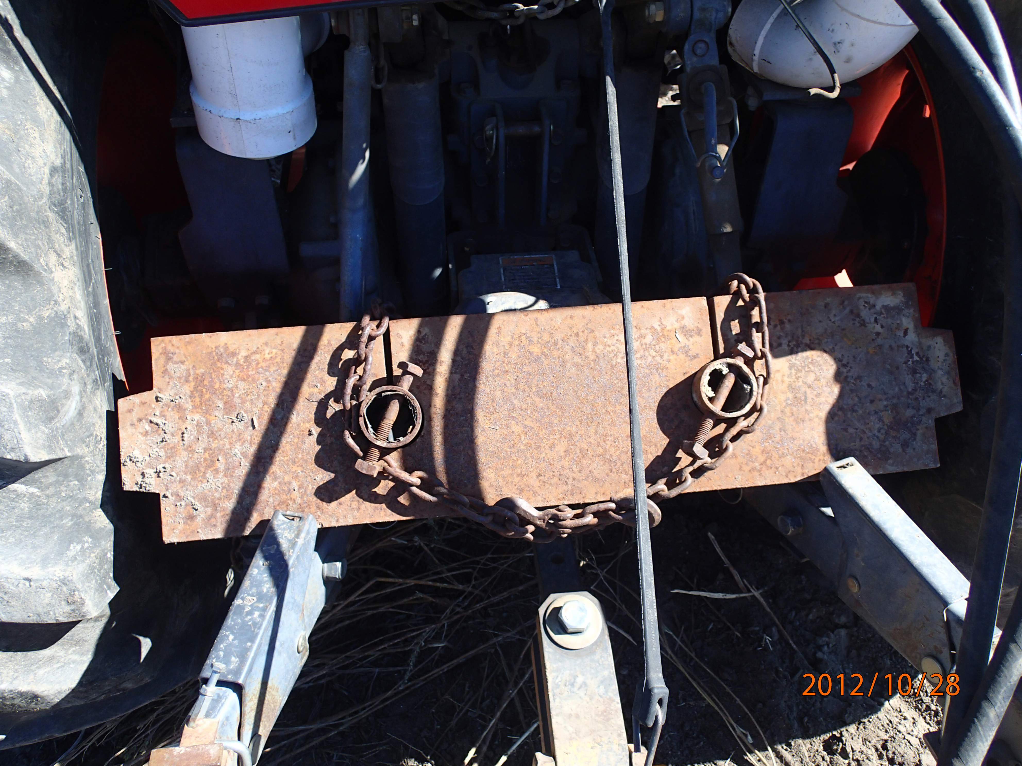

I added 280 lbs to 3ph for more rear traction...rear tires are loaded.
I always engaged the rear wheel lock.
I used 4wd and low range...with HST
Scraper was pin hitch tongue pull with 2 front steering/support tires and 2 rear tires
I feathered the blade up and down hydraulically, seeking to maintain forward motion just at the point of losing traction.
When traction was lost, I would raise the blade ever so slightly to reduce the drag and return to forward motion.
I ran 2600 RPMS and all 4 wheels were pulling/slipping as I sought to apply all 50 hp to the ground.

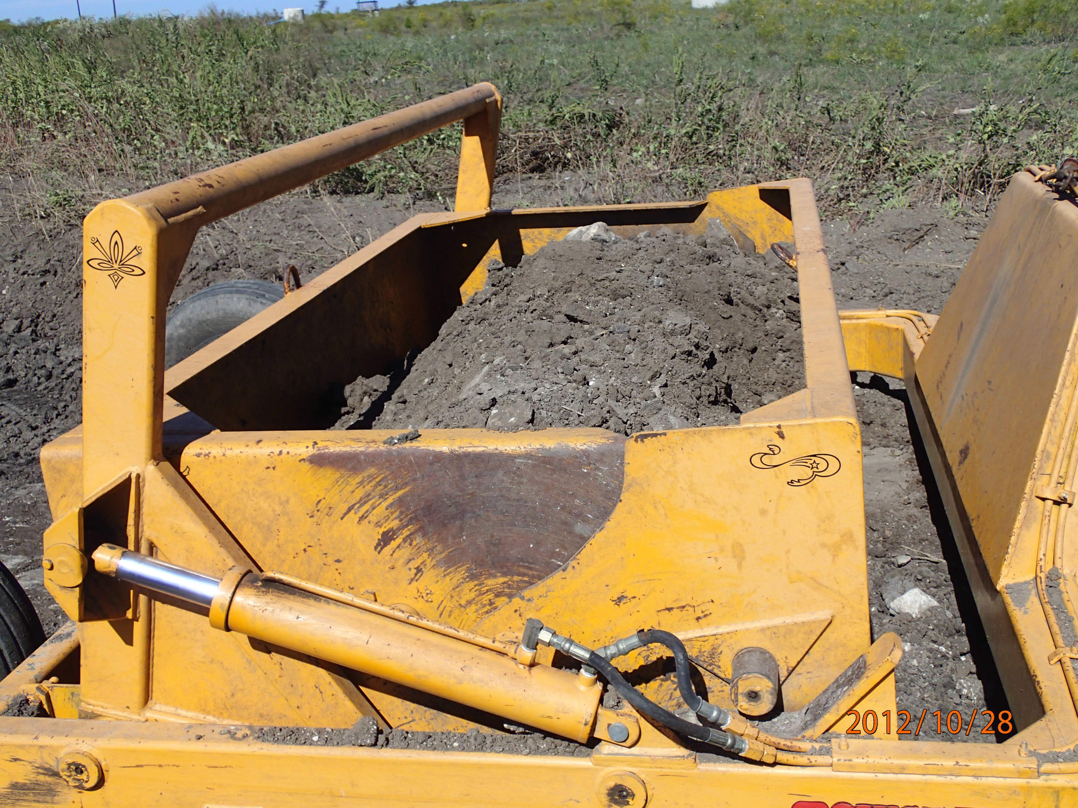

I would stop the pull when I judged that I had captured all the dirt that I could for that pull and carefully raised the bucket so the front closure would come down and capture as much dirt as possible.
Best pull was about a 95% struck bucket full.
Typical pull was about 2/3 of a bucket full.
I never got a pull where the dirt bubbled up and fell off the edges, as I saw done on U TUBE.
Often, perhaps because of terrain, one side of the edge would catch and fill one side of the bucket while the opposite side of the bucket would have only a little in it.

One of the more successful pulls I had
The whole rig
weights on 3ph

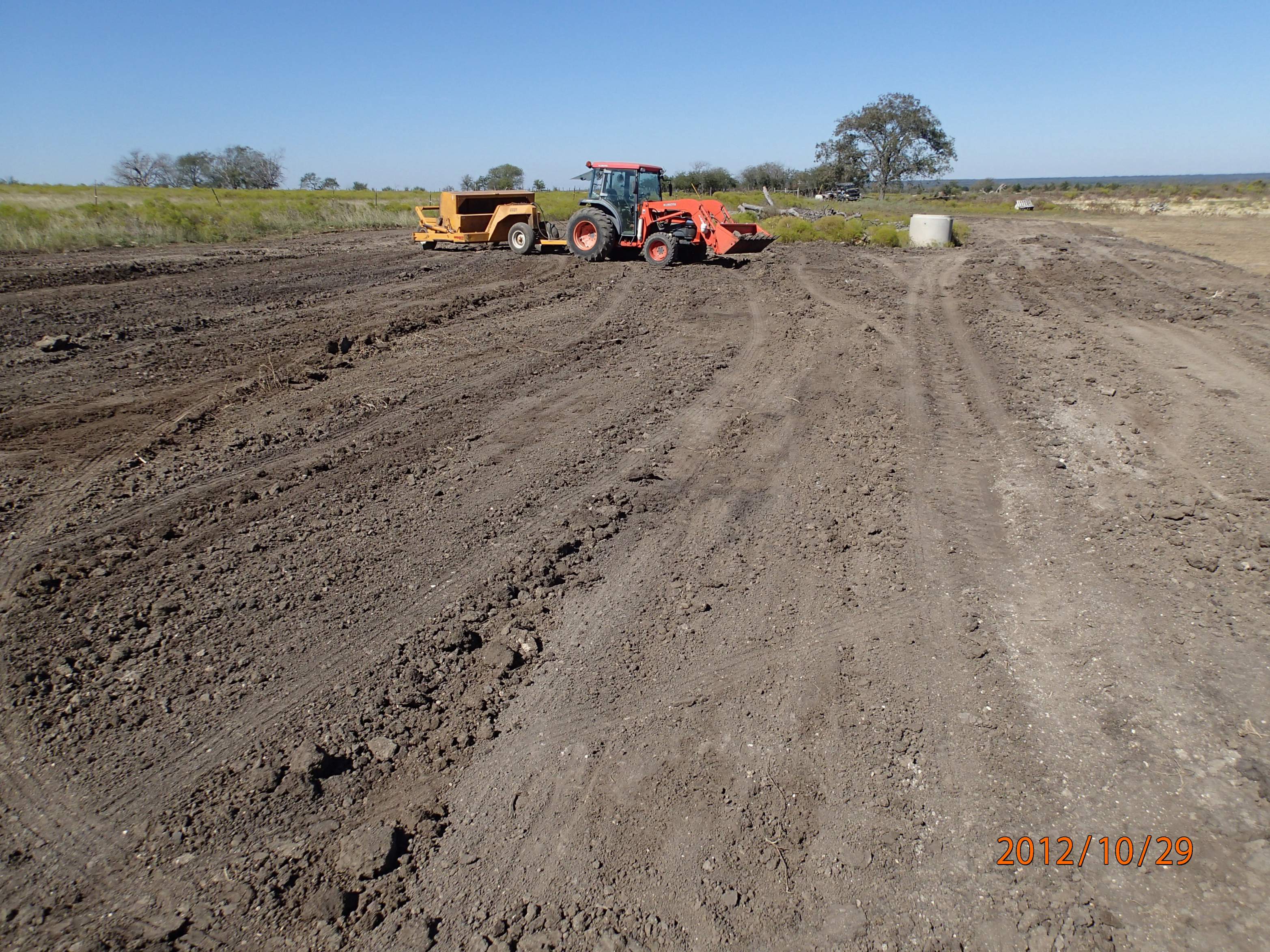

dig area, rig in distance in front of existing dirt tank (been in a drought)

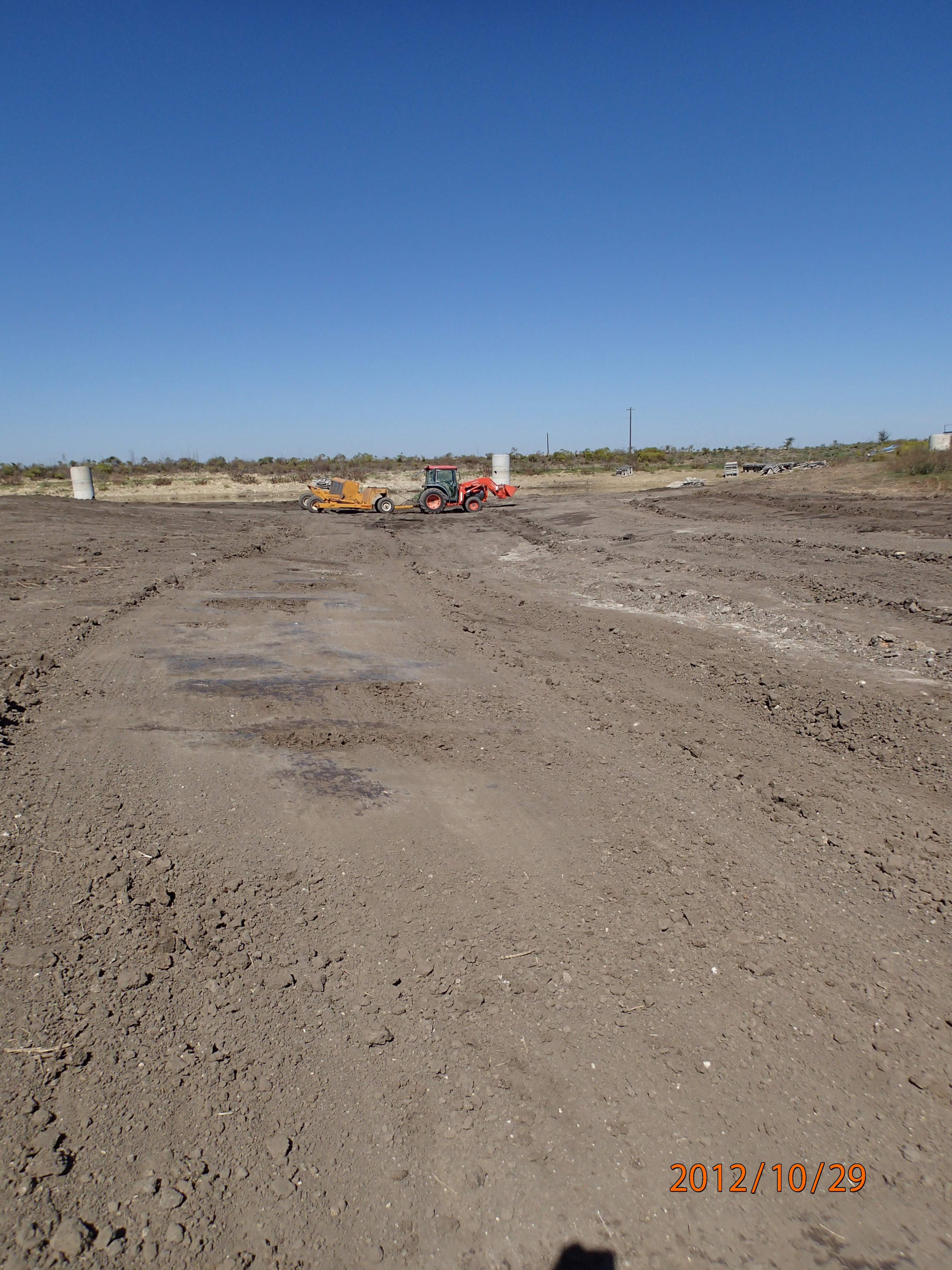

spoil area above spillway water line

Proper name for the soil is Houston Black Clay...people call it "gumbo" for short...and, yes, when wet you get stuck and it can't be worked at all. Soil conditions were right...in some of the photos you can see where the blade bit in a bit, then released, then bit in again. We've had only one runoff rain this year...early spring...area I dug out was under about a foot of water then. It'll be 6 feet or so next time we get runoff to fill the tank.
