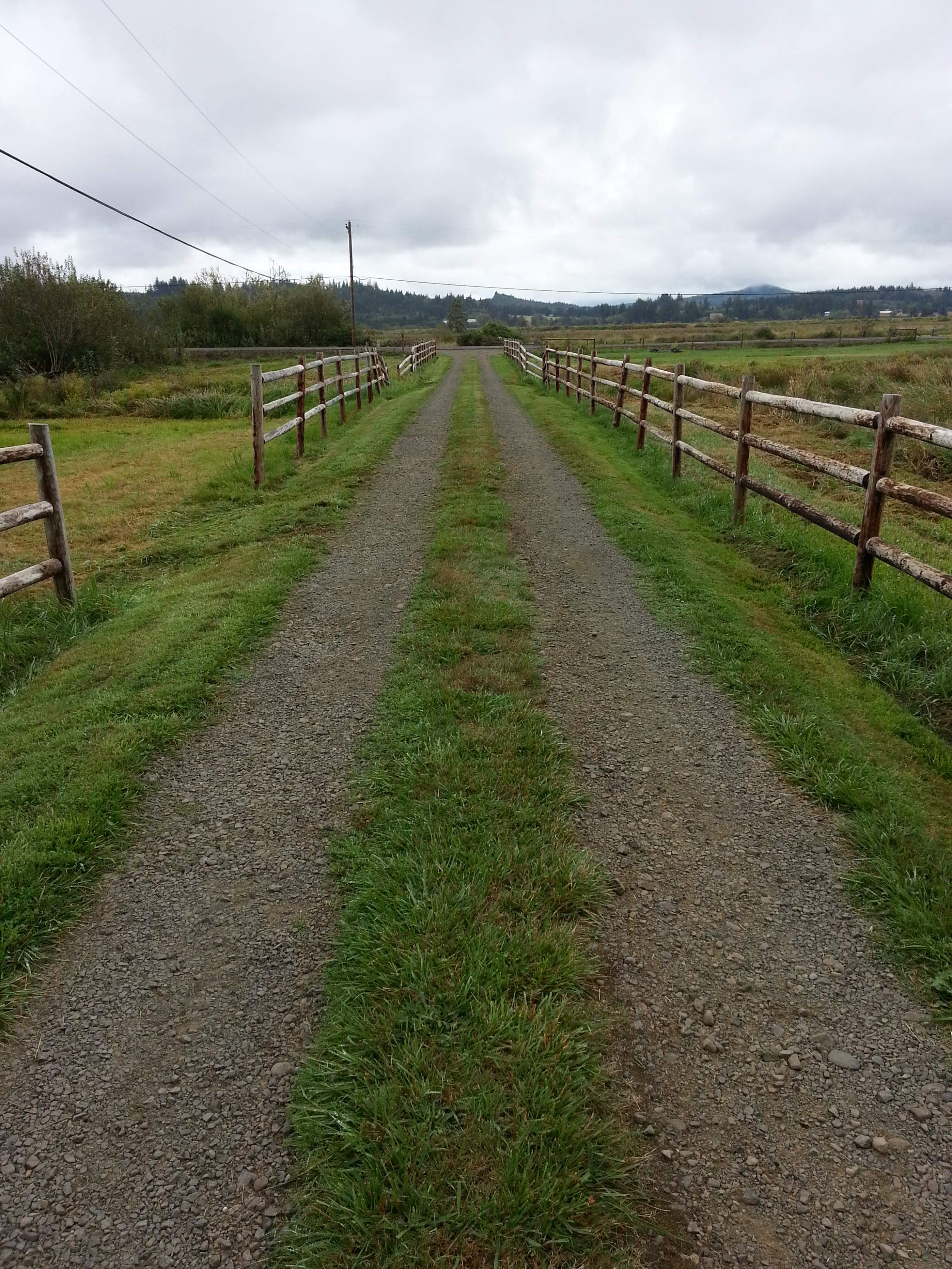

My gravel driveway has a grass strip in the center which makes it a little more challenging to maintain. Is there an implement out there, or one that can be modified so I can grade both sides in one pass?
Here's a pic:

Get a wide (8') rake and remove the center tines?

Looks like it only needs some occasional mowing to me!! :thumbsup:

Looks like my driveway. I blade mine out in the spring using a grader blade to first remove the slush, then reverse the angle once the slush is all gone and throw the gravel back out of the yard and into the drive. I then use the box blade to spread, fill, smooth and otherwise recondition the drive. The grass all grows back in the middle in a few short weeks.
