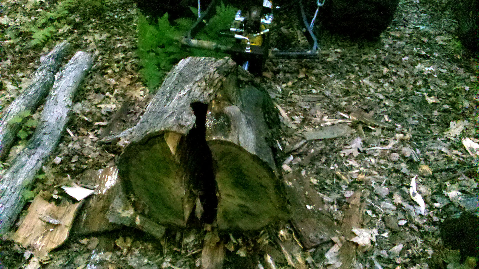

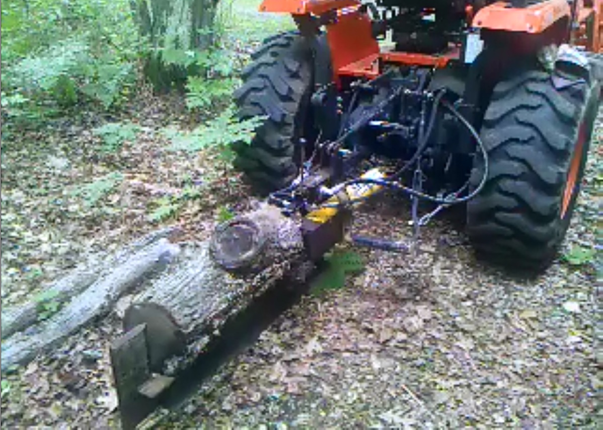

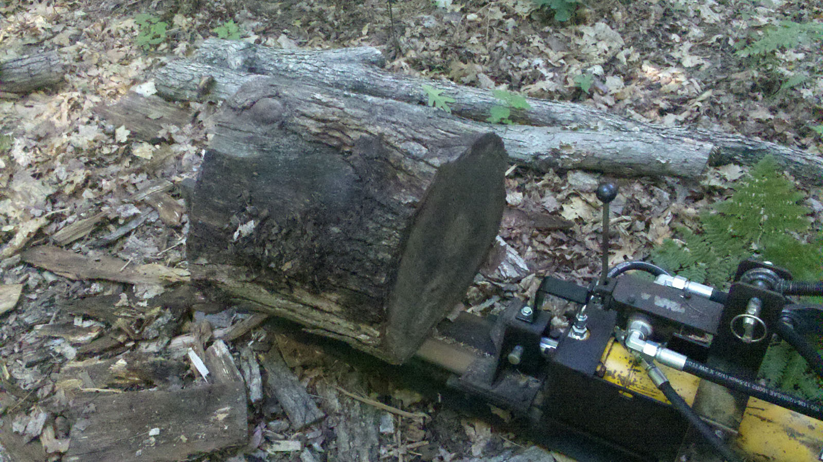

Cant help you with a $500 splitter but i did a lot of research on 3pt splitters mine just arrived today its a SplitFire. The 3pt 2 way is about $1000 and its not made in China rather Canada. The Norhern tool essentially copied this design with a few tweaks to make it shorter. Its a 14 Ton but claim 20 ton equivalent due to their unique stop block being more efficent than a traditional plate.
Split-Fire Sales Inc. :: 3403 Woodsplitter :: Quality Built. High Performance. Split-Fire - Your Best Choice
My New Splitter
My Custom Ordered Split Fire log splitter
   / 3pt log splitter #8
We have been using an old home made splitter with a 4" cylinder and small hoses i was not impressed with the cycle time and always having to wait for it to return. I guess some of the new valves are auto return but the Splitfire does not need this feature. Their customer support is awesome and they will custom build to your liking.
Here are their list prices. my dealer was about $130 under list.
