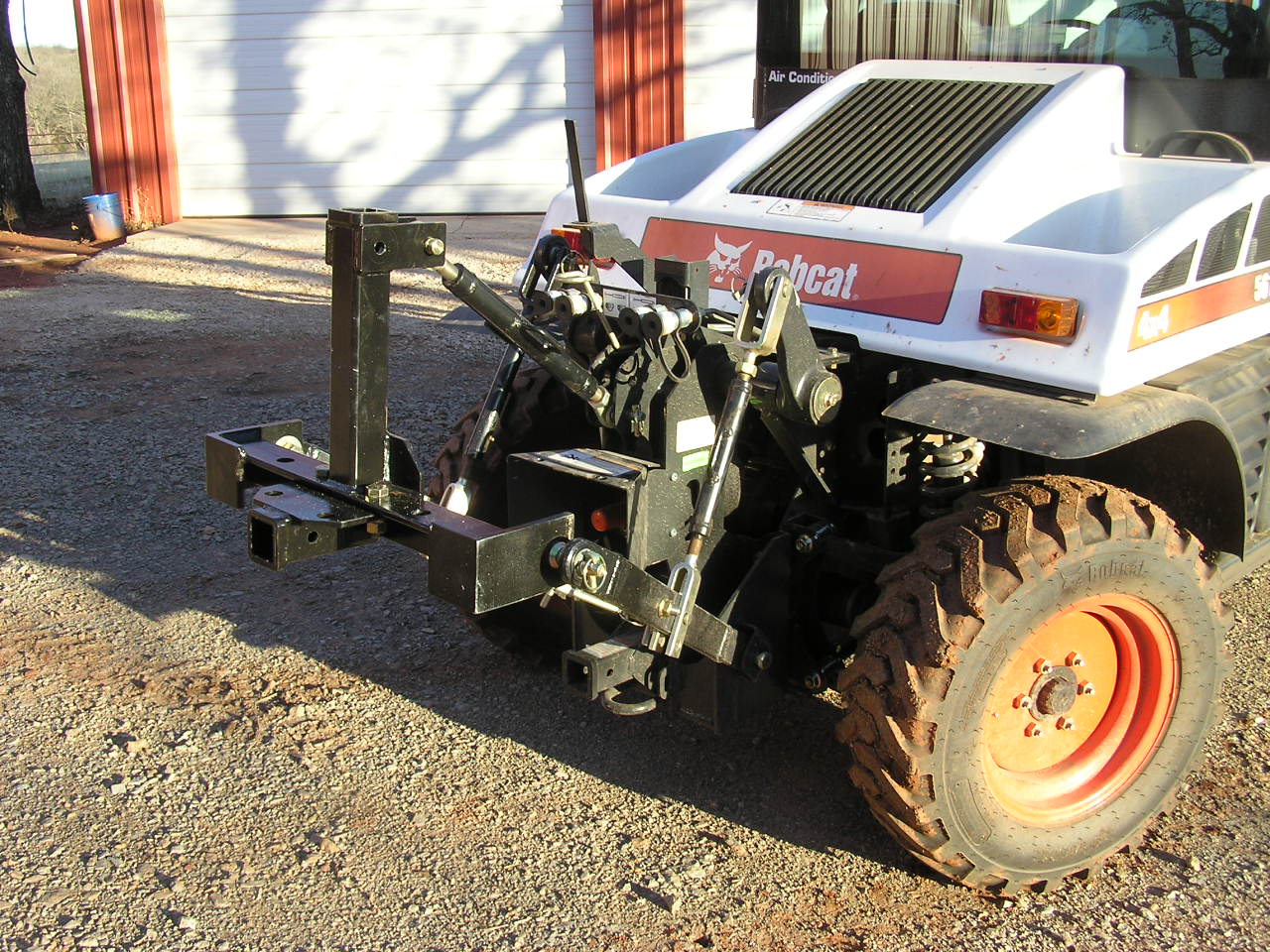

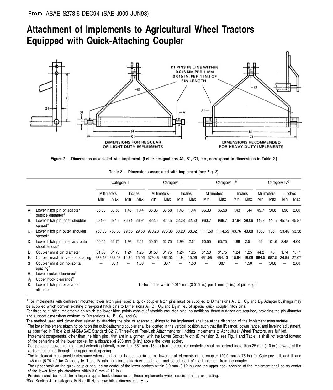

I'm looking for a set of plans for a generic class I 3pt hitch mount (don't know what the right buzzword is...) - either 'T' style or a triangle. I would also like to see related specs for pins and top link hole diameter, as well as ranges for width and height. If somebody could supply a link that has some or all of this stuff, I'd be forever grateful.

From my Mahindra manual,
top link pin is 3/4 inch in diameter with a gap of 1 3/4 inches between the uprights( top of the mast)
Lower hitch pins are 7/8 diameter with the distance between the inside of the shoulders is 26 7/8".
The mast hight is about 20". This can be a little more or less. I would have to go measure something to get an exact distance from something factory made.
Hope this helps. I can take a picture if it is still light when I get home from work tomorrow if you would like.
