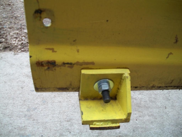

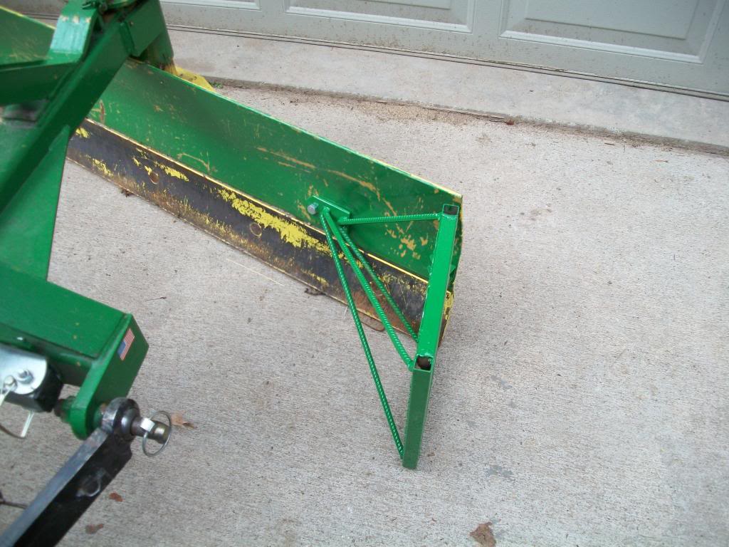

I use my FEL and a 5' back blade with a homemade wing and skid shoes for snow...
This is on my older JD 855...
Not pretty..... But.... works well for me..
Good luck...
