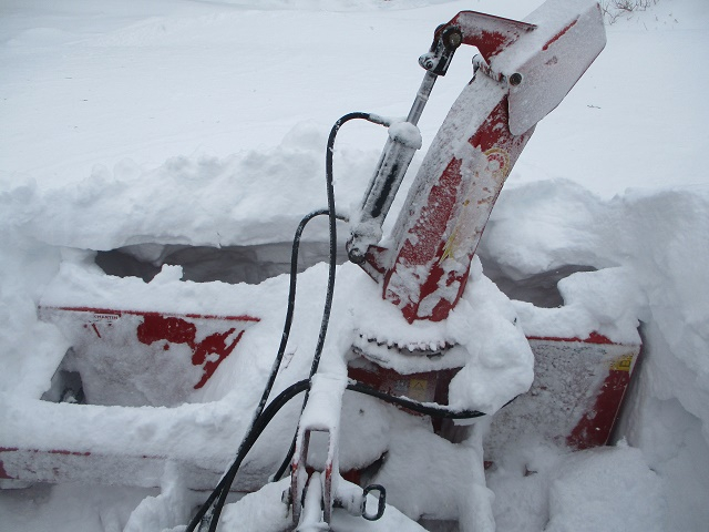

72" snow blower on a 50 hp 40 PTO hp HST New holland tackling hard snow drifts. It hadn't snowed for over two weeks and the weather had warmed to the mid 30s for four days before it started freezing again. Then on the 20th of December the wind started blowing 30-40 mph all night long and was still blowing 20 mph when I was clearing it. There were times when I had to slow down and let the blower clear, but it got through it all.
I would have just driven over that snow and blown it out. No need to windrow snow that deep.
I used to mount my rear blade on the FEL using an adapter to windrow light snow falls to the center and then blow out the windrow. Realized if there is less than 4” of snow there is no need to clear the driveway. We have 4WD pickups.
KISS.
