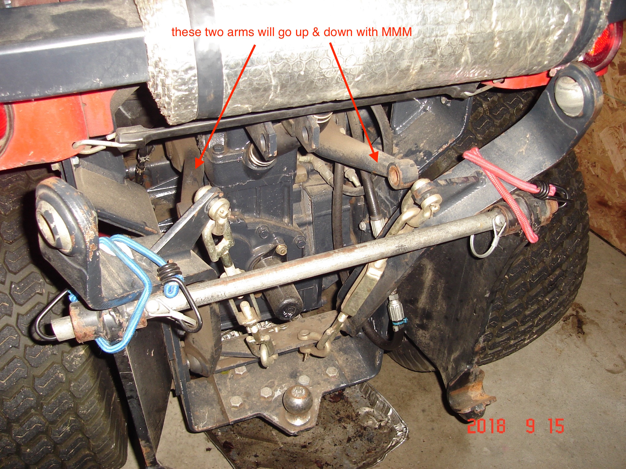

I was wondering with the 1705's if you can separate the hydraulic functions of the 3pt and the mower deck. Another words can I leave my 3pt up and have my mower deck down? Im asking b/c I need to know if I can do this for my pto driven leaf vac.

Yes it has MMM, However the leaf vac is a pull behind thats pto driven. And I was wondering if the hydraulics can be separate from each function rather than together. So can I lower and raise the MMM without having the three point do the same. Is there switch. I don't think there is atleast from what i have read from the manual

Just use some twine to tie the 3pt arms in the up position, then the mower deck can go up and down without the 3pt moving. I know you can lock the MMM in the up position to use the 3pt without moving the deck, just apply the same concept to the 3pt. The 3pt is a one way hydraulic cylinder so there is no down pressure on the arms.

The mower lift linkage is connected to the 3pt lift arm, so the short answer is no, you cannot separate the mower from the 3pt hitch. The long answer is that if you disconnect the lower 3pt arm from the lift arm and hold them up with a chain or something, then you can effectively separate the movement. If you do not disconnect the lower 3pt arms from the lift arm, the mower deck will not lower.
Here is a video of the installation of a grass catcher on a 3pt hitch. You'll see they disconnect the lift links and install "stabilizer bars". That holds the 3pt arms up, but disconnects them from the lift arms allowing the mower linkage to move.

"Stay Chains" (Check Chains - Limit Chains) may be a option... And connect vac to chassis draw bar (tow point) ....

The lower 3pt arms are connected to the 3pt lift arms with a solid link. You either need to disconnect them, or perhaps replace that link with chain. Otherwise, when you install check chains, the lift arm wont be able to drop either, and the mower linkage is connected to the lift arms.
