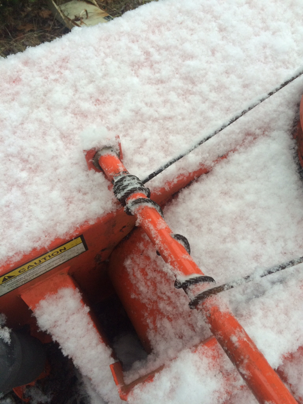

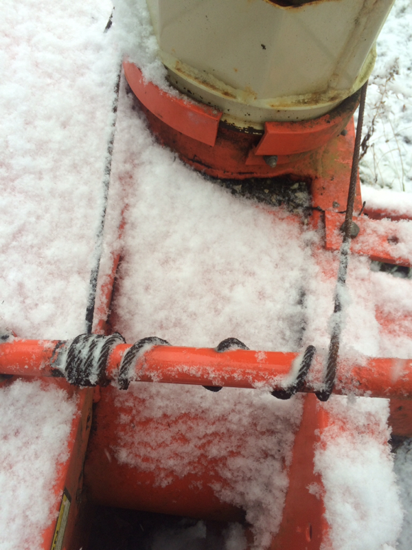

Finished putting it all together today but only have one issue. I can not figure out from the manual how to get the cable to wrap and then fasten with cable clamp. There is no diagrams and the instructions were very vague. Could someone post a couple pics of the manual spout assembly and how the cable is ran from the handle. I am normally pretty good at figuring things out but was a long day and just ended up leaving it. I also got a BE Agriease Quick Hitch and installed it. It is pretty slick and get alot more elevation on the snowblower and the back blade I tested out. The only drawback was the QH only came with 1 set of adapters that slip over the pins of the implement. Will probably just tap out spring pin and move adapters to rototiller in the summer or look for another cheap set of slip on adapters. The price did not include setup which would have been another $200.

I took these this morning, hopefully they will help...... It's snowing like crazy here, I guess I better get the blower on the tractor....KG

Here is another pic, this pic is taken with the chute facing directly forward . Ie the same direction as the main auger. The lugs for the cable are on the far side of the photo. As you can see in the photo ,with the chute in this position the cable has three complete revolutions on each side of the control rod. One side wraps clockwise, the other counter clockwise

I thank you for the pics KiotiGuy it helped immensely. It works great now! Got the tension tight but needed an extra set of hands in order to keep in from uncoiling. Now if it snows I am all ready to go! Looks like you had some already KG.
