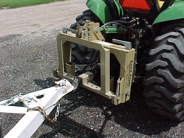

Is this a receiver tube and insert or a solid piece? I've looked at the two photos and can't really tell. Obviously, I'm hoping it's a receiver and insert because I have some other things I can insert in the tube (like my winch setup). Even if it's not I think it's a great deal for the money and want to get one.
/ 3pt trailer hitch #26
I contacted Lowery's today and found the hitch (they call it a 'Towbar') is the fixed (solid weld) style. The young lady with whom I spoke said she didn't see a problem with them building one with the reciever tube for me (or even possibly making that an option in the future). She did tell me, however, that something like that would be more likely to happen "in the winter" as they are just "swamped and way behind" right now. It sounded like anything even remotely 'custom' isn't in the cards now. /w3tcompact/icons/smile.gif

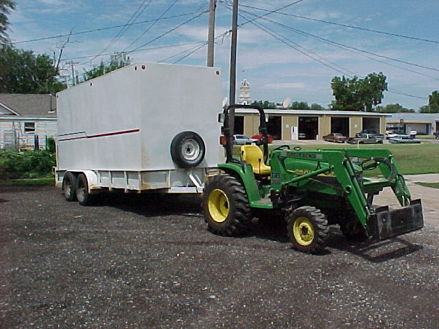

I have a drawbar and still like the idea of having one of these. One reason is that with this I could move trailers around without cranking up the jacks. Truth be told, I'd probably not lock down the coupler and just back under the coupler, lift it up and go. I'd only be moving something a short distance to set it down again. Another reason is that my drawbar is so low that I doubt I could get the swivel jack up high enough to move one trailer I have with just the drawbar.

I still ordered one even though I could weld one of my own - just not enough time between installing new barn and chasing house builder. I need one so I can pull my 16' trailer around for fall hayrides at our church - got volunteered since I have a tractor! However I will add some links for a chain to connect drawbar to hitch to prevent it from going skyward if more weight is on the back of the trailer than on the tongue.
