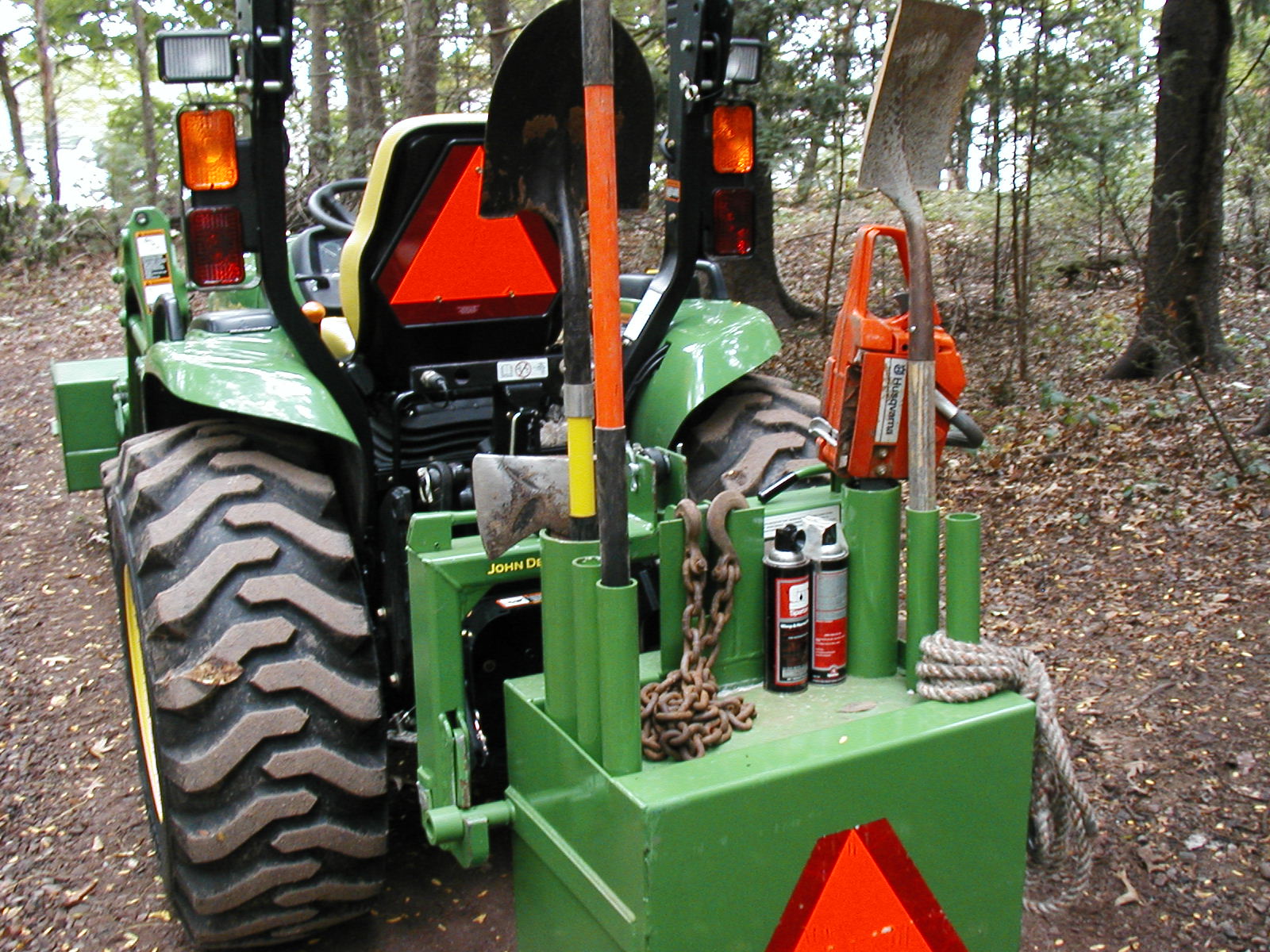

Yeah it's an interesting idea, but I think not practical.
I filled mine with concrete to about 2 inches from the top, set some pipe in it for tools and never looked back. I resisted filling with concrete cause I also thought I might need to adjust the weight, so I used crushed stone for a year or so. Then I realized I never changed the amount of stone and I needed a little more ballast, so I filled it with concrete.
Since I filled it, I have never regretted it or thought I might need less weight, it's attached with a quick hitch, so if I don't need it, it comes off in 5 seconds.
The pvc pipe makes a great way to carry tools, I used four 1.5" and one 3" and one 4" the bigger pipes are handy, you can drop a chain inside or put a chainsaw in also.
Good luck with whatever you choose,
JB

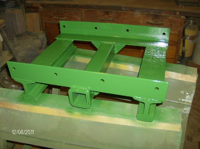

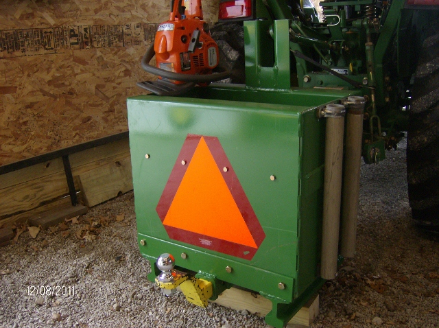

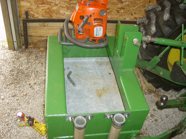

I've been working on the JD weight box for my 790 to make it more useful to me.
To start with I used two pieces of 1/4" x 3" angle to frame the legs & receiver tube, old RR rail for the legs.
With that bolted to the box, I also added a scabbard for the saw & 2 plastic conduit tubes for shovel, rake, etc.
After putting in the scrap iron weight, including 15 old cast window weights, bringing the total weight of the box up to 650 lbs.
Then bolting in a galvanized tray (old granary door) leaving an 8" deep box. Most of what I used, except the angle, tube, bolts & paint were scrap I had on hand. ~~ grnspot
