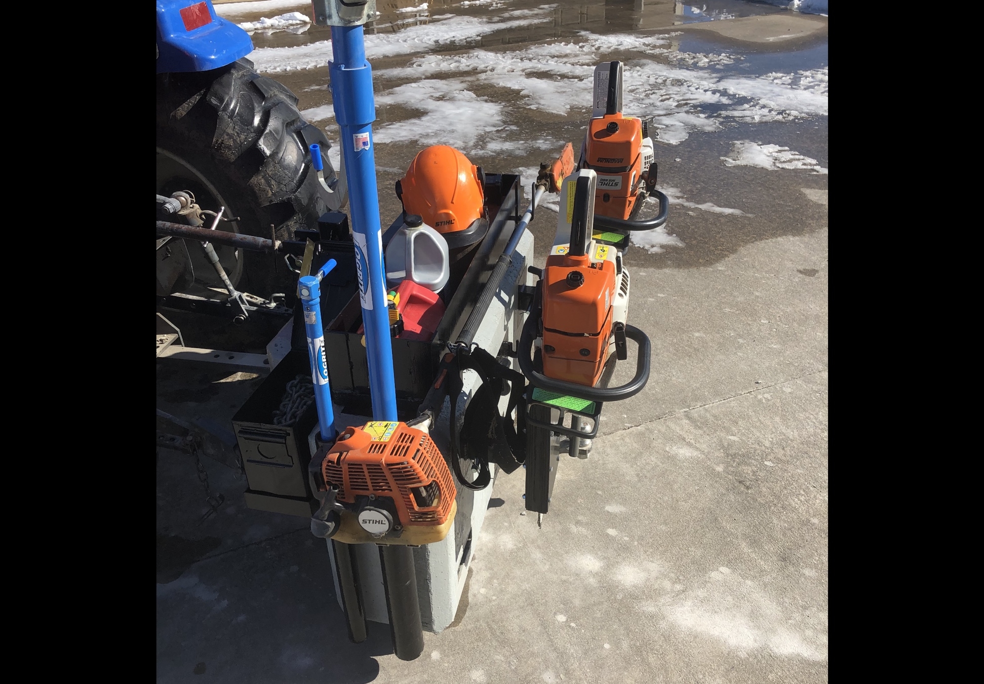

I made mine using concrete with attachments to carry my chainsaws and other tools. It was sized to weigh 1600 lbs.
I think you win the ballast wars. That looks so good, I feel like making one and getting rid of my box of sand.
What are those things on the back?
I don't have any idea how much weight I need for a Kubota L3710. When I got my box, I filled it with sand and figured it would have to work.

They are for holding chainsaws.
Here is the thread I did on it.

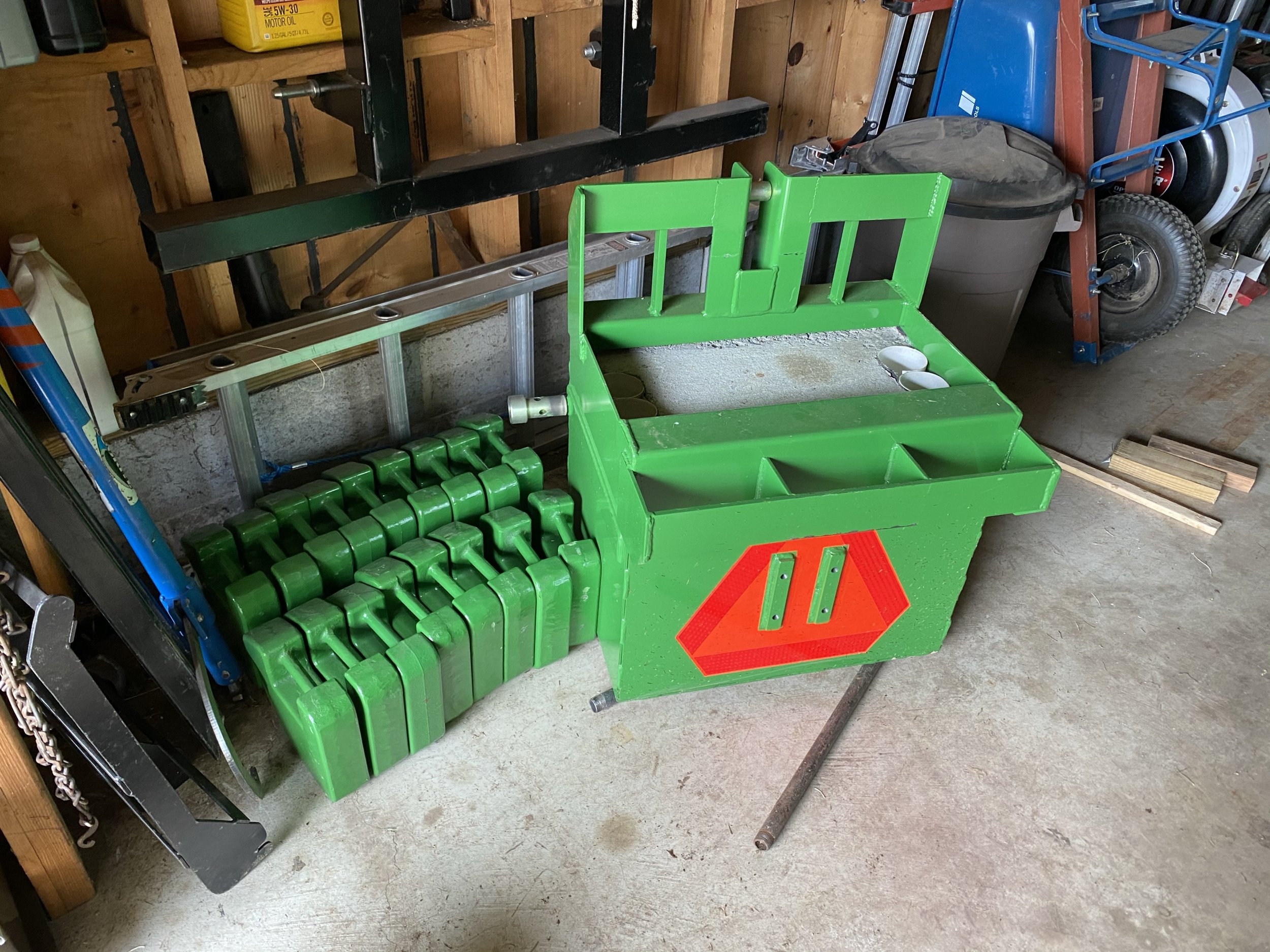

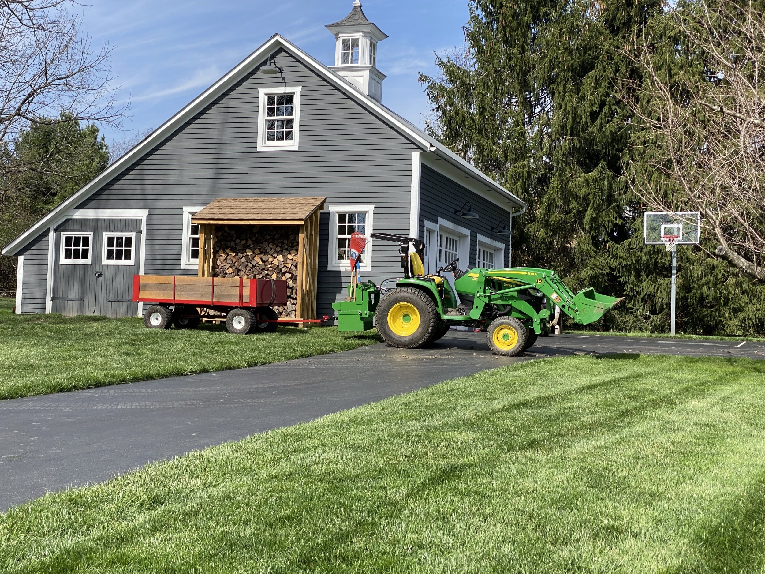

Adding to what others have already said:
  1. Steel weighs more than concrete, so if you want the absolutely smallest footprint, you know which way to go.
  2. A tool carrier is priceless. Like inpo44, mine has tubes for carrying rakes and shovels, which I use constantly. I also have a tray on top for carrying chains, saws, gloves, other stuff.
  3. Adjustable weight is ideal. I have a fixed 750 lb. of concrete in a steel box, but bars mounted above and aft to carry an additional 17 suitcase weights. Those suitcases can be the 42 or 70 lb. variety, meaning I can vary the weight of my box from 750 lb. all the way up to 2000 lb., although I might start to worry about the welds on the lower link pins at the top of that range. I usually use it between 750 and 1500 lb., for my needs.
  4. A hitch receiver on the back of your box is mandatory, IMO. You don't want to have to ditch the ballast to pull a trailer, in fact that's often when it's most useful. This has the added advantage of shifting your hitch farther aft of your rear axle, which provides better maneuverability when backing trailers, especially steerable-axle farm wagons. I just welded a pair of 1" x 1/2" steel bars to the back of mine and tapped 1/2" UNF, to bolt on a surface-mount hitch receiver, quickly removable when I want it out of my way.

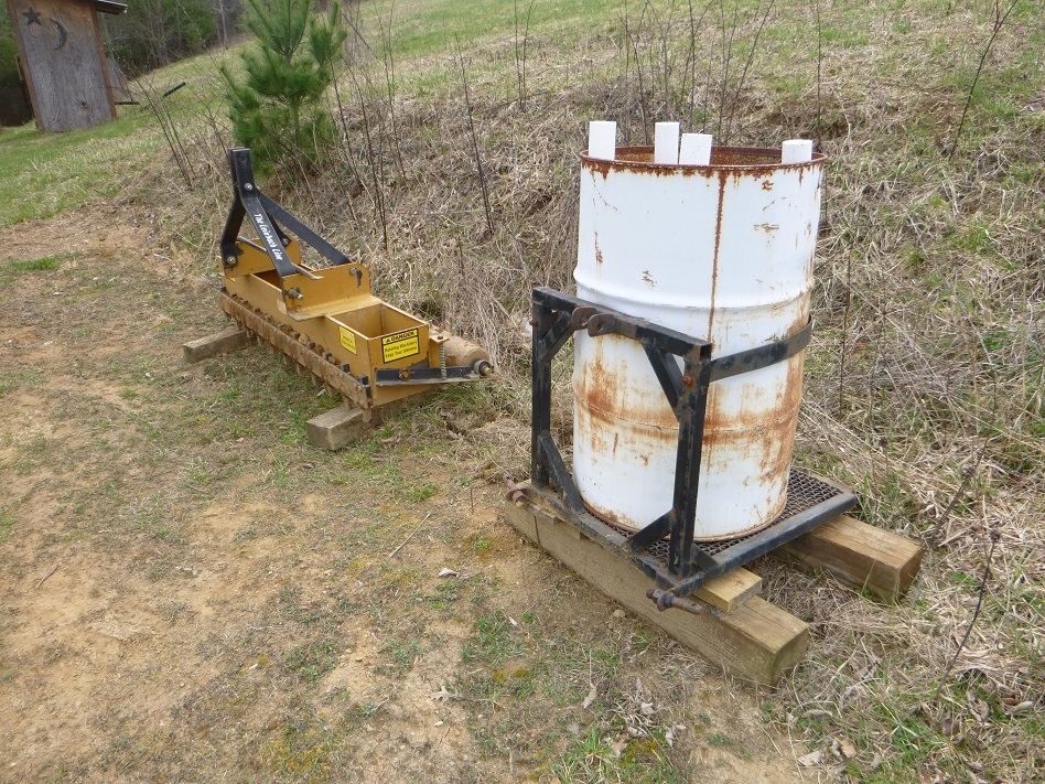

I used a 55 gallon drum, Set it away from your tractor will give you more counter balance to the FEL. Friend had several bags of harden concrete bags that he wanted to get rid of. Broke them up and dumped them in... Old photo but I've since removed the pipes (or rain collectors as I called them and filled it to the top and placed a Manhole cover on top of it. Fit like a glove.
About 800 to 900 pounds, Manhole cover felt like 100 by itself!!
