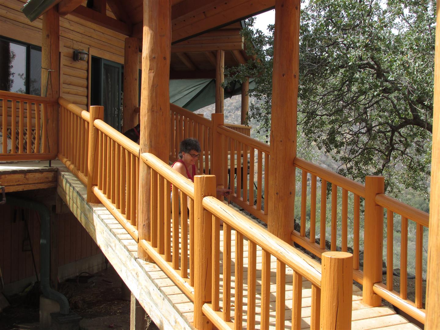

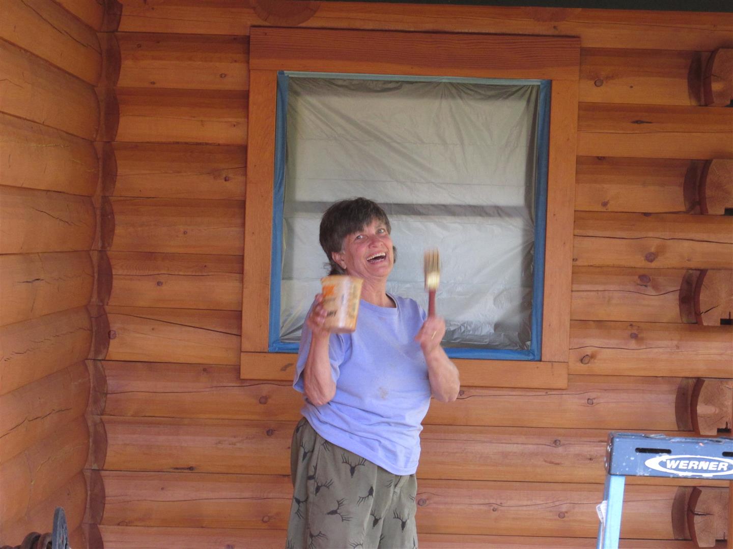

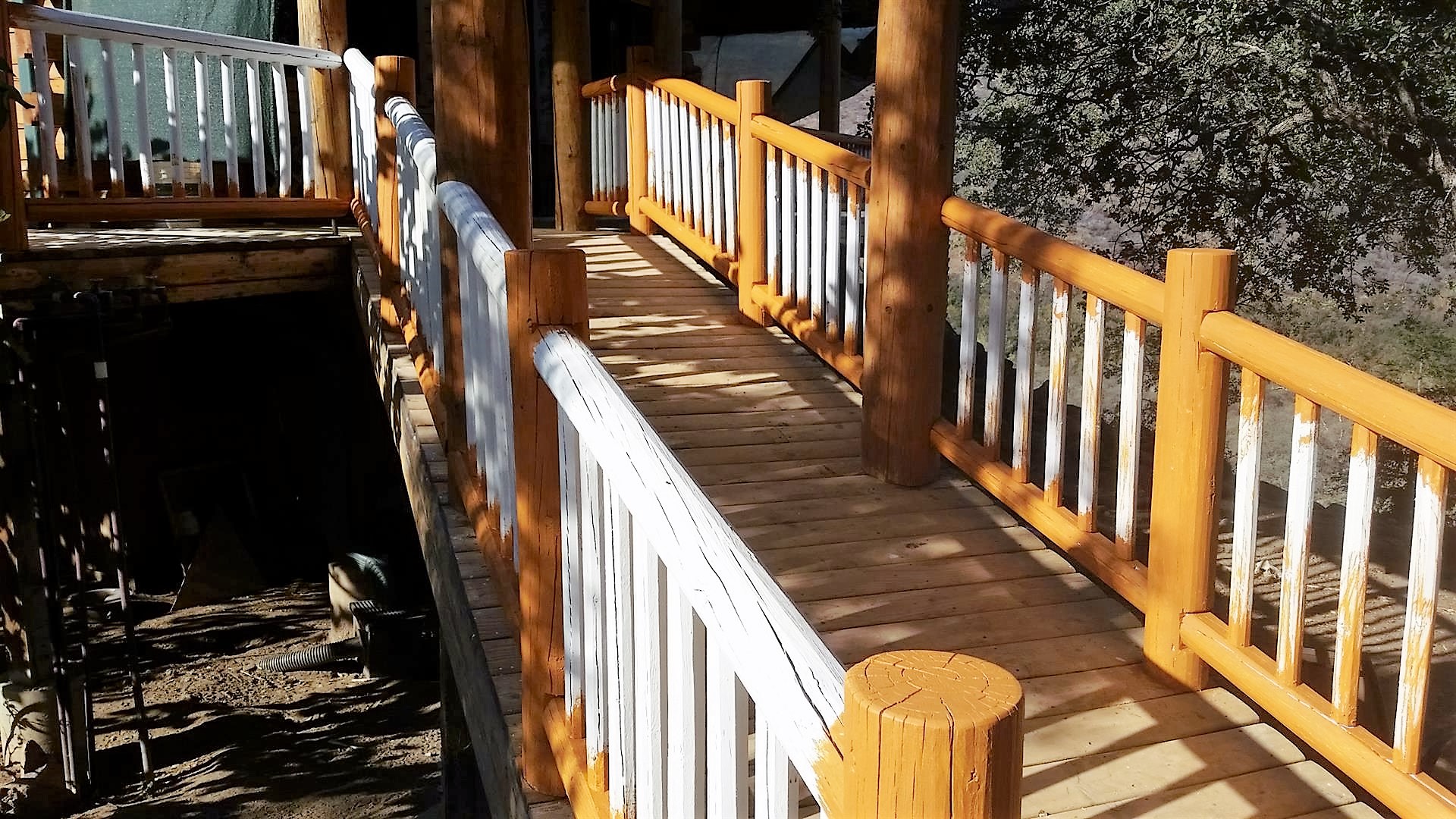

We are in the middle of refinishing our wrap-around deck, all the railing around, and the logs on the home and garage. She is still working full time from home, telecommuting so no driving to work or anything like that. And yes, she still helps me on the weekends with all our projects.

The bottom logs seem to endure more rain and sun the other more shaded logs. From what I know now, it would be nothing to go around and hand paint them maybe every 5 years, or when weathering shows up with either more stain/sealer combo (Capture), and then a coat of clear coat sealer (Cascade). That is the system they use out here. It's a Shashco water based product. Exterior Stains for Log Homes | Twin Creeks Log Home Supply - Water-Based - Sashco Sealants and Stains | Twin Creeks Log Home Supply When the sheen starts to disappear it's time for a light coat of clear coat Casscade lightly and no back brushing is necessary. Some guys also add a coat of stain/sealer Capture first if they think it needs it, again lightly with no back brushing. Doing so will prevent real wear like on my home which now requires sanding all those badly worn logs ... a ton of work! Had I known the signs when to add refinish instead letting the finish curl up and disappear, the difference in work saved would have been immense.
Make sure that the initial coat is applied as much as the wood will soak up. The ends will take more than the sanded sides of the logs. That is important so that the logs are saturated with stain/sealer making them most resistant to water logging and sun and wind wear. Apply that first coat heavy and back brush into the wood, and add a little more with the brush if it soaks in right away. Wait a day between coats, then add a second coat lightly, and only back brush any runs. Otherwise, there is no back brushing required if the second (and 3rd) coat is applied moderately. What you spend on a little more product up front will pay dividends when other buiders are replacing entire logs on their homes where they skimped on the stain/sealer and clear coat applications!
As far as log settling, I had the builder do the adjustments about 2 or 3 years ago (no charge). Perhaps you remember that all the main posts (which don't settle) have screw posts and nuts for doing that adjustment. You can tell when it's time when some doors become harder to close properly. Another thing to look for is when installing rain gutters, take into account that the logs will settle and the posts supporting the rest or the exterior deck roof will not. Figure 1 to 2 inches. Now I have a couple of gutters that are lower at the closed end instead of the drain end. I'm also having to fix that as well!
