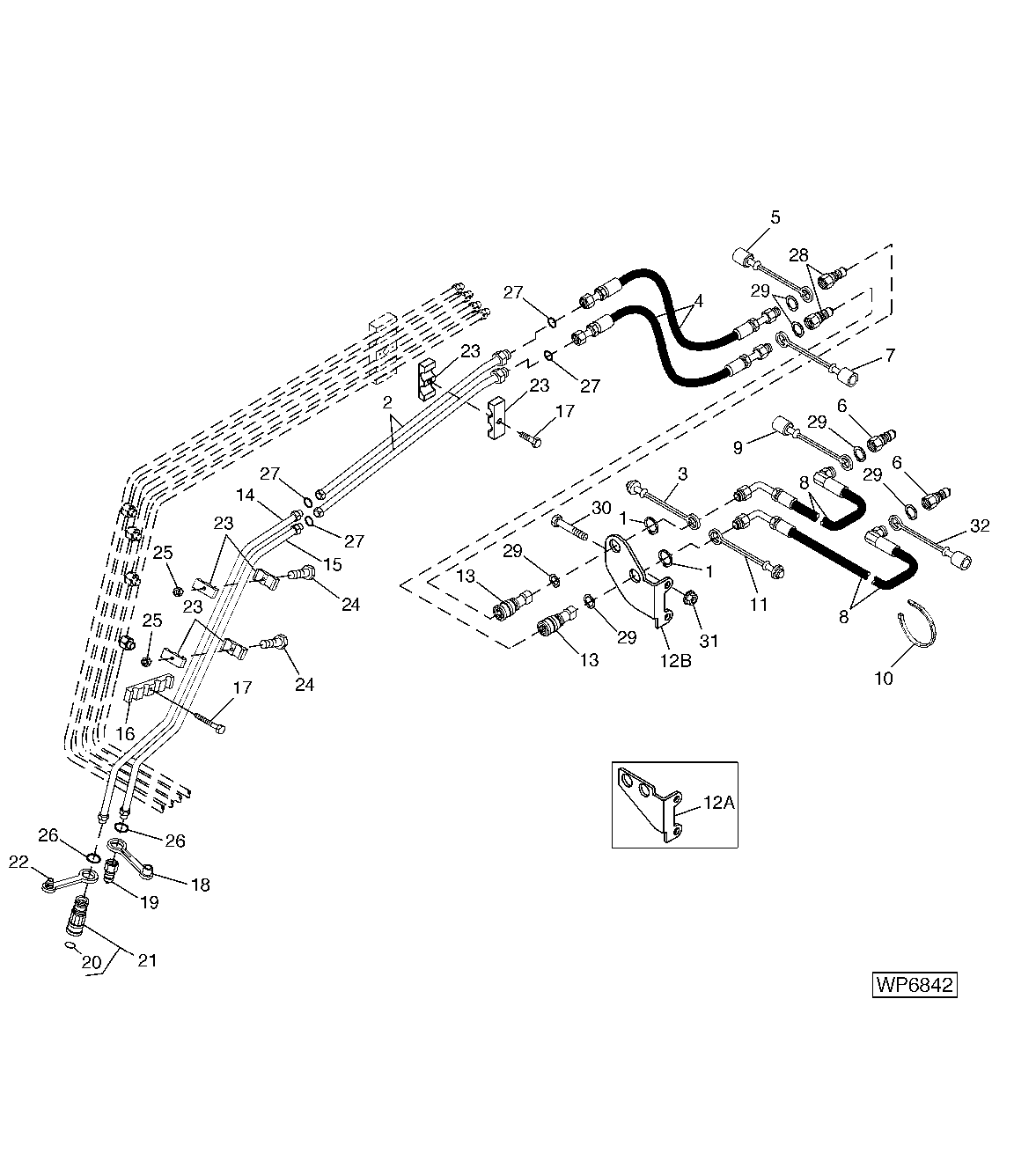

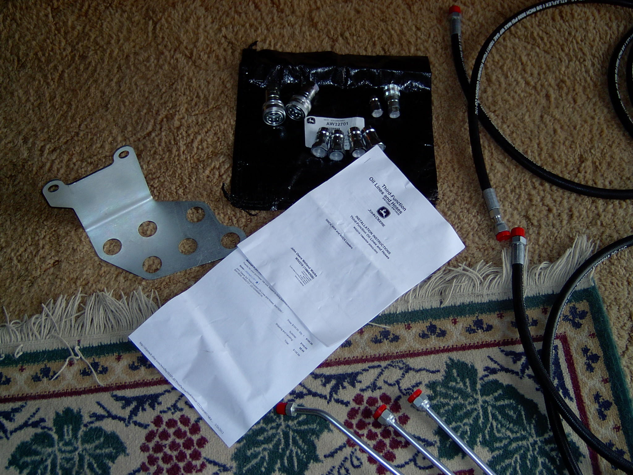

I thinking of adding the 3 function hydraulics to my 300cx loader. Where do the lines hook to to get hydraulic fluid? I don't have the diverter valve hookup, but I have the third scv in the rear. Do I run the lines to that? The parts break down from JD don't show where to hook to.
/ 3RD function loader lines #2
Yes, It goes to the rear. What you get is 2 hoses that get you to the connection point of the other 4 loader hose quick connects. You get another bracket that will accomodate 6 quick connects instead of 4.

Yes, the lines go to the rear couplers for the 3rd SCV.
Here is what you get in the JD kit:
HYDRAULIC HOSES AND OIL TUBES - THIRD FUNCTION (300CX)
Cart key PART NO. PART NAME QTY SERIAL NO. 300 300X 300CX REMARKS
1 M42702 Snap Ring 2 X
2 AW32609 Line 2 X
3 W45635 Plug 1 X (A) (C)
...... Plug 1 X (B) (C) (ORD AW28043)
4 AW30147 Hydraulic Hose 2 X 3/4" X 1800 mm (70-3/4") X 17.4752"

I see now. The lines that go under are roughly 5 feet long. They should reach to the back scv. Thanks guys for the help. I'll get the kit ordered.

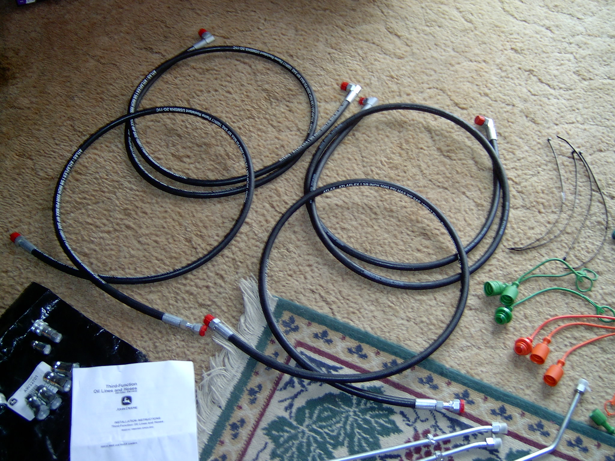

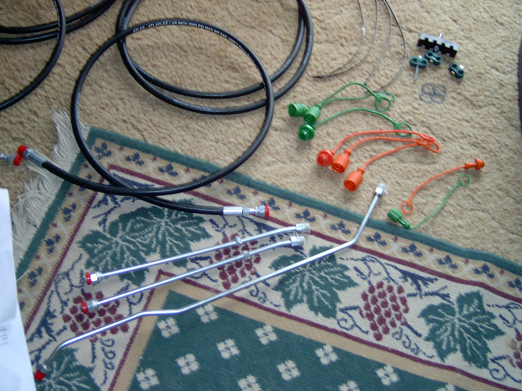

I found a complete kit on ebay for a 400cx loader for $100.00. I crossed referenced the part numbers for a 300cx kit and the only thing I found to be different was the hose bracket and a couple of colored hose plugs. The kit was brand new. I went ahead and bought it. Should be here Monday.
/ 3RD function loader lines #9
Whoa...! That's a real score! Hope it's all there.
AKfish
Me too. From the pics he had posted it looked to be.
#11
Got the kit today. It's brand new. The only thing that is missing is one of the metal oil lines. $39 from my dealer. The hose bracket is for a 400cx loader. I'm going to see if my dealer will switch to the 300cx one.3rd function (1).JPG3rd function (2).JPG3rd function (3).JPG3rd function (4).JPG All in all I think I did pretty good for $108.

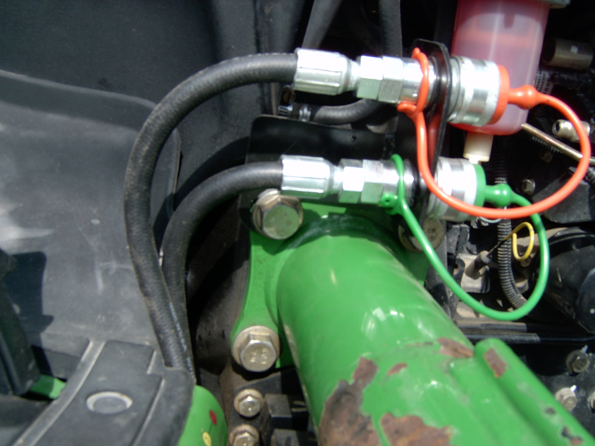

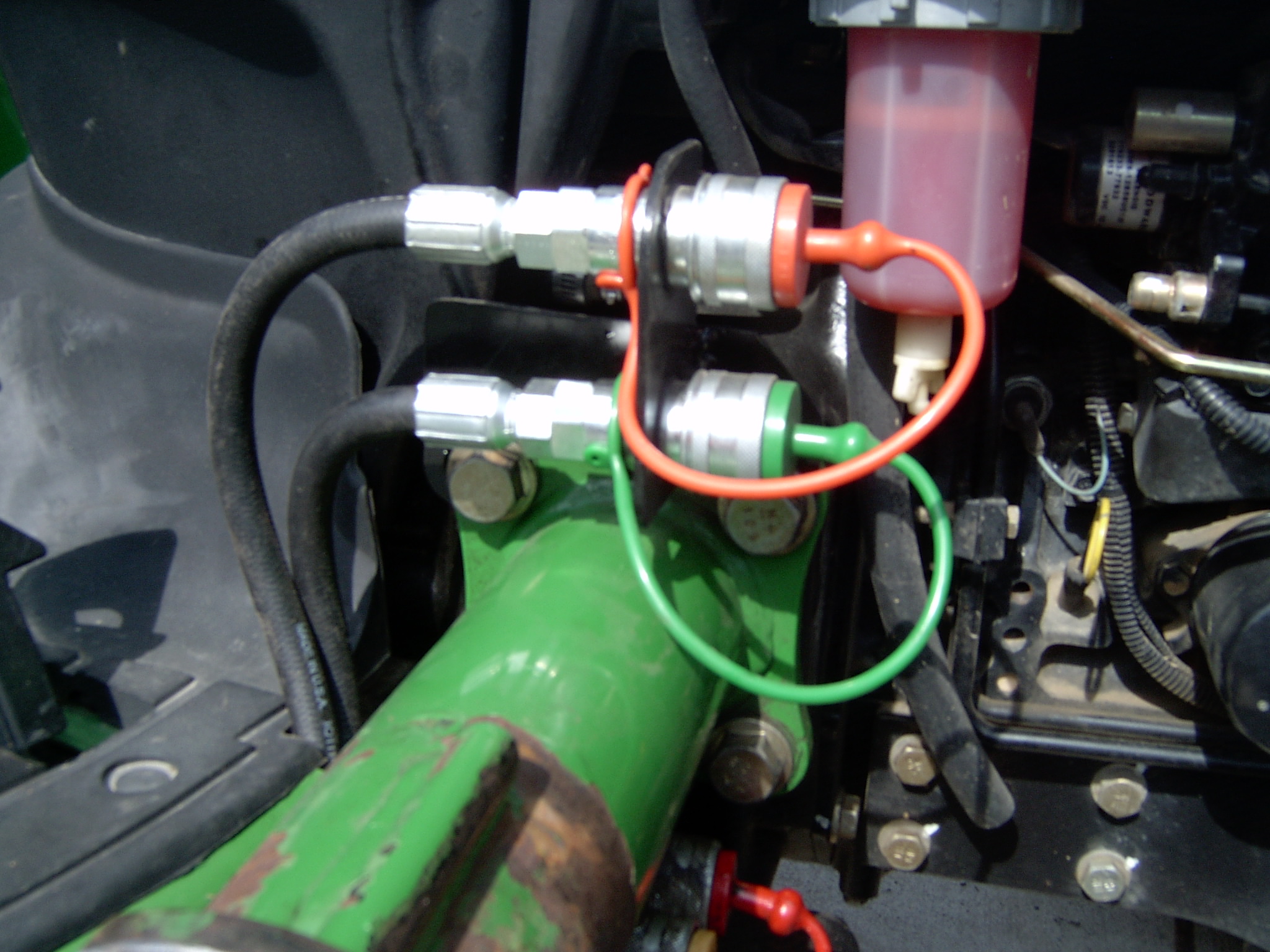

Got kit installed yesterday. Picked up the oil line that was missing at my dealer. Everything went together good. I cut and rewelded the hose bracket to clear the loader mounting bolts instead of switching. 3rd function 001.JPG3rd function 002.JPG
