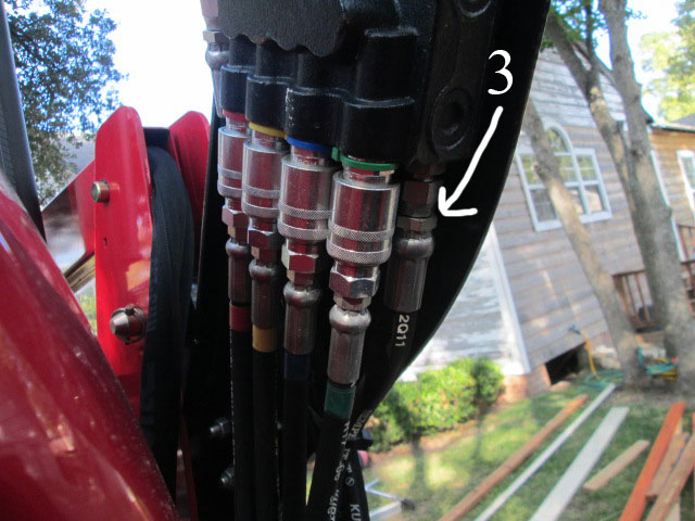

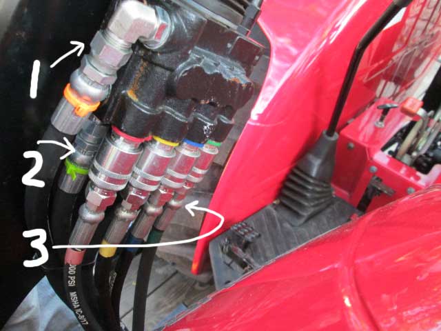

I need help identifying my PB line. There is no documentation to that level that came with the papers. There are three 1/2" lines going to the loader valve. I think I have identified the right one but I can't be sure. Here are some pics showing the lines and my mount option.
I think line 1 is the PB. I cannot tell of the other two which is pressure and which is return. I just don't know enough about hydraulics yet to use the clues of proximity. There is not writing on the valve either. There is another port that is sealed with a hex wrench plug. Is that something I can use?

/ 3rd Function on Mahindra 4350 #7

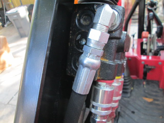

It looks like you have 7 hoses, so you apparently have PB.
Can you remove the fitting from the side of the valve, the one with the 90 degree fitting and look inside the port for a hex screw?
The other way to tell where the PB flow/main flow is to loosen a fitting, and if it leaks with all levers in neutral, that is the PB port.
You can also follow the hose back to the remote or 3pt
All return hoses go to tank and may have tees in it.

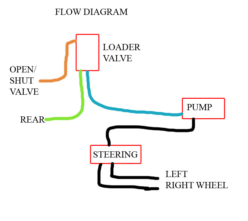

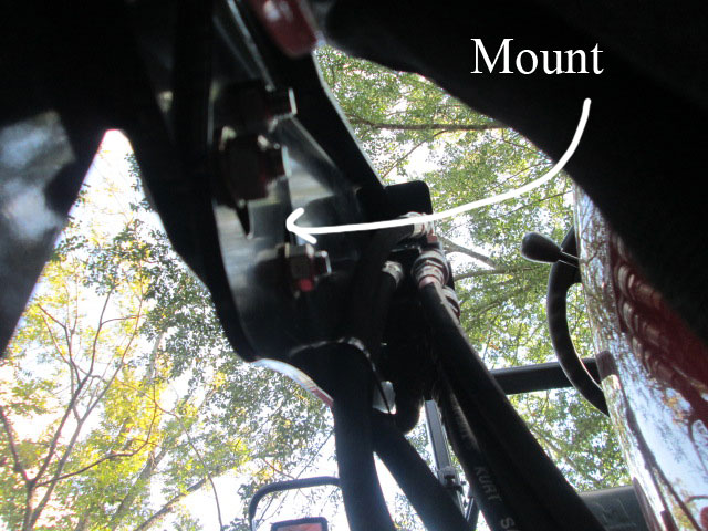

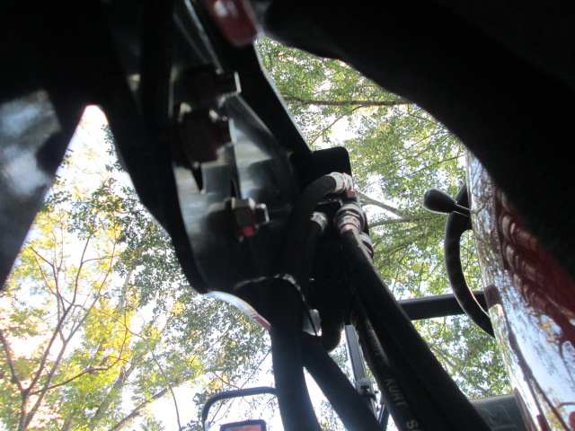

So here I am now...learning. I didn't want to make any modifications until I had a better understanding of the system. After all, I don't want to pay someone to fix my mistakes. I spent about an hour removing plates and following and marking lines. Here is what I have:
This is the same picture as before but now with handy dandy color coded zip ties. I have drawn a rudimentary diagram. I did not show flow direction since I don't really know which is going where or if with double acting cylinders if the flow changes.
I could only see two lines leaving the pump. One went to the steering column and the split to the front wheel cylinders. No brainer on that one.
The second line (marked as blue and numbered 3) goes into the loader valve. So does that mean that is the pressure line from the pump?
From the loader valve there are two remaining hoses that are contenders for the PB line. The green line (#2) goes straight to the rear of the tractor. The orange line (#1) goes to an open/shut valve also located at the rear of the tractor. According to Mahindra this valve is there to keep a three point attachment from accidentally moving if you are going long distances with the implement up.
I did the leak test on the #1 orange line as instructed. With the tractor running and the loader on the ground I loosened the fitting. Almost immediately fluid was being pushed out.
/ 3rd Function on Mahindra 4350 #10
Number three is the INPUT from the pump as the relief valve is just above it.
You can also verify which line is the OUT/return by loosen or remove the hose from that port.
With PB installed, the internal valve chambers are divided so the main flow, flows on to the next valve.
The OUT port will only have fluid flowing when a cyl is being used. No cyl movement, no flow.
All OUT flows from a valve should be open to tank with no restriction.
The descent knob is use to set the 3pt lowering rate and to keep the 3pt secure for transport .
One other way to positively check the main hyd flow via the PB adapter is to install a tee and a 3000 psi gage in the PB line..
If that is the PB line, when you raise the 3pt to relief pressure, the gage will read that pressure.

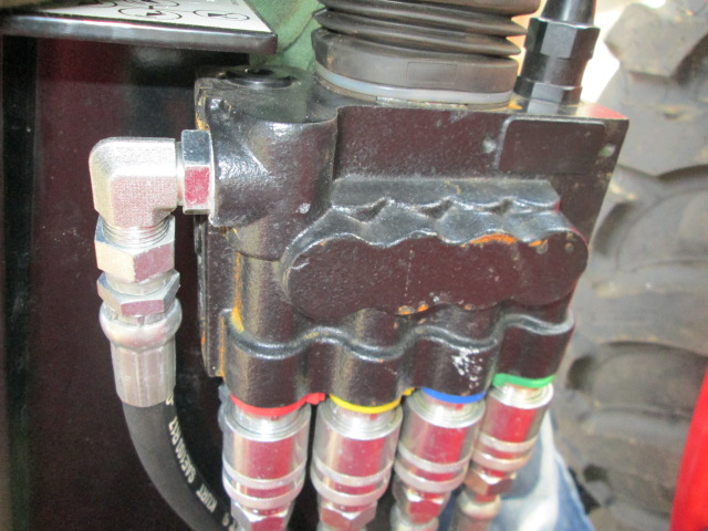

So to clarify...since I had fluid flow when I loosened the fitting, it does indicate PB since no cylinders were engaged at the time?
Understanding how the valve is designed helps too. It looks like the #1 is last in line of the valve chambers. PB is last priority in the valve right?
Does the descent knob indicate PB? In other words, in order for it to function does it need to be set in line between the 3pt and the pressure send?
If this line is indeed the PB what is the other line that also goes directly to the rear?
Sorry if these questions are simple... but so is my understanding at this point. I appreciate your experience and feedback. Thank you.
I really wish the machine came with more detailed construction diagrams and info, but perhaps those are reserved for the mechanics and engineers.
/ 3rd Function on Mahindra 4350 #12
One of those lines is the return line to sump/tank.
To test that, loosen or remove the line #2 at the rear and there should be no fluid flowing unless a cyl is moving.
