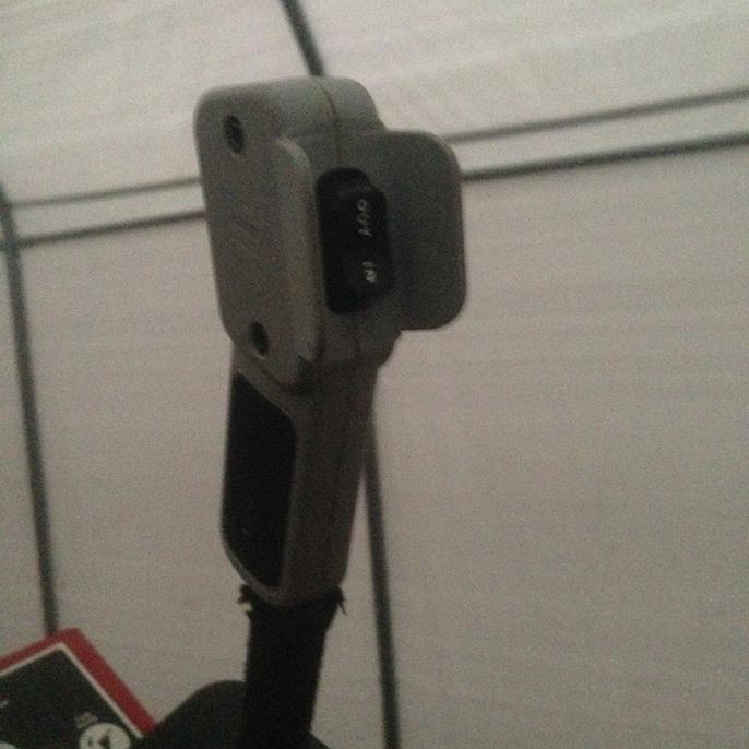

Did you run the new lines with the loader lines? That was tight, huh? What are you using to control the valve? I modified a winch control for mine:
