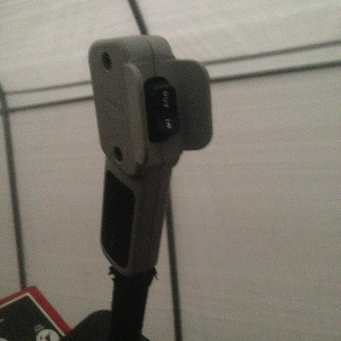

Ok, I have all parts in hand or on order. I have the valve mounted and the connecting hoses ran. I am compiling pictures to document my install on a different thread. I do have a question. When I put the new lines in do I have to bleed the air out of the hoses or will that be pushed out and released within the circuit somehow?
   / 3rd Function on Mahindra 4350 #56
That will bleed out on its own as you run the cylinders through their motions. It may seem kind of notchy at first, at least mine did, but it shouldn't take long to get back to normal after a few cycles. The pump is getting a constant supply of fluid so it will push out any air. I took a few pictures with my phone the other night of my set up but they came out horrible so I never posted them.
Did you run the new lines with the loader lines? That was tight, huh? What are you using to control the valve? I modified a winch control for mine:

I have not run the long lines to the loader yet. They are on order. If I bought them locally I'd have to mortgage my home. Hydraulic prices are ridiculous.
I am not running mine through the loader on the same side. I am running them through the other side. I installed my valve under the dash behind the detachable kickplate. You cannot even tell I did anything. Its all hidden. I love it. I want a smooth factory looking install. No lines or valves strangely attached to things. When I get it finished I am going to document it in a new thread. Everyone is asking the same questions and I hope my experience will help others who had the same questions I had.
I haven't decided on a control yet but I know I won't be buying one...again ridiculous. Its just a SPDT momentary rocker switch mounted in a handle. I am all for people making money on their items but it seems a bit steep. Right now I am considering buying an oversized automotive shifter knob and mounting the switch in it.
