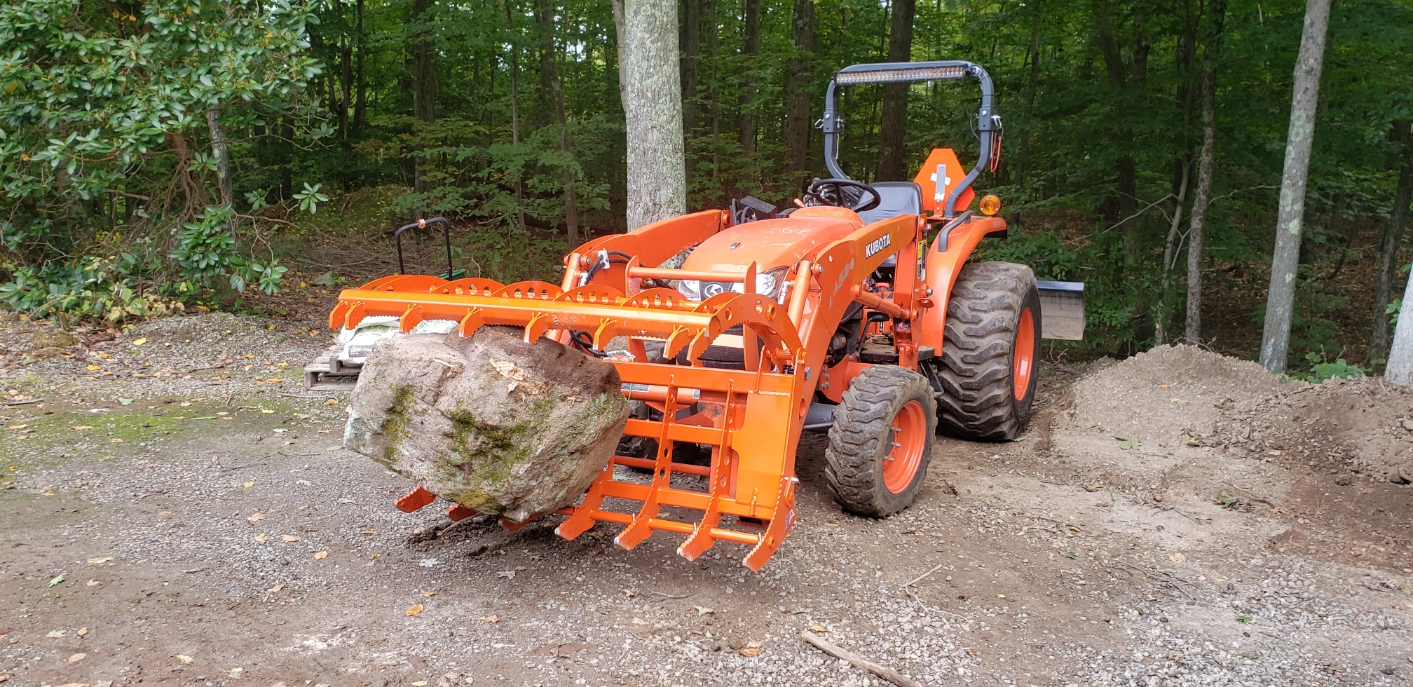

Grapple came in yesterday, really enjoying learning what it can do and how to do it!
Jstpssng, this is my first grapple, I do think it’s a diverter valve now that I have it, like yours I can’t do some of the functions at the same time.
Mike
   / 3rd function valve cost #15

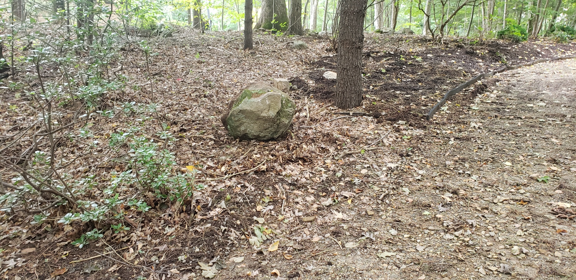

My grapple also came in yesterday :) I use the 3rd rear remote that I plumbed to the front. I can use the lift and curl functions of the fel at the same time as opening and closing the grapple. Going to take practice. I did 'harvest' a landscape feature out of the woods this afternoon tho. Not really big but fun doing it.
