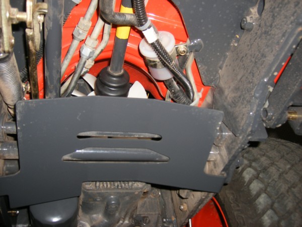

Honestly, if you're thinking of work in the woods, look carefully at the clearance of BX. The B gives you several more inches The BX also has a somewhat vulnerable transmission cooling fan located on the underside directly under the operators seat.

I'm aware of the vulnerable transmission fan once the MMM is removed. Read somewhere recently that Kubota has installed a protector plate on the newer BX's. My dealer confirmed this yesterday. Regardless, I intend to install complete undercarriage (slid) plates before either of us venture into the woods.
   / 3rd Function valve for BX2660/B2620 #9
This plate is standard on BX25 , but don't know about BX2660 ......
I bought one even though the MMM lives in situ . Cheap insurance
vs alot of labour
Since my wife retired, she has taken full control over our BX2660 and like you, we started out looking at the B as well which in the end was a no go. We bought a full set of Bro-Tek plates. While we have several other tractors, the BX is extremely stable and will get into places in our woods we can't get with the bigger tractors.
