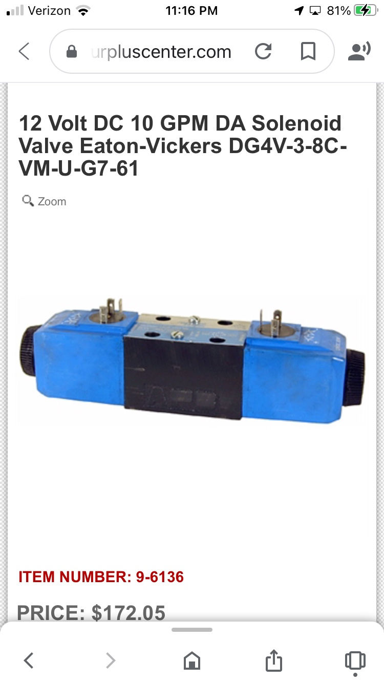

A valve like this will work i’m not saying this exact one, the main thing you need to know is if your hydraulic system is open center or closed center.

Ok.... thinking I need to build mine own system, I’ll have to find someone to do this as I haven’t he means, I was looking for a complete kit to attach into existing system and go from there!

I would recommended going with a summit universal 3rd function kit then all you will have to do is measure/have lines made and figure out where to mount the valve

Good luck with your search but I suggest a generic diverter kit. Those are pretty easy to configure. I used a DSV-62-08-12 selector valve on my John Deere with a handful of adapters and a momentary switch I was all in for less than $300.
