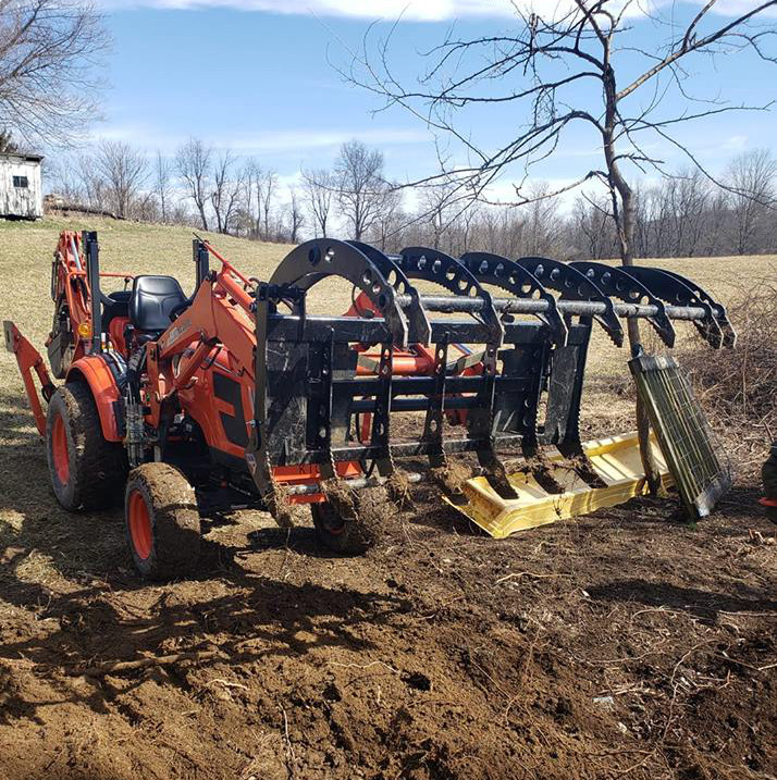

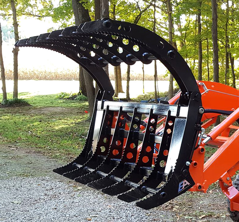

The WR Long kit for $895 installed sounds like a good price. We offer the same kit for $837 with $50 off if you order with a Wicked Grapple, but no installation(of course)!
Travis
Wicked 55 is just over 200 pounds!

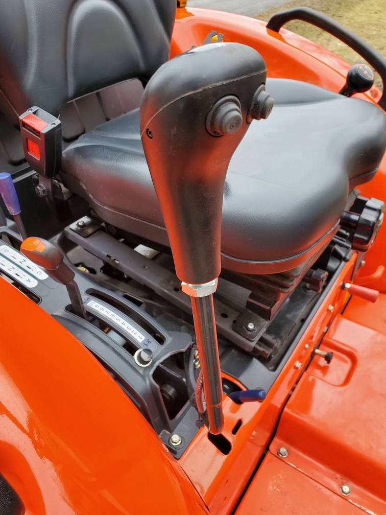

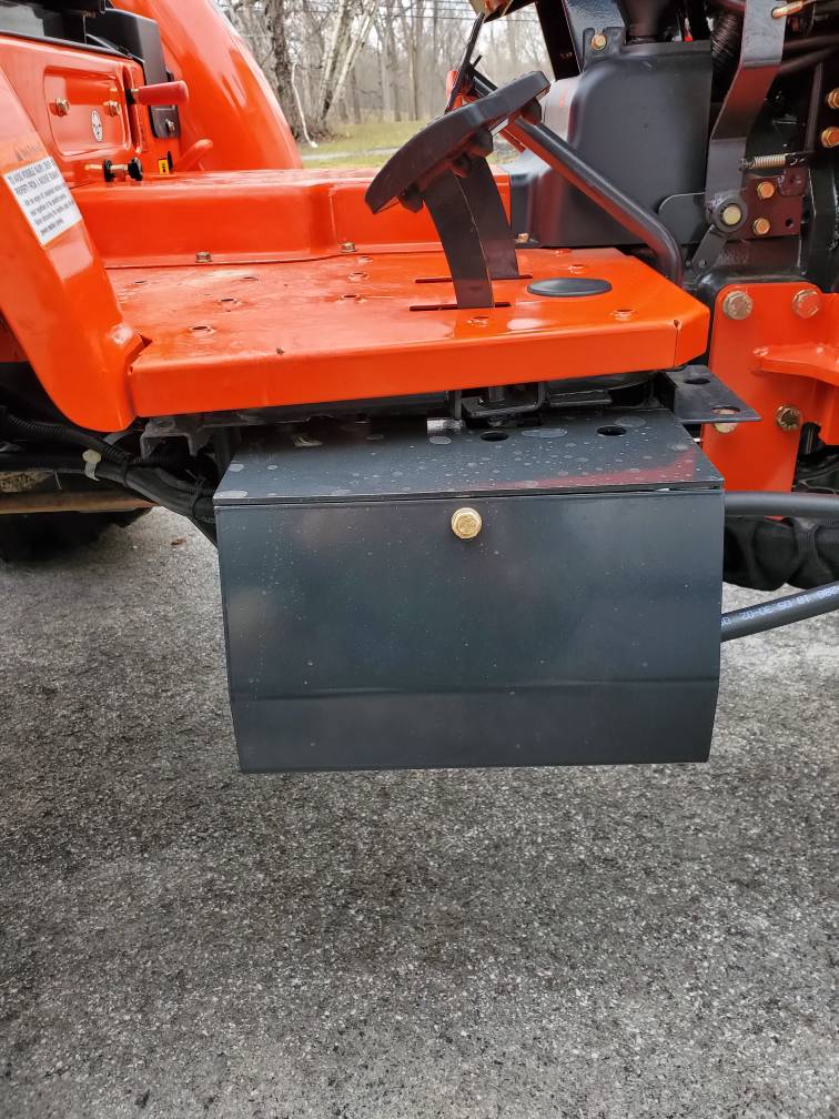

Not to take away from the WR Long kit (or Travis at EA because that IS a great price esp if you're getting a grapple anyway) - but depending on your preferences, free time, and abilities you might be able to build your own cheaper.
I was not a fan of the control stick or the solenoid mounting location of the WR Long kit so I did my own thing.
I also added a few little things that are not in the WR Long kit and came out at about the same price point, but what I learned in the process was invaluable.
I have attached my write up - it was never meant to be step by step directions but I wanted a little more detail that a couple pictures and a "Hey look what I did". If nothing else it will give you a rough idea on whether you want to tackle this or not.
As for grapples - I also highly recommend the Wicked Grapples. That Wicked 55 wasn't around when I got mine so I have the 50" Compact Wicked Root grapple (long bottom style).
Love it - stays on the tractor until I specifically need the bucket or pallet forks.
Now if I had it to do over and were able to pick between the two - it would be a hard choice, but either way you can't go wrong with a Wicked grapple.

One of your grapples is why I am getting the third function installed. Hopefully I will be ordering soon. Can I come pick it up? Your about 25 minutes from me.
Great to hear, sir!
Sure, you can come pick it up and check out our new facility.
Feel free to PM, call or email travis@everythingattachments.com for details.
You're gonna LOVE the Wicked 55!!
Travis

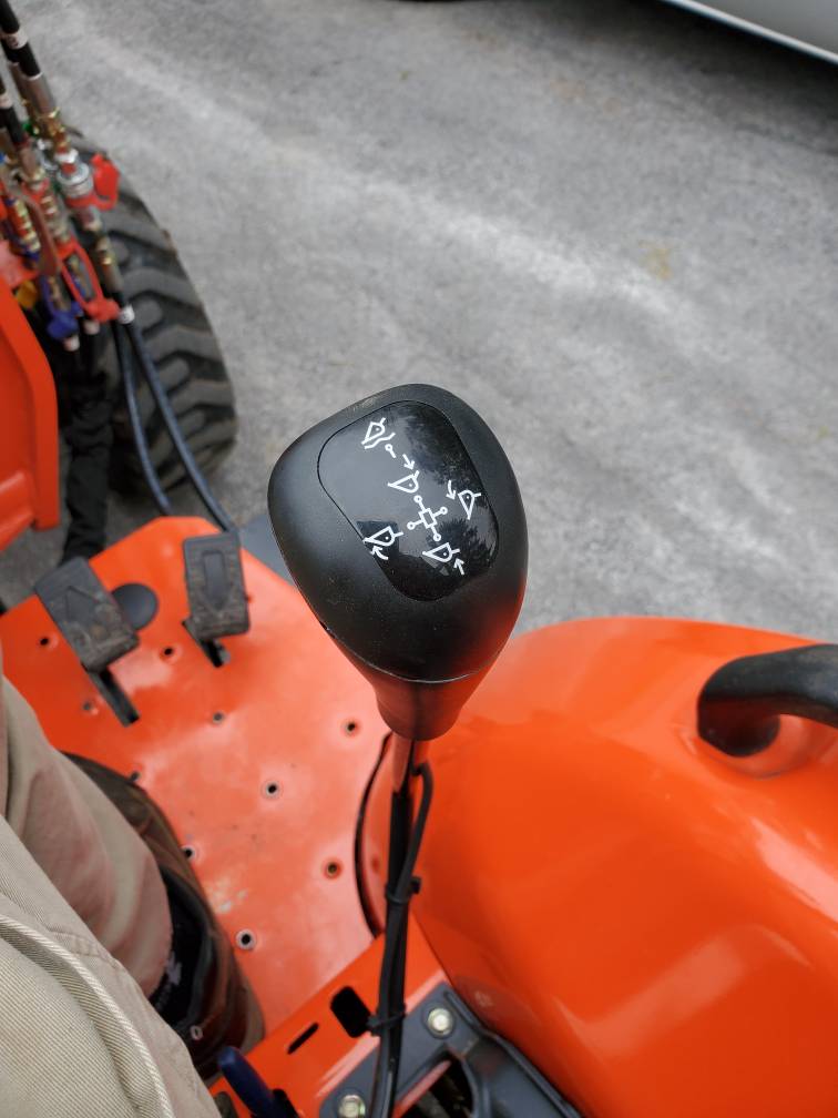

The 3rd function was $768 and the install was 3 hours. I had the dealer install 2 rear remotes which were $420.
My total with install for both was $1445.
I went with the Kioti brand because I liked the remote and also because it was Kioti brand so it was made for my FEL by the company that made the FEL.
