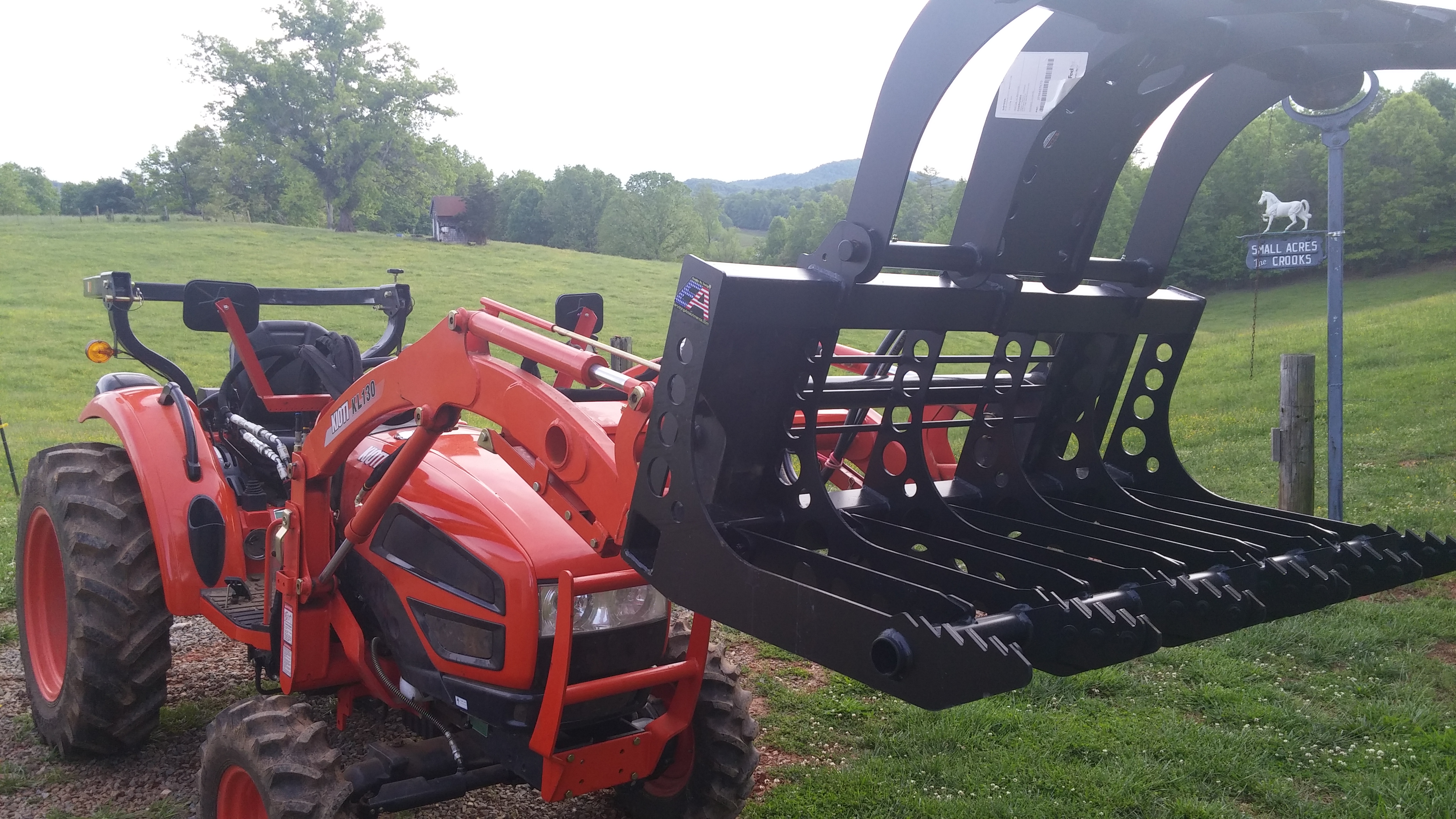

They did a nice job installing it, but the operation of the root grapple I got the valve for seems a little jerky, especially at higher RPMs. Maybe the tractor wasn't warmed up enough (I've had the tractor for only a couple days and haven't been able to use it much yet). Or maybe I need to feather the controls even more (will try that).
