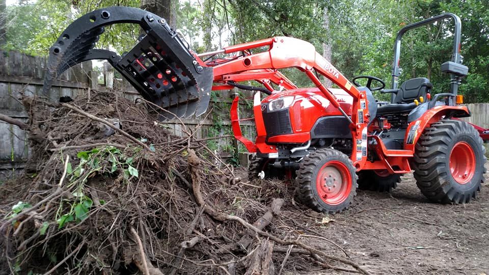

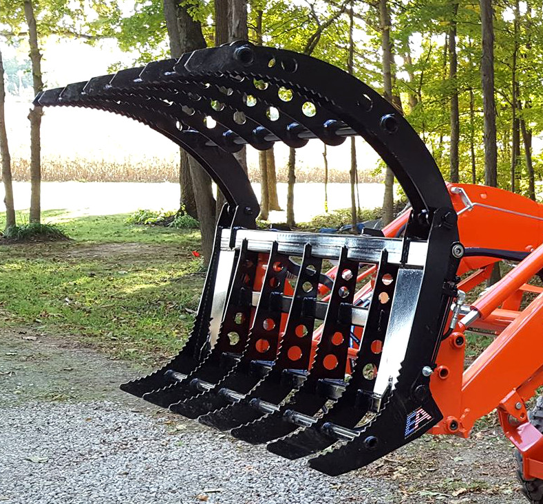

I've had guys tell me as little as 30-45 minutes up to a couple of hours installation at home for the custom WR Long 3rd Function Kit we offer. A dealer would probably say 3 hours or so.
$50 off if you order with the best B Series Grapple on the Planet; Incredibly strong, yet lightweight, 200 Pound Wicked 55!!

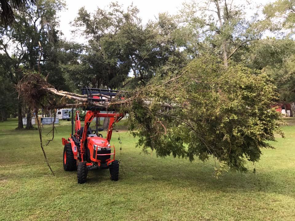

Stupid question, but other than a grapple, what attachments would I need this for?
I want to upgrade to a B2601 or B2650. Don't think I'd need the third function as I doubt I'll be getting a grapple, especially if I go with a B2601, but are there other really useful attachments I may want it for?
/ 3rd Function Valve #19
I think hydraulic adjust on a snowblower chute. Thumb on a FEL bucket. You can divert it to drive other things like a top and tilt, but really a rear remote kit is better for that. Best use though is that grapple.
/ 3rd Function Valve #20
I use mine for the "thumb" on my bucket and snow plow angle.Wouldn't be with-out it.Not enough flow to run any hydraulic motors;I.E. post hole digger,broom ect.
