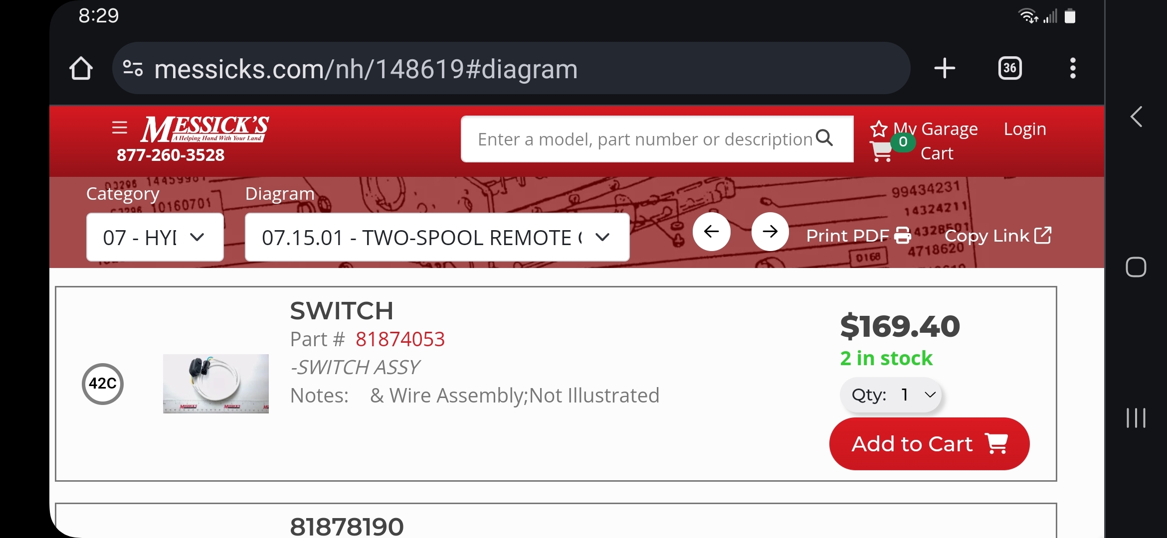

Now I wonder if NH in there infinite wisdom has just the replacement switch in the joystick. If anyone might have that part # I would be very grateful if you could supply it for me. Or if you could tell me what that switch would be called.

It's in the TC45 parts book under hydraulics under 2 spool remote deluxe joystick, but it's not illustrated.

Thank you! I stopped at a NH dealer today. Turns out NH didn't install it although it looks stock. On a quest to find a button small enough to fit. Still not sure if it is an on/off or momentary switch though. Wow that's pricy!,

Either way I can't see spending $170 for a simple switch. NH seems to be worse then Harley Davidson!:eek::eek:
