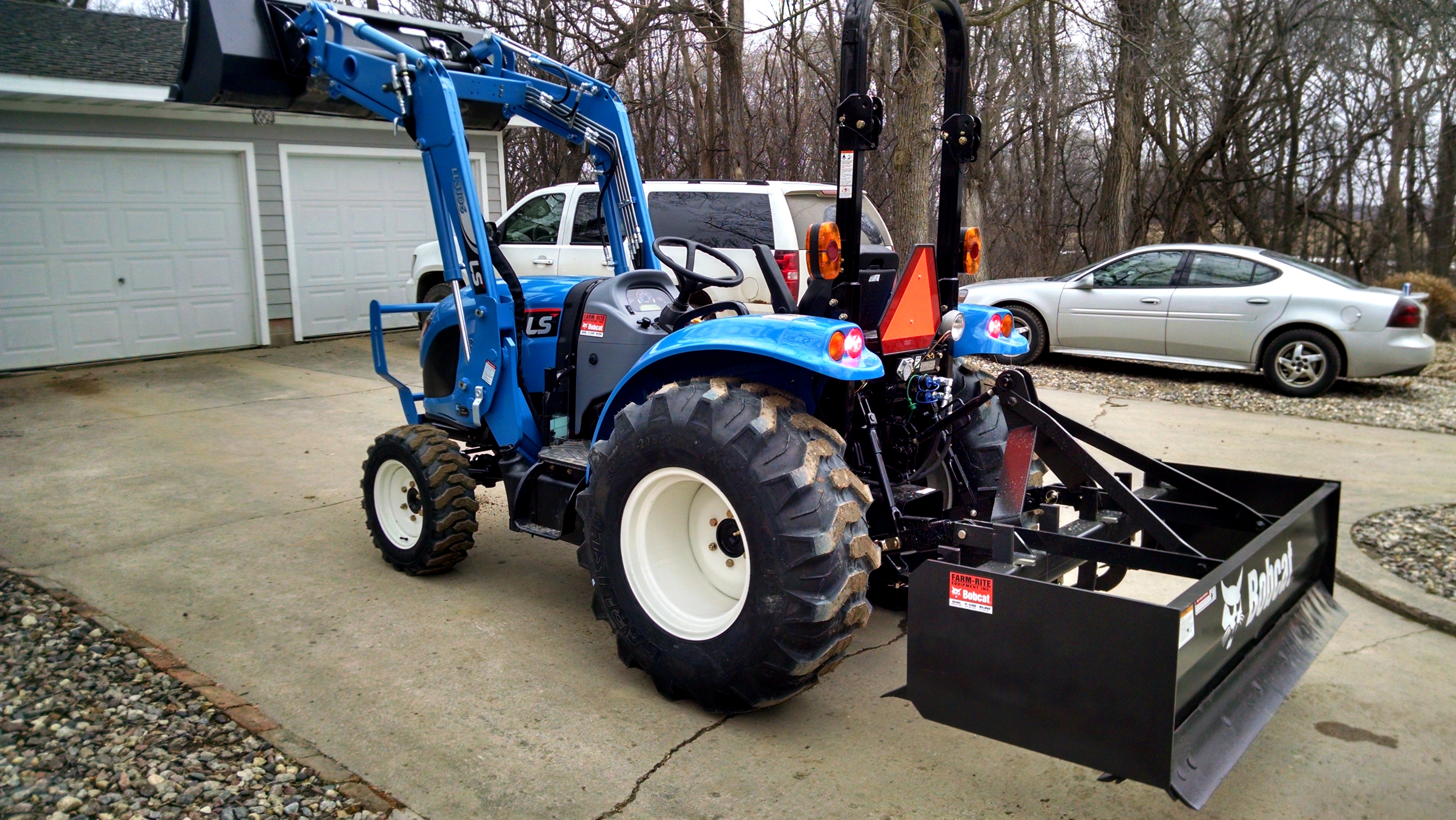

Been borrowing a friend's 5' box blade. Works pretty well for most of what I've used it for, except if I drop the teeth all the way down. That turns it into an anchor pretty much after about 2-3 feet of travel.
My owners manual says use 4' implements. Been looking at clist for deals on box blades and see a fair price for a bush hog brand 4' one. Wonder if I should down size or stay with the 5'? Seems like for just maintaining a gravel road or spreading loose dirt/gravel, the 5' would be more efficient. But if i want to tear up some ground, maybe I need the smaller width so I can actually pull it?
Or is dropping the teeth to lowest possible setting a bad practice in general and a 4' would anchor the tractor same way?
Also - how "tight" should the box blade be? Meaning I should adjust the stabilizers to allow how much lateral movement? Leaving them loose makes getting it on off simple since the lower arms clear the pins easily, but real easy to have it sway too far to one side. I can tighten it up enough that it feels pretty solid - can't shake it side-to-side but seems that might break something without any free play? No idea how it "should be".
I would look into heavying up your tractor to get traction for a 5' box. You could do it on a temporary basis if you dont want to load tires. -- Wheel weights and a load in the bucket.
Considering your location you might consider plain water in the tires. This would allow you to tailor ballast at whim. I do this on my Mahindra in VA. I only have to park it inside for 2 or 3 weeks a year because tubeless tires can handle light ice, from typical outdoor overnight exposure w/o damage.

he has loaded tires already... but that only adds 300 or so lbs...

One trick/tip to using a lighter box blade when cutting and moving material...is false starts...
... a lighter blade even set aggressively will not bite in like a heavier blade can...so by making a few false starts and reversing a little each time helps start an initial deeper cut...
Yeah. Didnt see that. Good point on limited benefit on small tires. I have about a ton of water in the mahindra AGs - all 4 filled.

I use a 6' box blade but rarely use the teeth. I have had gravel overflowing the box but that can only happen in 4WD, low range, good traction but will eventually stall me. Overall, pretty impressed with the ability to pull this. Have loaded tires also.
You are correct, it will not dig into grass at all. In fact, if it pulls up it tends to clog the whole thing up. This works great on dirt only. Fortunately, I have a tiller that I use for sod/pasture.

I dont think he posted it in this thread. But yeah... at 18 gallons per rear and 6 gallons for the front... there isnt much weight to be had there but I noticed huge gains in traction after loading mine. With the weight of the backhoe the tractor had plenty of traction but cant do everything with the backhoe on.
Wheel weights would be nice. Solid iron could add considerably more weight to the tractor
