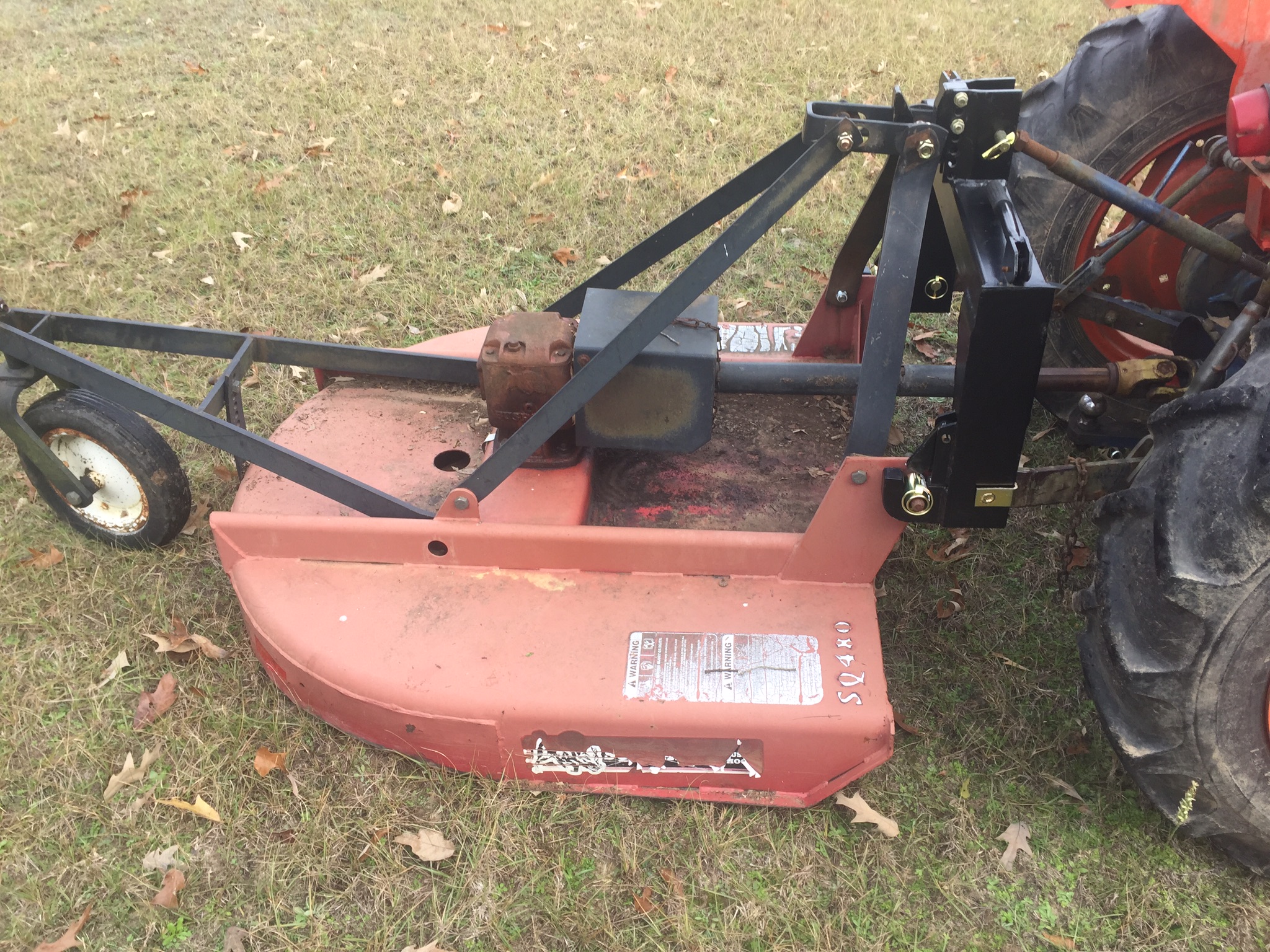

The thing about rotary cutters is you shouldn't have a rigid top link hookup. It needs to float. I have a Howse (not sure you can get this brand anymore) and the top link hookup has a slot allowing the top link to float. I got a top link quick hitch adapter and it works pretty slick.

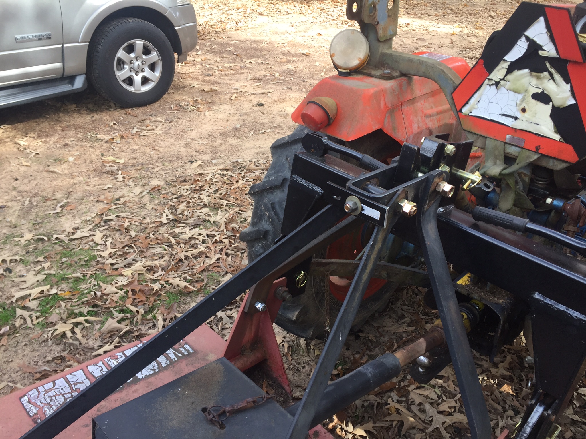

A closer look at the adapter hooked up to the top of the iMatch:

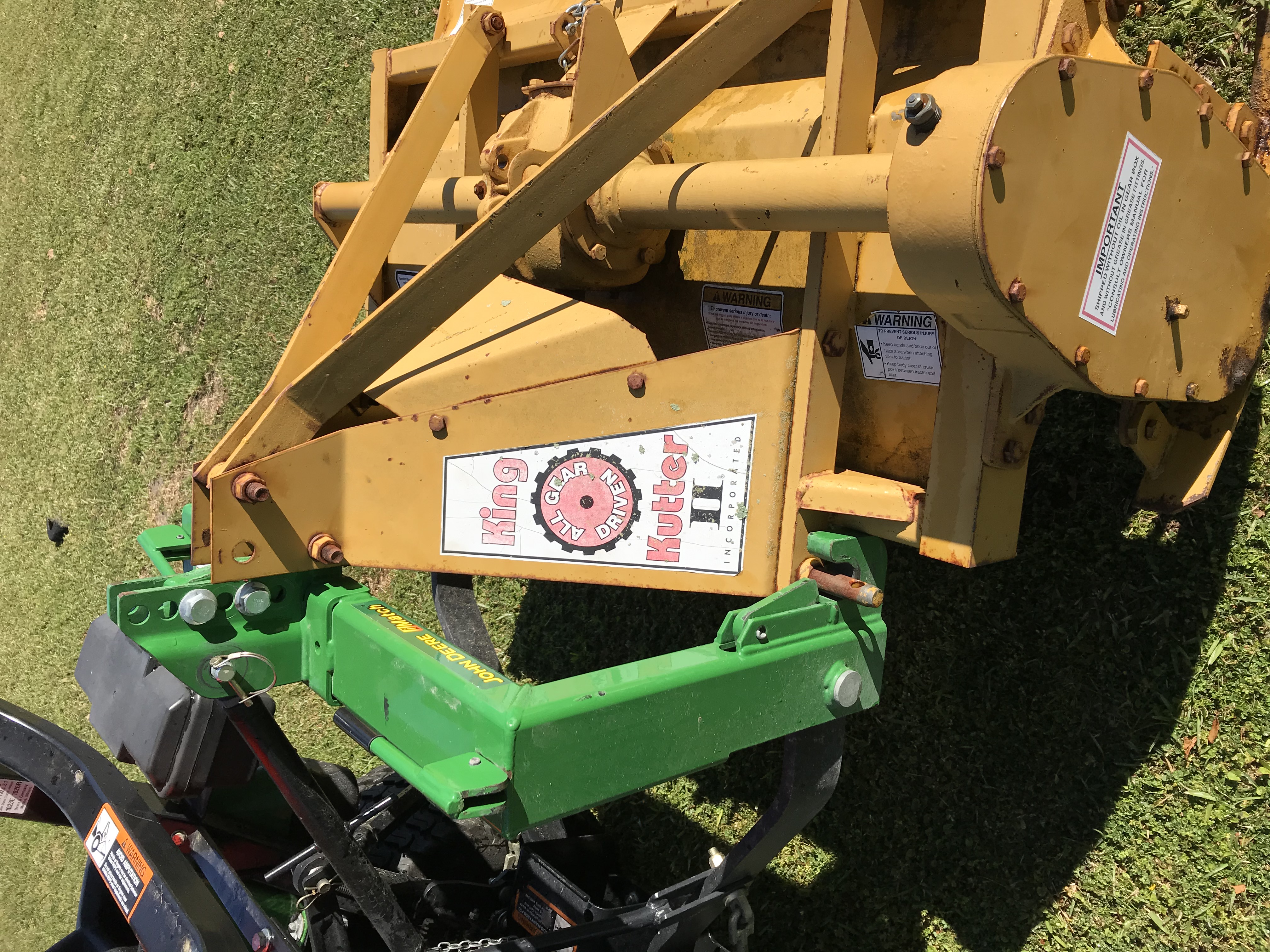

Bought a used King Kutter (TG-48-YK) today. It does hook up to the iMatch. I would like to have a manual for it. Willing to pay for one. I was not able to find one on the web. Kept getting I needed to add Google stuff? I assume the tiller has lost some of the gear oil. Looking to pick up a used Kodiak 4 Ft. brush cutter tomorrow. The newer promotions say the Kodiak is Quick Hitch compatible.
