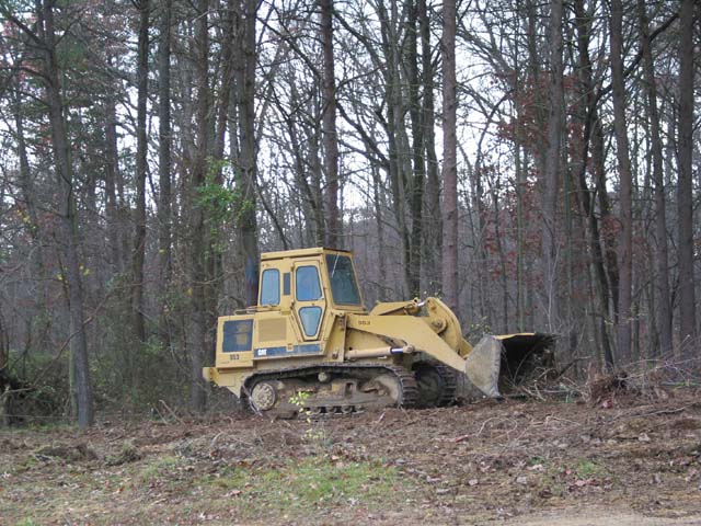

/ 4" Stump Removal #26
Re: 4\" Stump Removal
Recently, we were faced with the same dilemma. We needed 100 or so trees removed around our new house site and driveway entrance. Three quarters were pine up to 18 inches in diameter, the rest were oaks, poplar and birch up to 26 inches in diameter. I measured the larger pines and thought I could save the household some money by taking them out myself. The other species were out of the question. Past posts on this web site convinced me to hire a trackhoe ($80.00 per hour) and be done with it. The trackhoe worked for a day downing, moving stacking and sorting - the hardwoods are going to a sawmill. The trackhoe did not tear the ground up, and did in a day what would take me many weekends. The roots are gone and there were no broken tractor parts or accidents. A dozer should do the trick and should be cheaper. It was money well spent.
