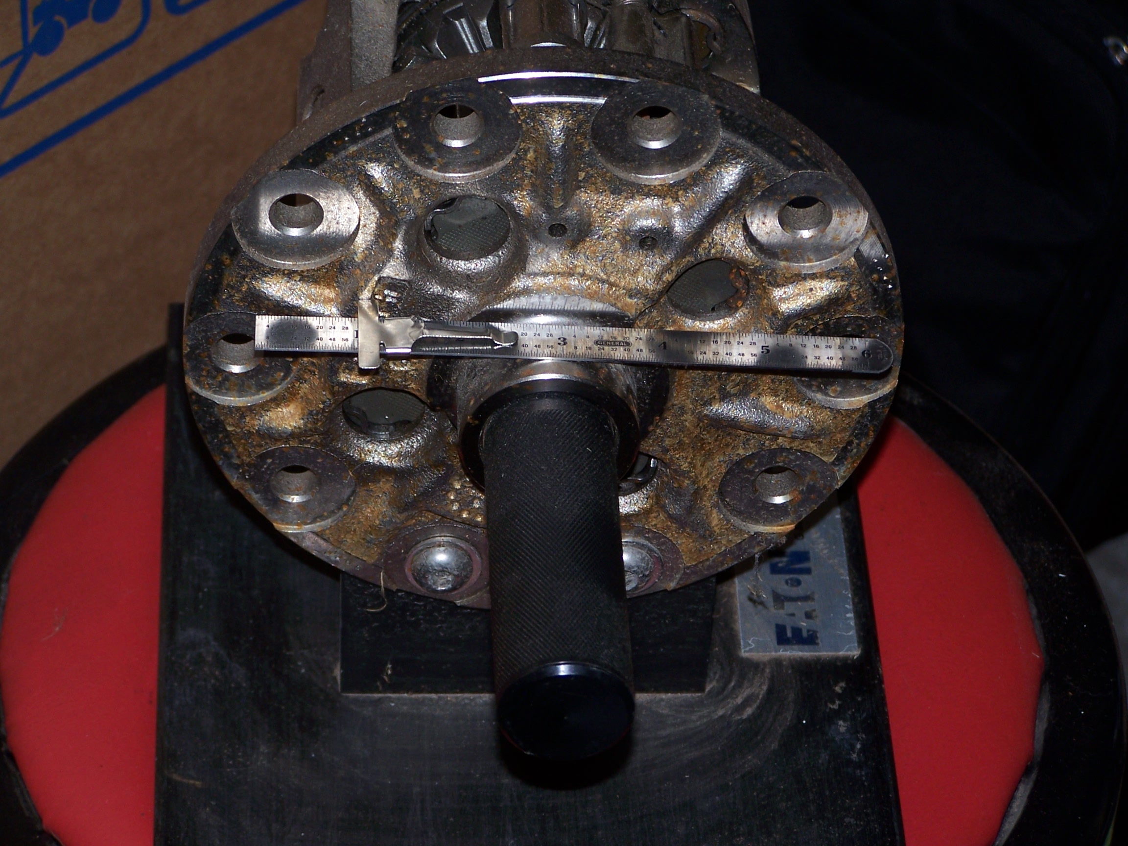

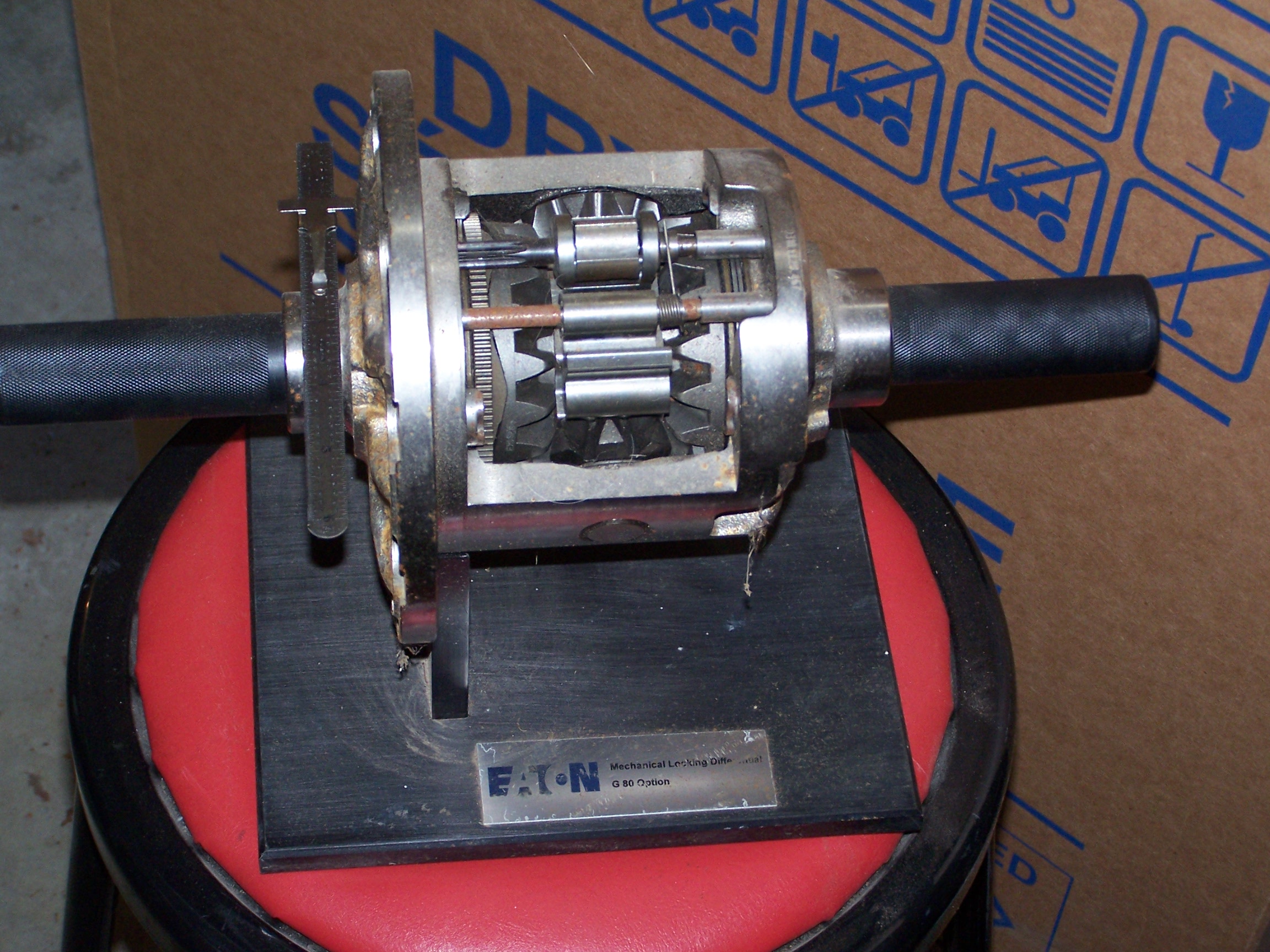

L39Builder said:
Neither of your trucks were equipped with G-80 locking rears.
The G-80 is an 11.5" locking rear developed for the GM HD pickups. Before the G-80 (pre '01) GM had a GM in house 14 bolt rear.
Much too big for a Blazer or Envoy..... Your Envoy probably has about a 9" rear and your Blazer, if you were lucky, had a 14 bolt, but might have been smaller.
I see where workin has already posted the information that I was going to. Just for some extra info it also currently being used on the Canyon/Colorado.
Also be aware that some vehicles may list a G80 and not be a locker but limited slip. (GTO, Cobalt, and 4500 and up)
Attached are some pictures an Eatons sample unit.
Also, depends on who you ask... positraction was a version of limited slip. If I remember correctly from my last trip to Eaton they said it was limited slip (once again only if I remember correctly as it has been almost 2yrs) but they used a different clutch pack from what other manufactures use (whatever that means). This site seems to verify that it is the same as limited slip. Enjoy The Drive -- A Better Rear End.
Kurt
