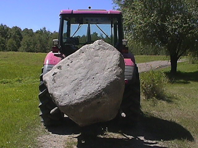

BleedGreen said:
Hello "Z"
First of all, let me say that you are doing a great job preparing for such a major purchase... I have been selling Deere equipment for 15 yrs or so and I wish more of my customers would do the same kind of prep work as you! Obviously from my experience (and screen name :D ) I am "slightly" biased towards Deere - but don't get me wrong, Kubota makes a very good product, and I don't think you could go wrong with either green or orange.
Bleed is making sense. My experience was with 35 years of weekend "farming" using a '48 JD model A. Spent about 2 years kicking the tires looking at newer-safer tractors. I did buy some other things first such as a diesel lawn mower with a cat 0 hitch and a box blade and 6' rake to maintain my road. It is short quick and more maneuverable than a cut or subcut - no roll bar so no low branch clearance issues either.
With the tractor specwise I settled on a JD5105 as the perfect tractor until I drove one on slopes. Way too small & light for my mud bogs & sharp slopes. Remember to add the weight of what it's carrying or pulling to the equation.
I ended up jumping to a JD 6000 or JD 5x2x series. Now the cash expense was giving me heartburn because there was no payback on the horizon.
Found a local Zetor dealer who had a new heavy cabbed 55 PTO MFWD with loader for a little more than the price of the open 5105. Now 3 years old and 214 hours. A happy camper.
