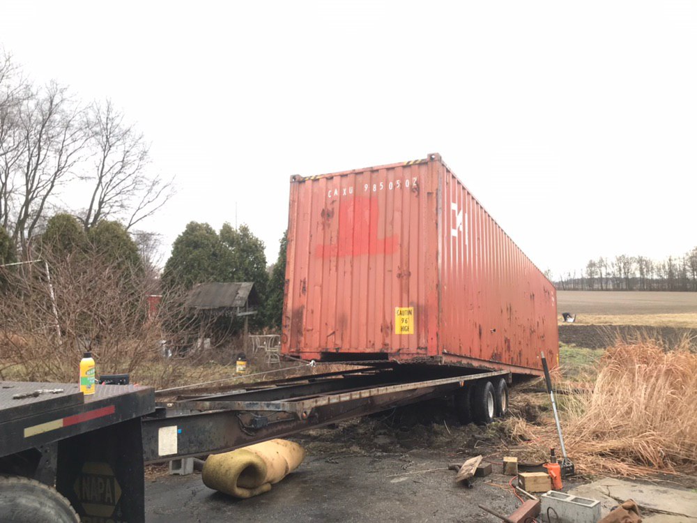

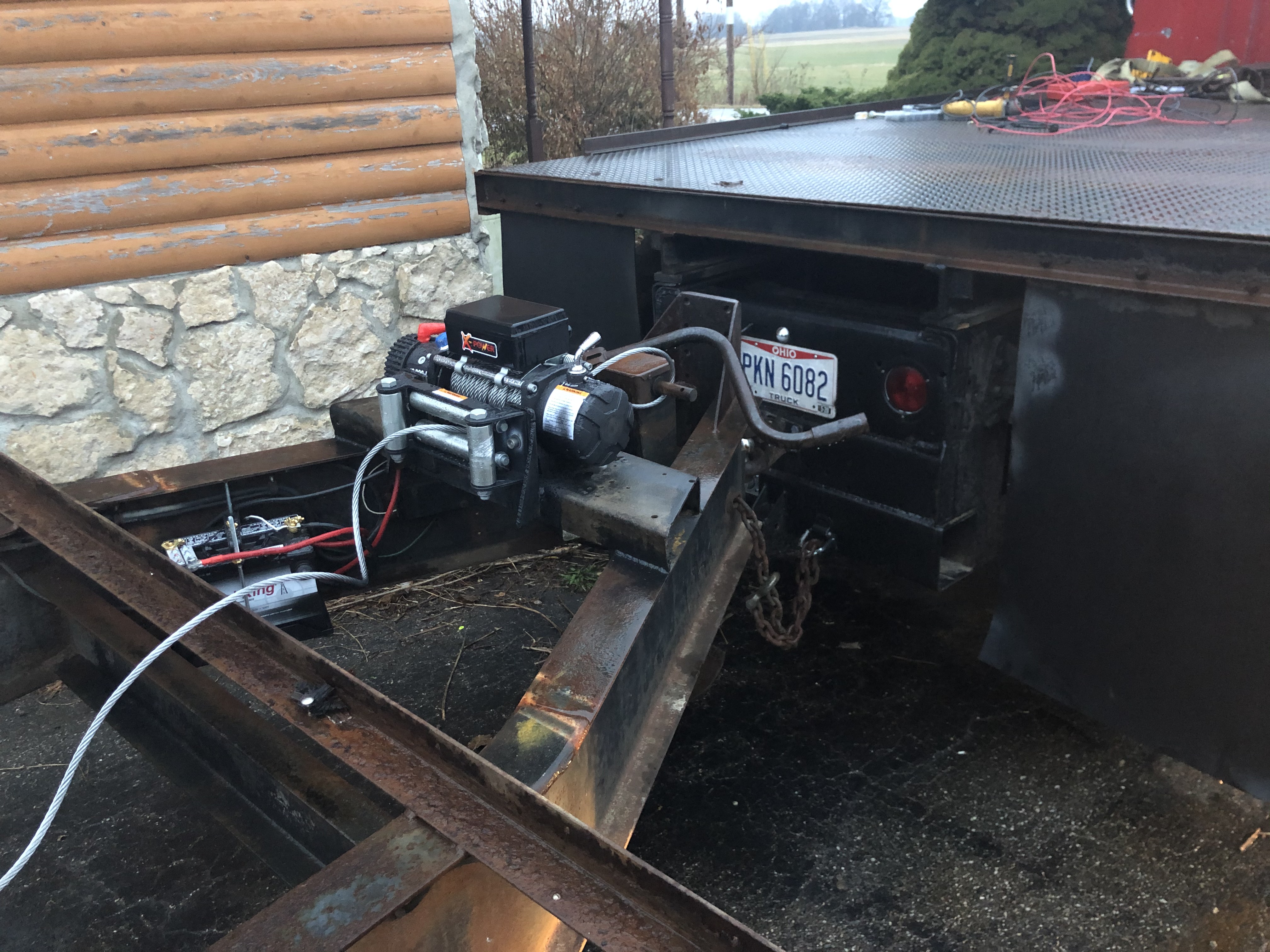

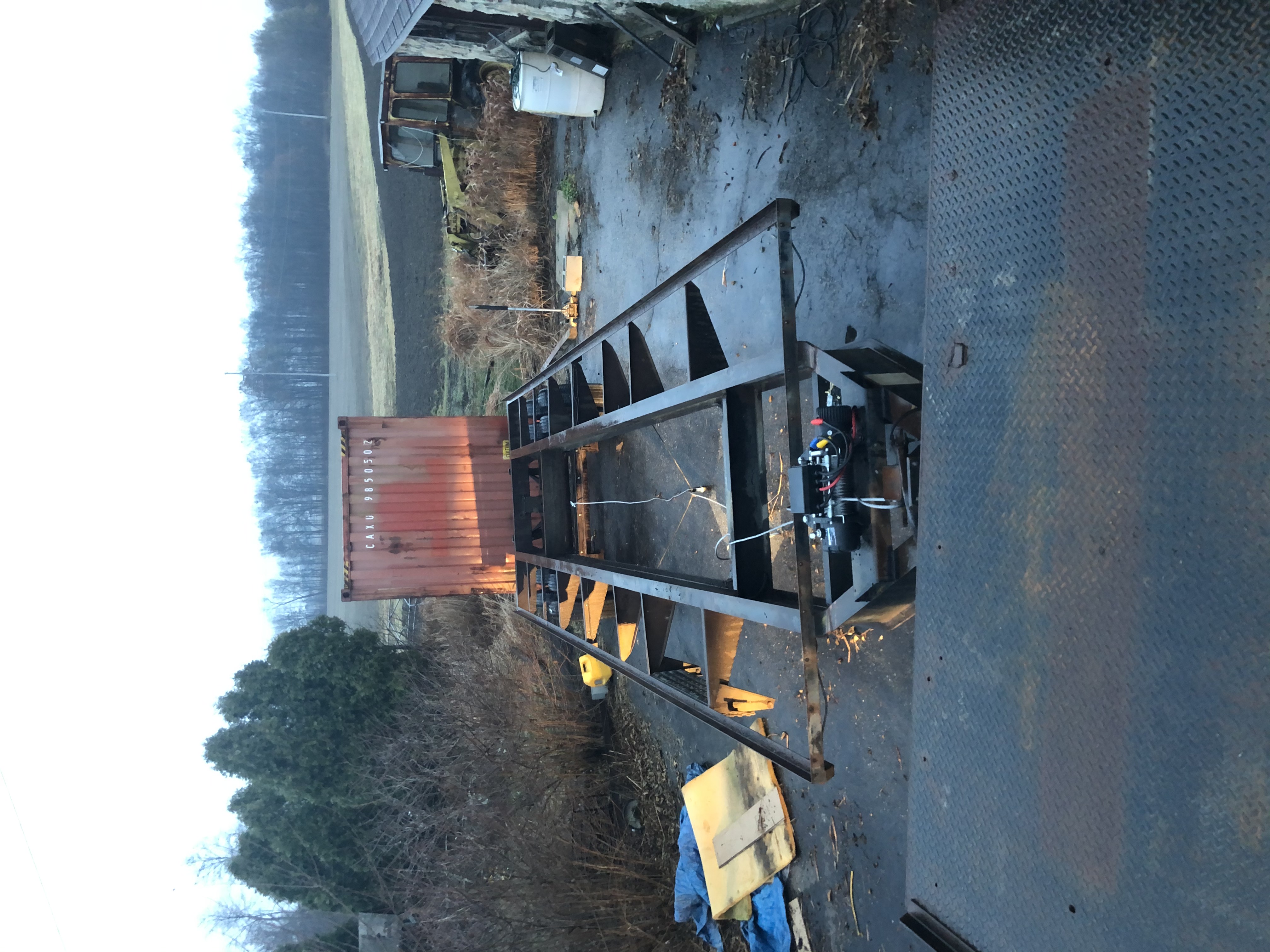

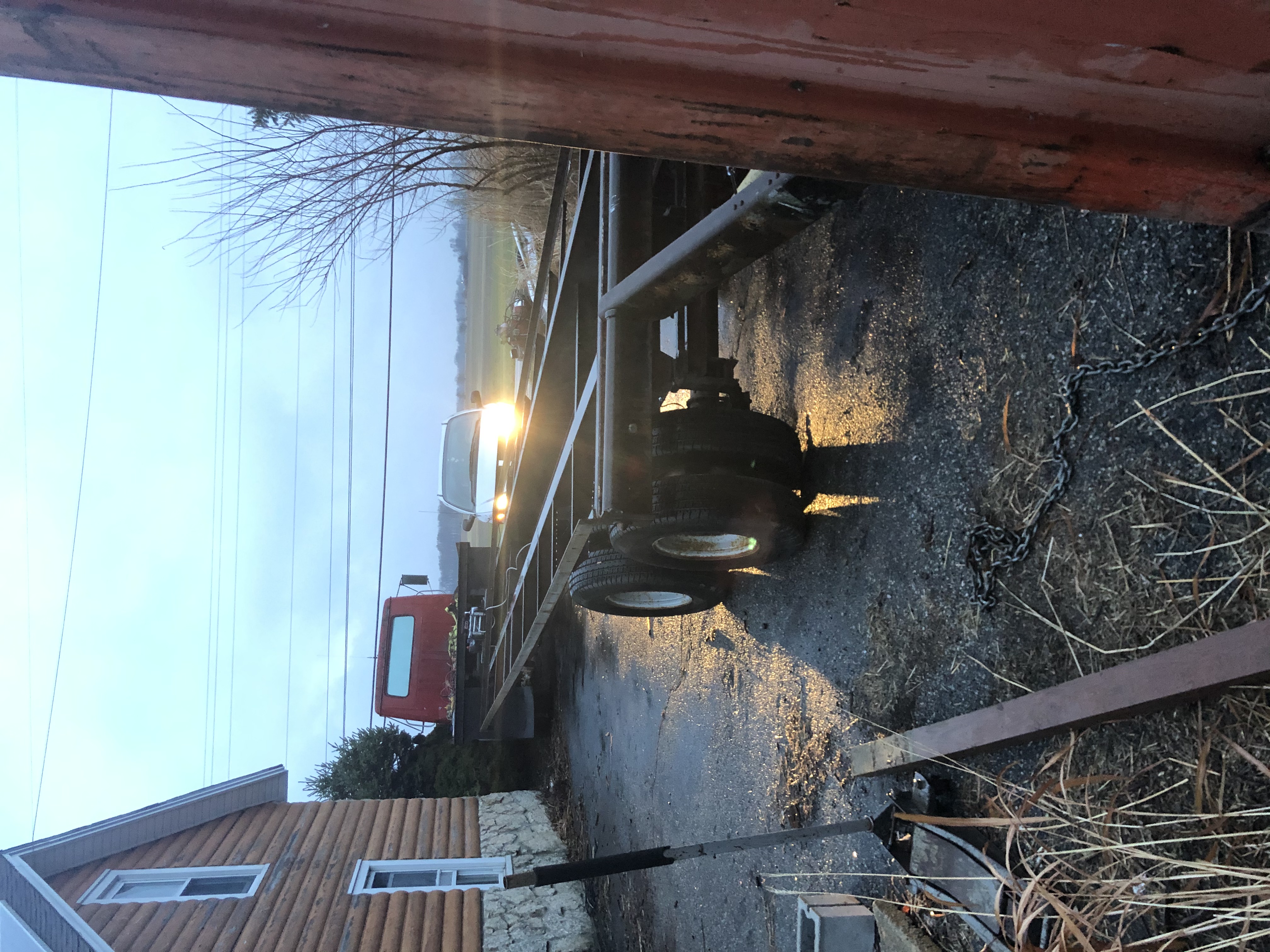

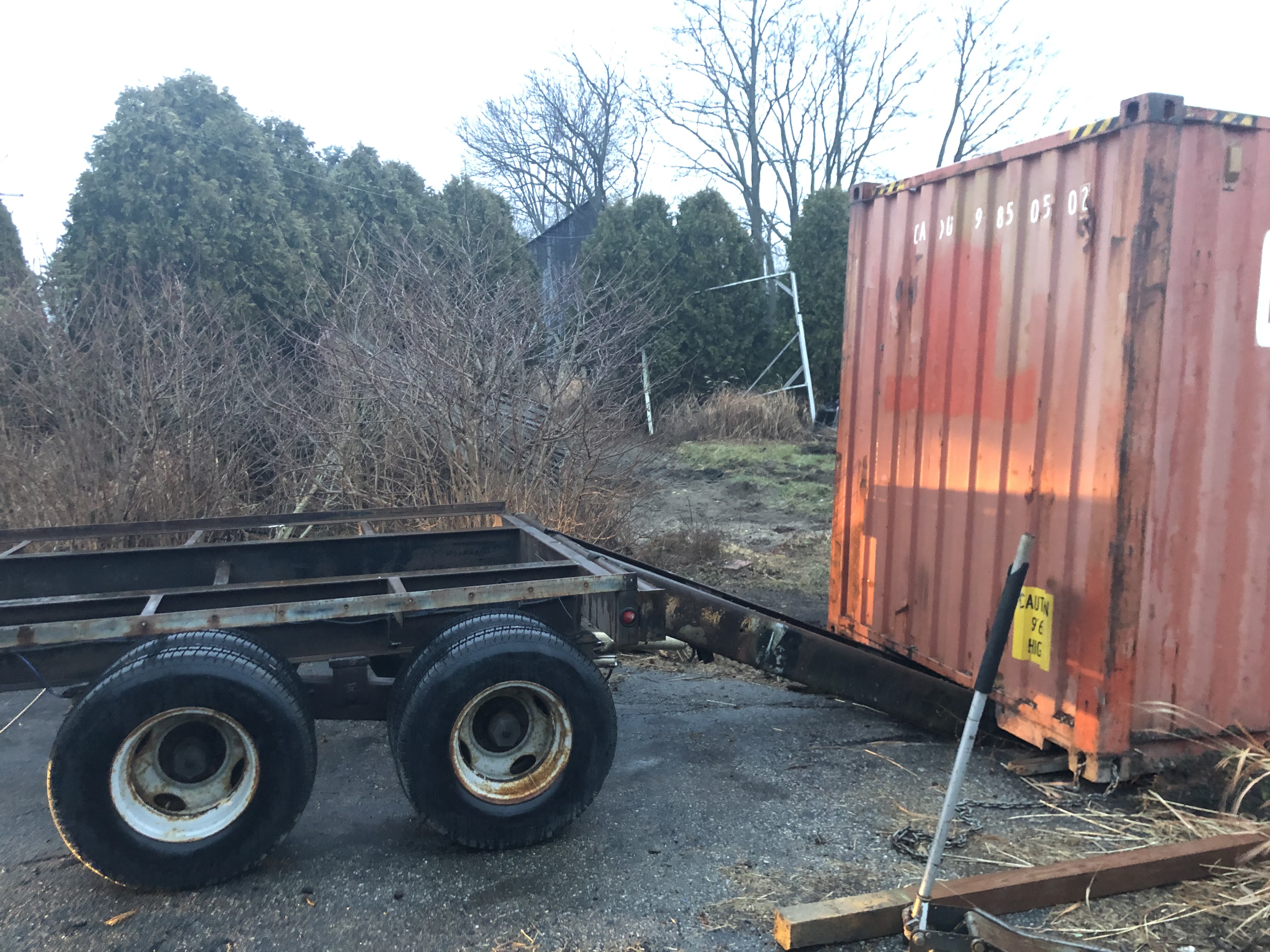

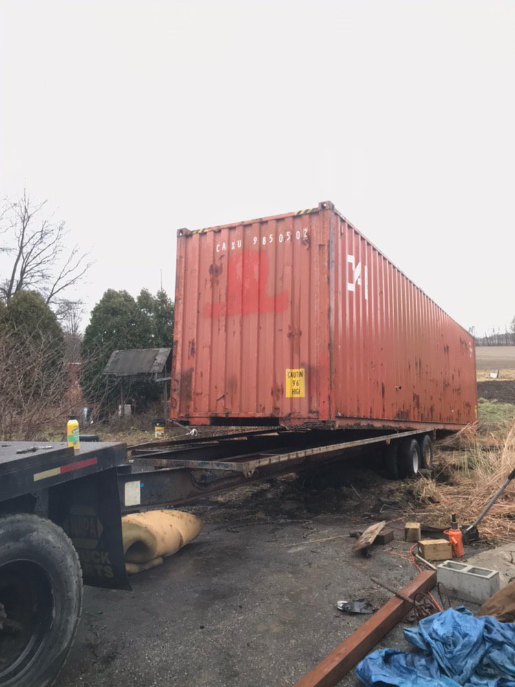

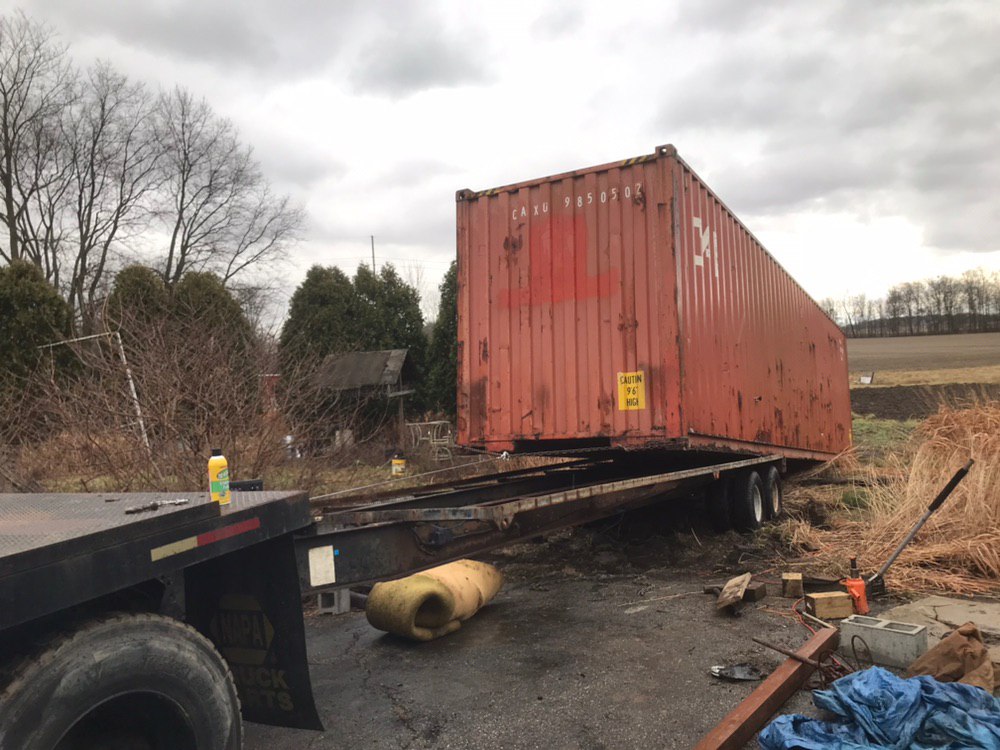

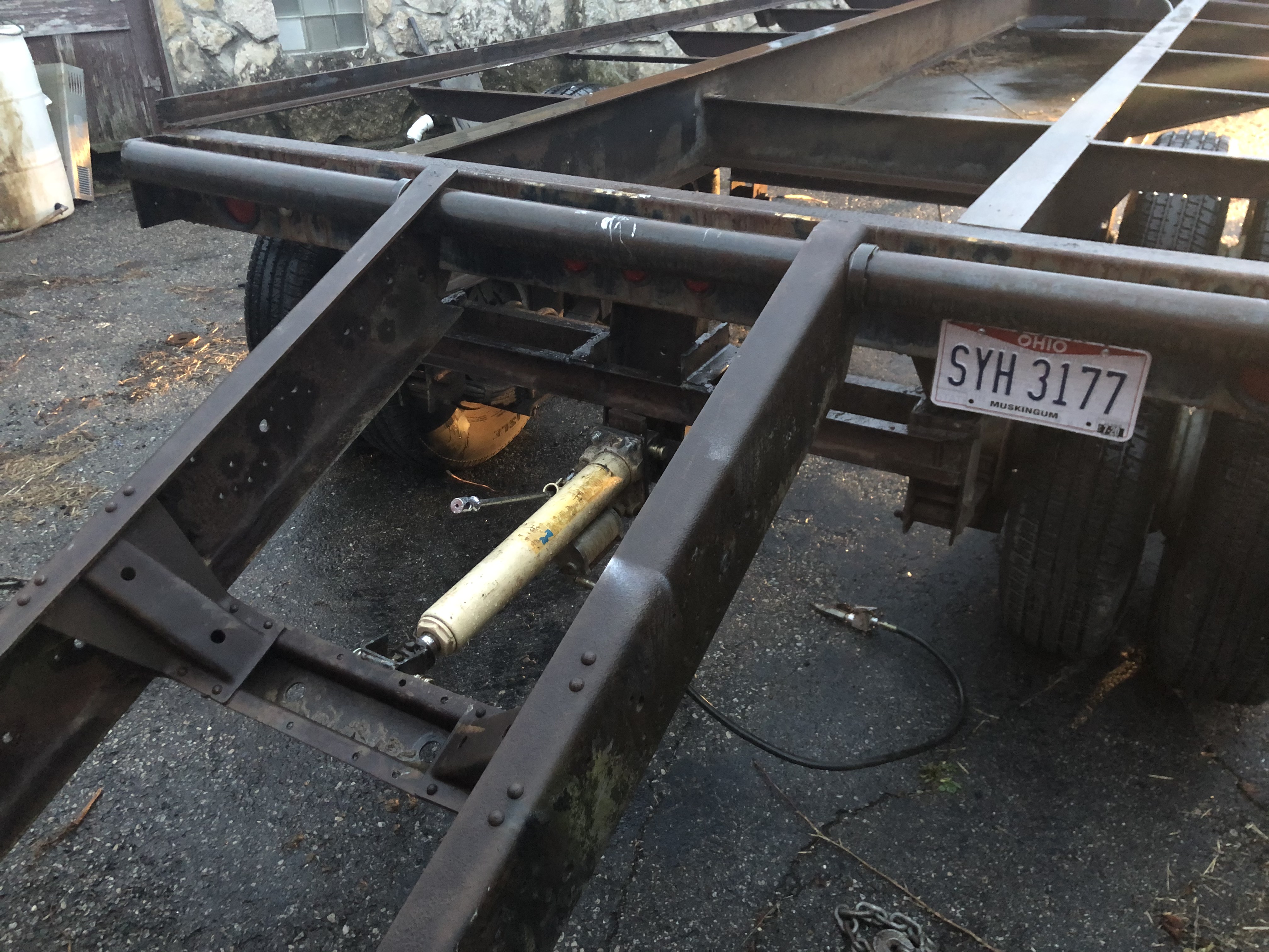

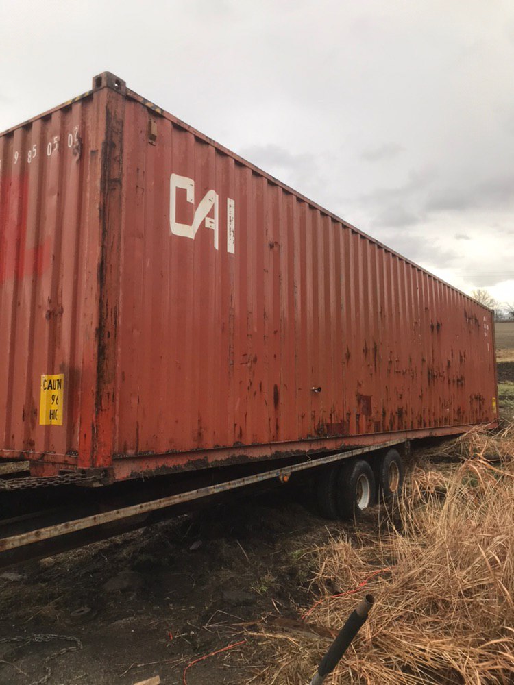

Here's some pics for those interested in this project. The last pic show the "hydraulic dovetail" assembly I added. It is pretty crude right now but works good, it was built with a bunch of random parts I had laying around like the 8 ton air/hydraulic bottle jack and truck frame rails. Eventually I will finish the tail and add 2 proper hydraulic cylinders with electric hyd pump but for now this will suffice. Tomorrow I will finish loading the container and hopefully get it to my property.
   / 40' container trailer axle placement
#27

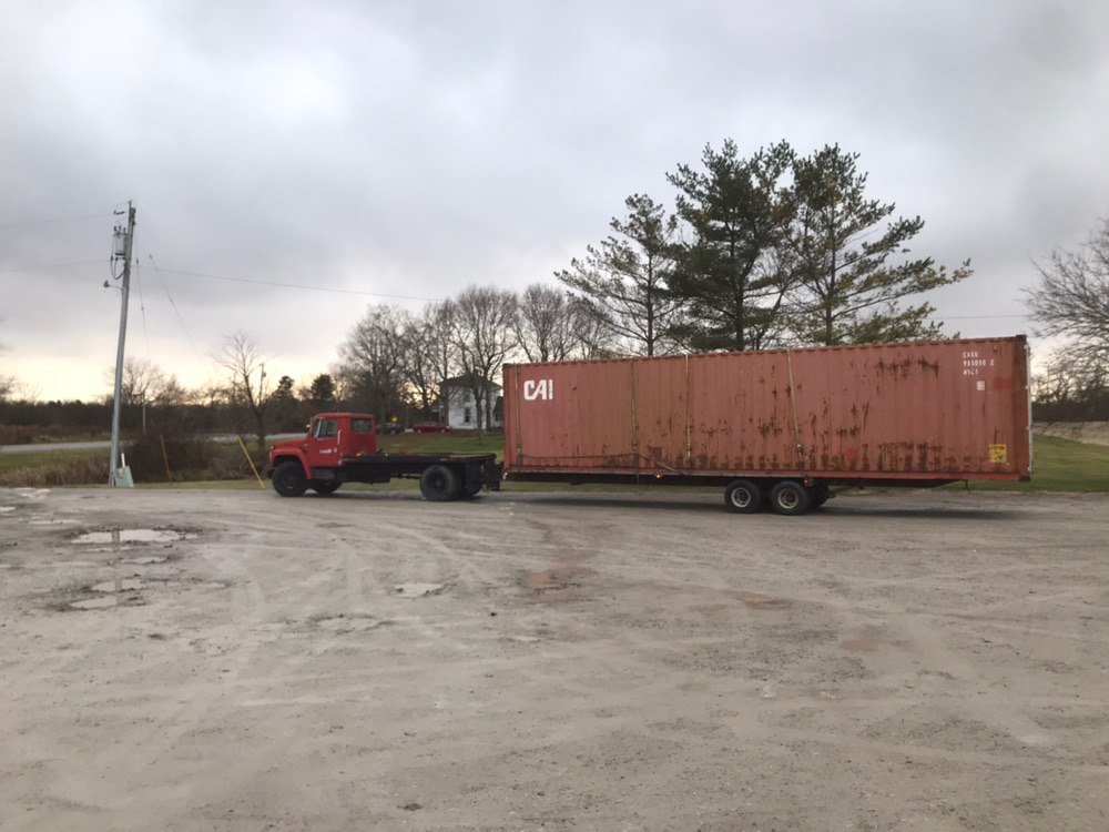

WE FINALLY GOT IT LOADED AND ON THE ROAD!

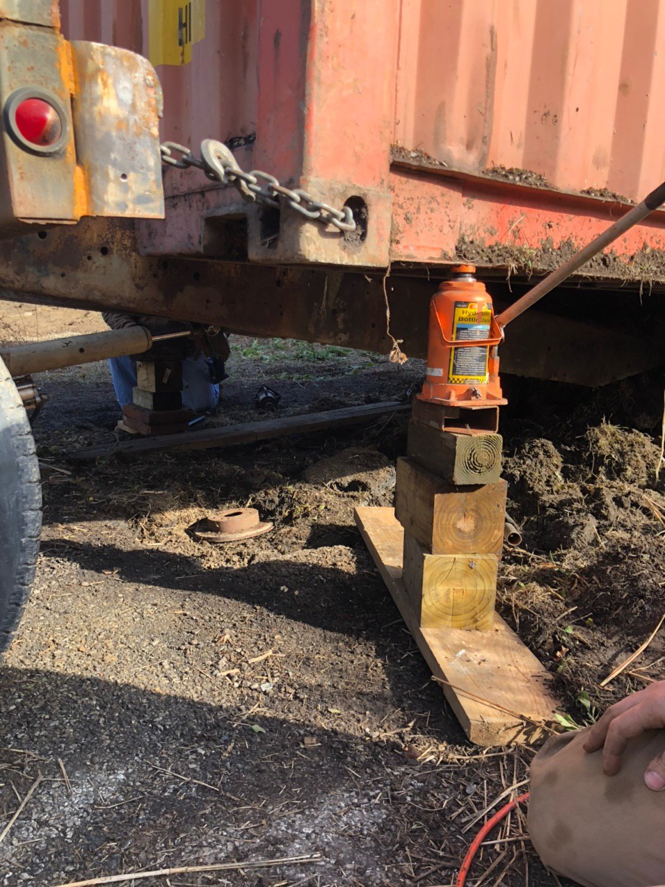

The biggest issue we had was with the hydraulic dovetail. When we tried to let the truck/trailer back under the container while winching, it did not slide nicely along the ground. Instead it started to dig in and eventually went about 16" deep before we realized, and we had to use bottle jacks to lift the container, and jack up the dovetail. To solve this I plan to finish the tail by adding the outside rails, some bracing, a sharper leading edge, and most importantly, about a 12" deep, sided to side piece of 1/8" plate on the bottom of the leading edge so it will slide smoothly on the ground.
Honestly, if the dovetail wasn't a problem, the loading probably would have taken less than 10 minutes. The 12k winch with a snatch block was more than enough to pull the container onto the trailer. Once it finally teetered down onto the trailer, it was smooth sailing. The container fit perfectly between the side rails and slid to the front in just a few minutes of winching.
After this we chained and strapped everything down, gave the whole rig a once-over, and took it down the road. It pulled great with no sway and feels secure and stable. I was even able to get the self-adjusting trailer brakes to actually self adjust by manually braking the trailer in reverse about 80 times. The trailer brakes work amazing now and I took the time to properly set up the P3. I pulled it about 25 miles tonight, highway and country roads both. I am now confident the rig is secure, legal and most importantly safe. I will make some improvement to the tail before moving the next container and look forward to easier loading for the next 2 runs.
Let me know what you guys think!

My winch is not strong enough to pick the container up while also dragging it. We ran into this and even had to jack the container up with bottle jacks to get it to clear the deck. Also the hydraulic dove will make it easy loading other things in the future like tractors, cars, etc.
